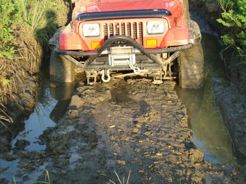

Well everyone always tells me it is way to clean, so I solved that this afternoon. The wife and I went out and found a mud hole with no bottom in it. Got to try out the winch also. I had to call my daughter off her date to go home, get my truck so that I would have something to winch to, there was nothing around us.
Lesson learned, I will never get in mud like that again without the hard top on. Didn't bother me or my wife, but I think it is a little hard on the dash and everything else to have to dig the mud out of it.

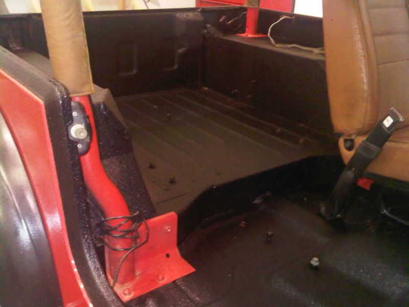

Finally got my Rhino Liner sprayed in. I had a mis-communication with the guy and he did not do the role bars up to the pads like I wanted, but I like it anyway. I did have him spray it over the edge where doors and hardtop ride.
All pics were taken with Cell Phone, I plan on getting some better ones when I get a chance.

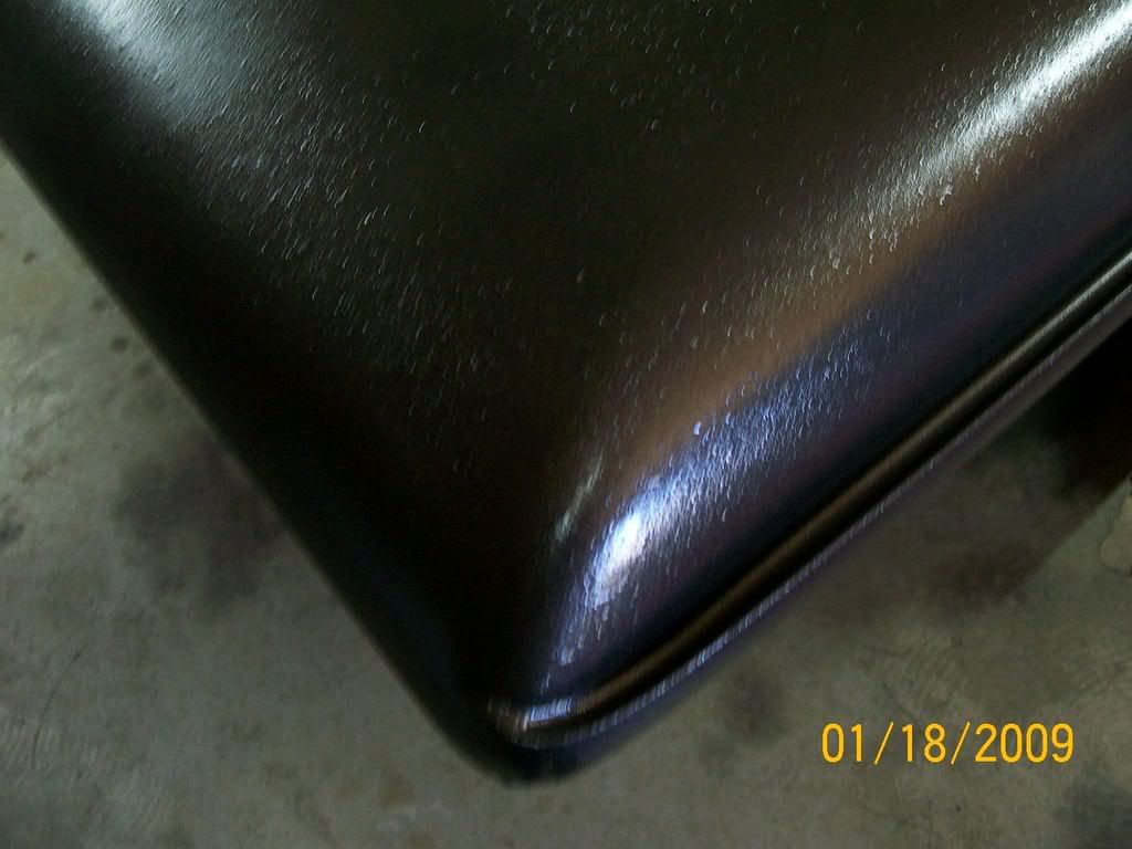

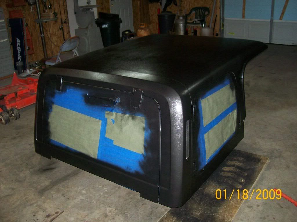

Process for painting hard top:
My top was in pretty good shape, it was just the wrong color for my liking.
I used the green scotch brite pads that can be purchased at Wal-Mart and scrubbed the top really good, roughing it up so the paint would adhere well. I blew all the dust off with air. Then I cleaned it with a degreaser, I think it was simple green and water. I went over it one more time with the scotch brite on any areas I was not happy with and cleaned the top again. Let it dry really well and then I tapped off all the parts that I did not want to get paint on. I cleaned it a final time with just a damp rag of simple green and water to remove any possible finger grease etc that I may have gotten on it.
I used the following paints on it with no primer, the Hammered Rustoleum does not require primer. (I am not a painter, so I don't know if it would be preferred to use primer or not).
I applied about 4 coats of the black allowing it to dry between coats and then applied two coats of the clear coat to seal it.
This has almost been two years now and it has held up very well. Besides it will not be hard to touch up when the time comes.
I know my build thread is a little out of sequence but I am not the best at taking pics or updating this thing. It sort of just happens when it happens.
Sloppy, this isn't much to go off of but maybe it helps a little. Oh yeah, the spray nozzle for the rattle cans is a must, your fingers will fall off if you don't get one.

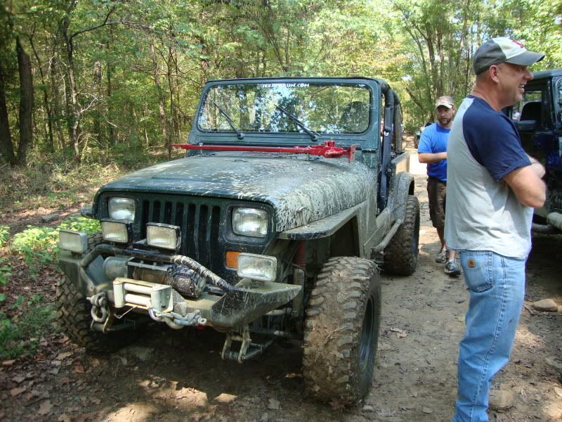

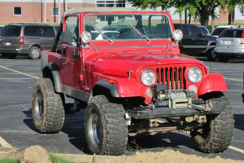

Jeep Pics taken today at work, 3 different generations of Jeeps, TJ, YJ, CJ. We are going to start having a monthly jeep day where everyone I work with that have jeeps drive them in and line them up (any model). I will update when we do it, I think there will be possibly up to 10 or so.
