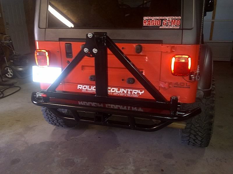

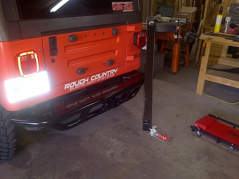

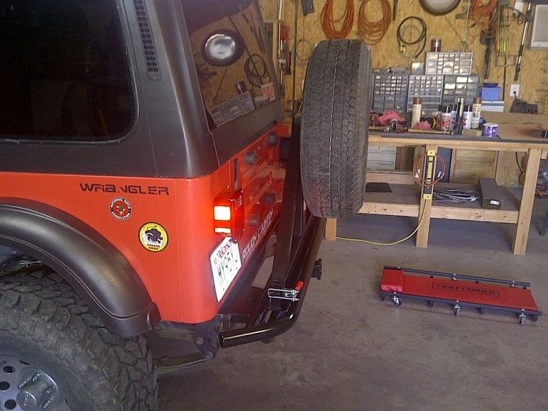

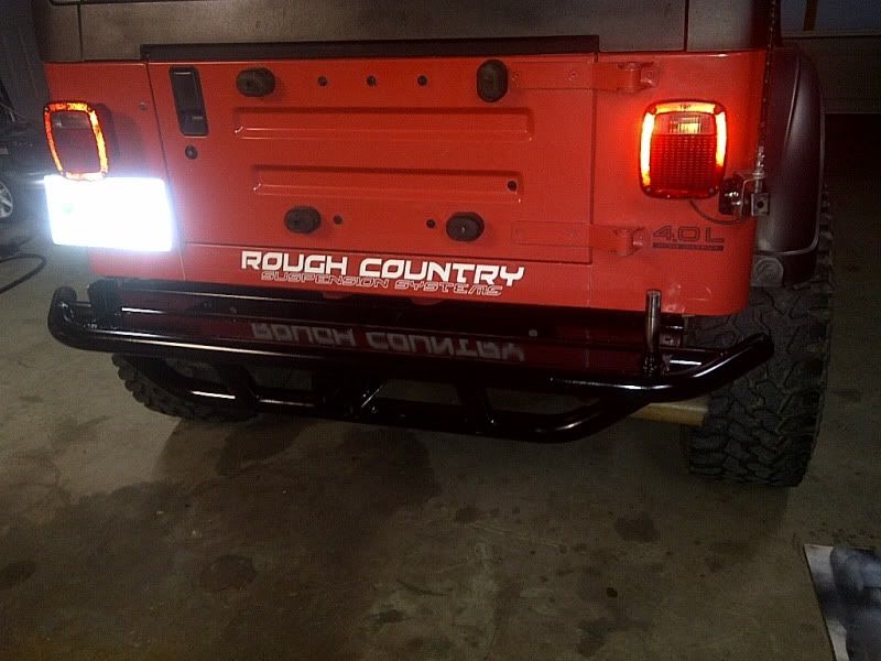

Pics of Tire Carrier
Bumper, I re painted it to match.. I had the guy weld in a plate across the top so that when Hank jumps in and out of the back he won't stick his foot between the pipes and break a leg. It was an accident waiting to happen..

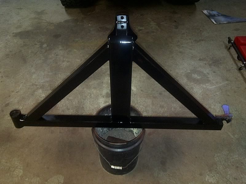

Here is the carrier while it dries...
I will post some when I get it all put together also....
Fab work done by Rock Solid Fabrication in Van Buren Arkansas. He will ship or meet within a 100 miles or so if you pay for his gas. Does a great job, does custom bumpers, flat fenders, sliders and more. Has CNC machine so he can custom it up pretty good if interested.. PM me for his number..

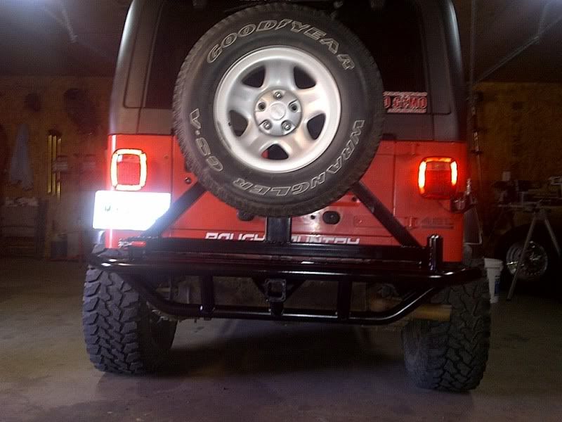

More Tire Carrier Pics, spare tire is off my daughters old spare from her stock tires.. It is a little small.
I think I have room behind it for jerry cans and other items later on.

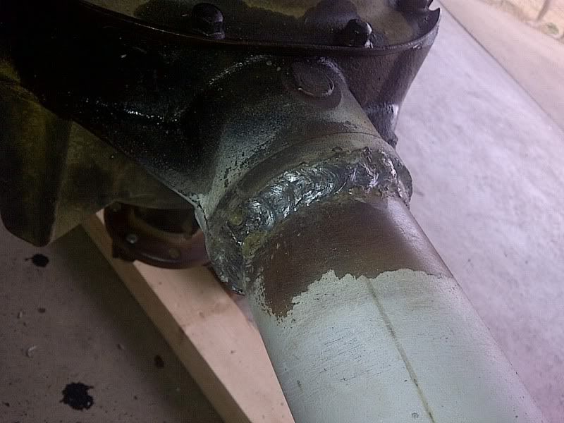

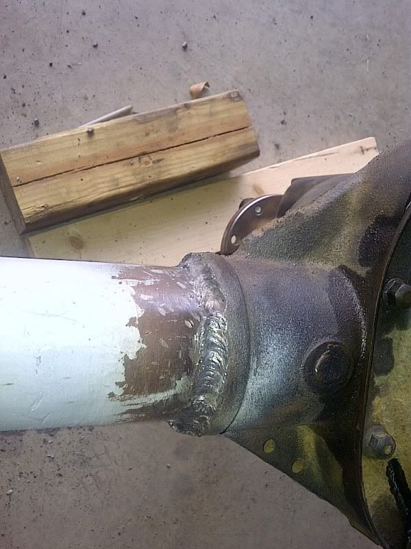

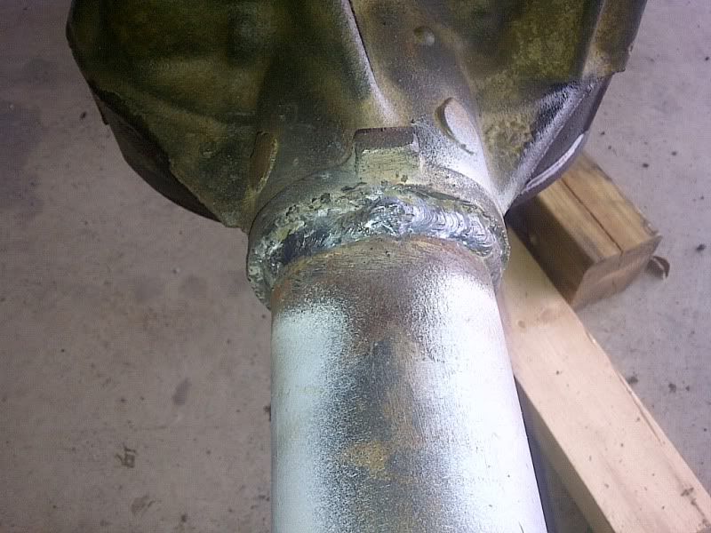

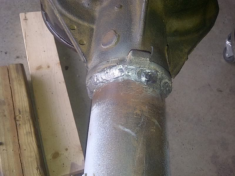

Well I got up the nerve today to weld my 8.8 Axle tubes in place.. Doesn't look to bad, not really great either but I think it did the job. No cracked welds and I believe I was getting good penetration so it should be strong enough.
Done with a Lincoln Cracker Box 225 AC welder and 7018 Rods, and I did post heat some with a Map Gas torch..

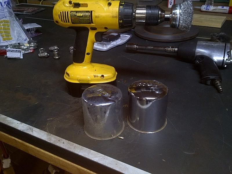

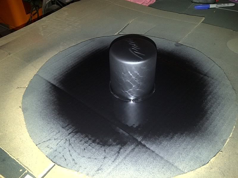

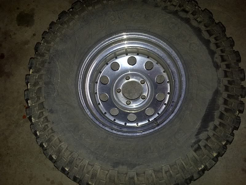

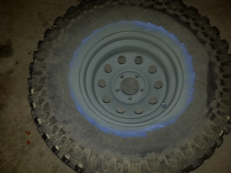

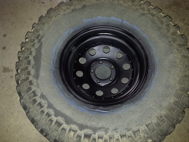

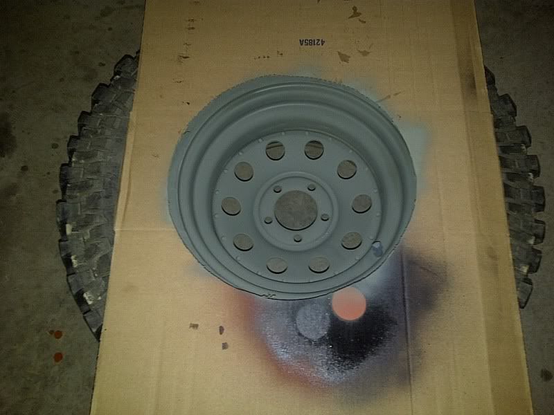

So in the mean time I decided to tackle something I have been wanting to do for a while but was unsure of how it might turn out.. Painting my chrome wheels. I hate chrome so this afternoon I started on them. I roughed them up a little with a wire brush on my drill and then primered them with self etching primer, 2 coats. Then painted them with rustoleum flat black paint. Only got the front wheels done tonight but should finish the rest tomorrow.
Looks good but not sure how well the paint actually bonded to the wheel.
Before I started..
One center cap cleaned and one not..
Self Etching Primer
Black Paint applied
More pics to come tomorrow and after wheels are back on heep to see final results.
