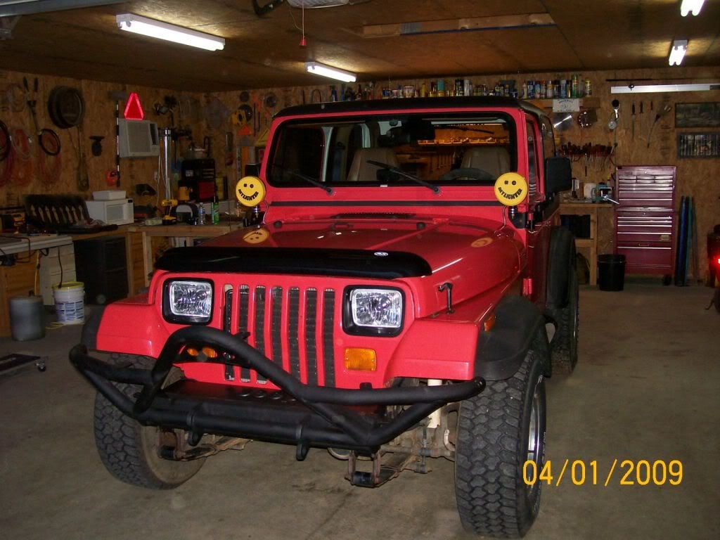

Wahooooo I found bumpers today that I liked and got a great deal on them also.
I have installed 2 130Watt day lighters on the windshield and also installed my front and rear bumpers, replaced a broken taillight, finished my LED dash lights, installed a 6 speaker sound bar and replaced my dim headlights with bright ones.
Funds are drained, but I feel the 3 to 4" susp lift, 1" BL, boom shackles and 33 X 12.50's next.
I will be leaving on a 6 month deployment this summer and hopefully can save the money then for all of the above. Like I said - slooooow build
New Bumpers
Hank Approves of his Ride
Also want to add FOG lights on bumper soon.
New Rear Bumper
The yellow lite covers are going, I ordered the black rock guards for them.
Let me know what you think ...

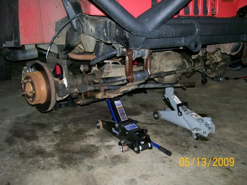

When I first started working on it. It got new brakes all the way around, to include rotors, calipers, wheel cylinders, pads, shoes. It also got all fluid changed, filters, serp belt, plugs, plugwires, rotor bug, dist cap.
Rattle canned the hard top with Rustoleum Hammered Black. I must say it has held up well so far and I like the hammered look.
Built a homemade hard top lift in my shed for less then $100 that includes the hand winch. Works Great
Next came the 4" RC lift..
SS front brake lines
After Lift Installed

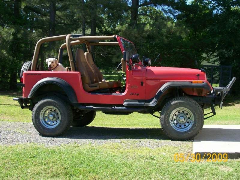

As you might can tell in the pics above, I also ripped all the carpet out. That was a plus as you will see later in this post.
Other mods I haven't mentioned is LED Red dash lights, new 6 speaker sound bar, and a rechargeable LED 4 Cell Mag light mounted beside the drivers seat.
Ok, more pics:

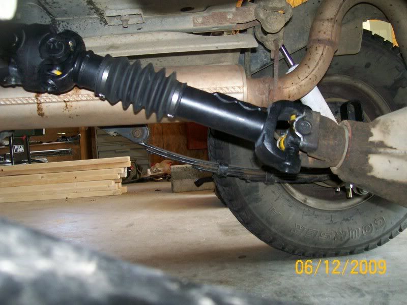

After the lift as most of you have probably read, I have had a huge problem with vibes.. Which has led to this: The install of a SYE and CC/DS
As you can tell from above I still have the wrong angles and a small vibe.. Plan now is to replace the 6* shims that came with the RC lift with 10* shims... According to Mr. Tom Woods and his wisdom that is what I need to correct my problem. This is a temp fix until I can get new axles and 4.10 gears installed. Then I will reweld the spring perches to fit properly.
I also installed 1" Brandon YJ booms.
Next I took it out wheelin this weekend, and this is the reason I am glad that I pulled the carpet out.. I dove off in a creek that I had been in several times before and now with 5" of lift, I thought no problem. But I didn't take into count the rain we have had lately. The creek was up and water filled the floor board and I thought was going to go over the hood and swamp the motor. It couldn't have been to far from the breather intake.
More wheelin pics
And that is pretty much where I am at, waiting on the 10* shims to show up. This will probably be the end of my build for awhile, at least until I get back from a deployment in about Feb 10.
