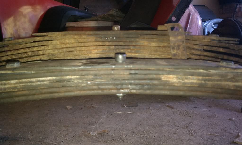

Here is a pic of my hybrid Waggy/YJ pack (front of pic) and a stock Waggy pack (rear of pic). I wanted to keep this build low, and this hybrid pack seems to be what I wanted to achieve.

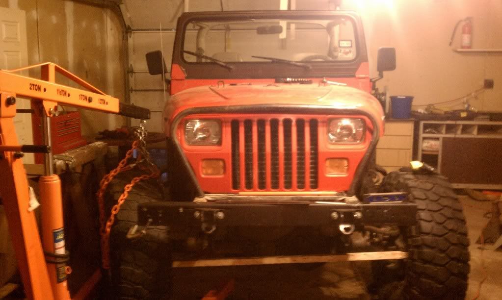

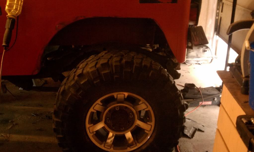

Posts: 196
Back on all fours on roller tires.
Measure the Wheelbase.. 102"
My new Jeep bling
Ugh oh, need to break out the sawzall

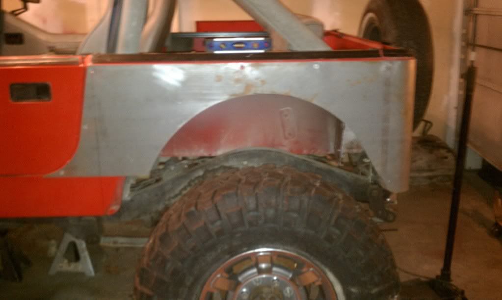

Posts: 196
Just a rough cut. Will get some Genright stretch corners to make it look stock.
Looking like a real Jeep again.
