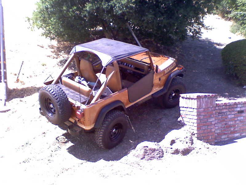

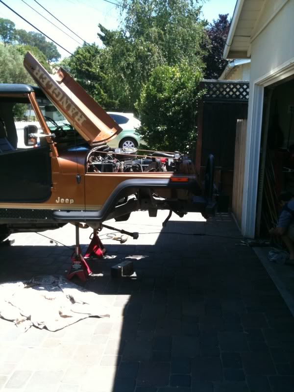

So my Jeep build all started about two years ago i got it right after i got my license. Originally got it for a couple cases of wine. It hadn't ran in 6 years so we were worried at first. Got it home on a tow dolley, and got it started the next day. Had some wires swapped up at the starter solenoid. Ran like ****, hardly idled, then we decided it was time to go with the Howell Throttle body injection, and got those kinks worked out (kinda) since then just been building it. Check it out heres day 1 the pick up

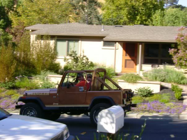

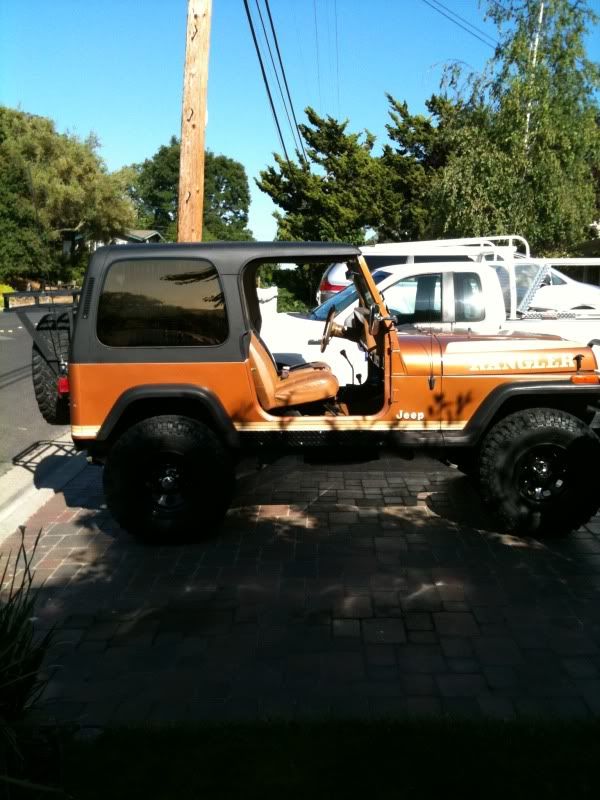

First thing i did was paint the damn top, couldnt stand that hideous brown color, get it running, and clean it up a little, took the top off to get it painted and rolled around with the top off for the day

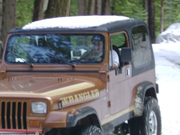

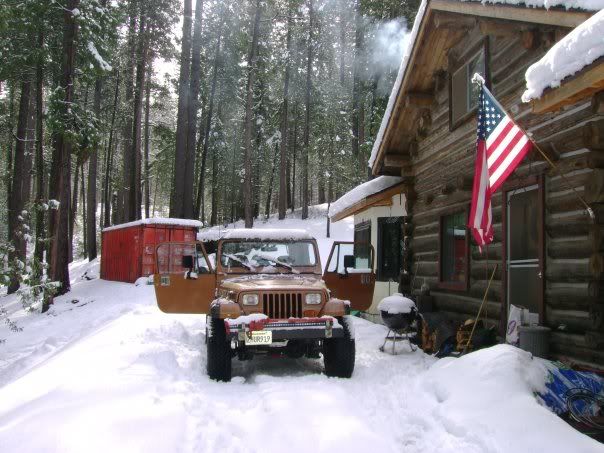

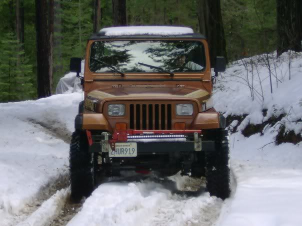

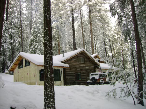

Finally i got to take my jeep up to my cabin for the first time, and luckily we got some snow
took it up again for chirstmas later in the year, and was impressed with its abilities, with the little lunchbox locker and in 2wd i made it all the way up to the top of the ridge without a problem in about a foot of snow

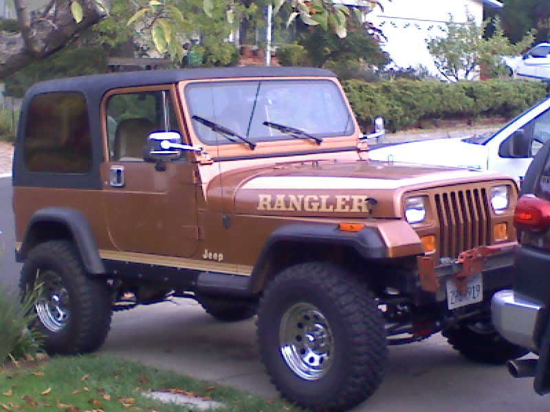

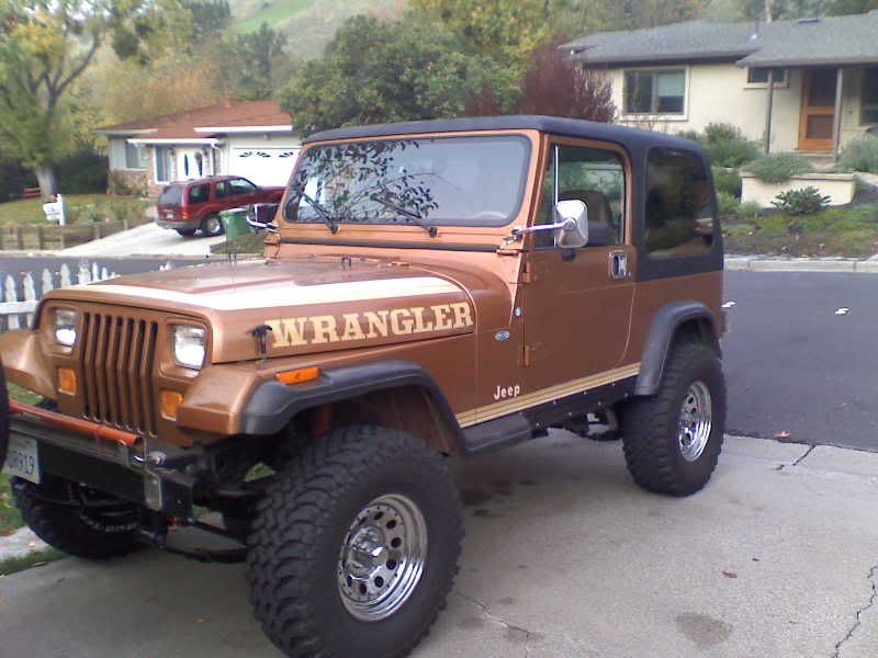

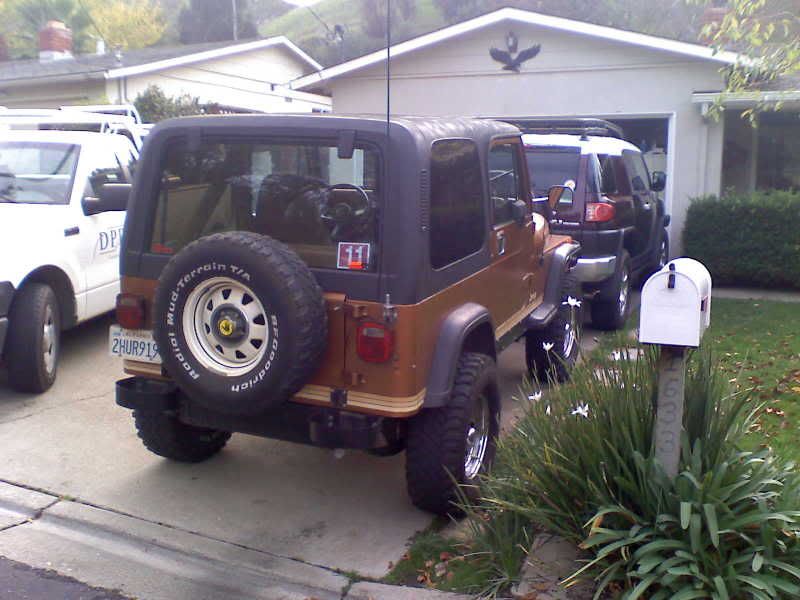

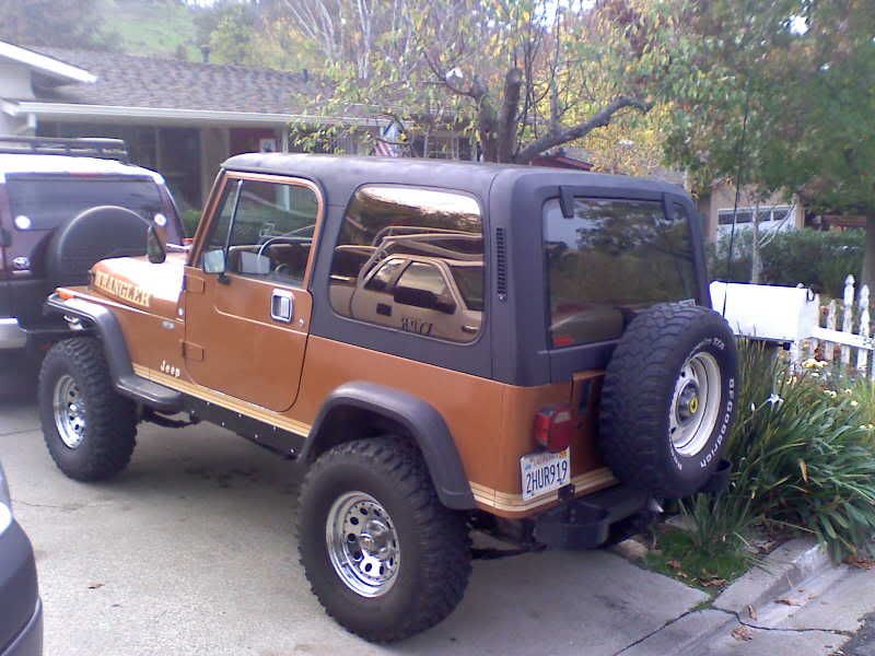

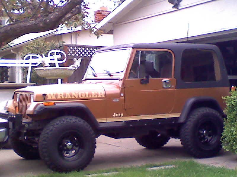

Next i thought it would be appropriate to ditch the chrome 7 inch wheels for some 8 inch black steelies, and toss on some 33's that were on my scout and put the 32's i had on the jeep and put them on my scout, and got rid of the lift shackles, and put in a 4 inch rough country suspension lift

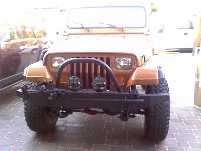

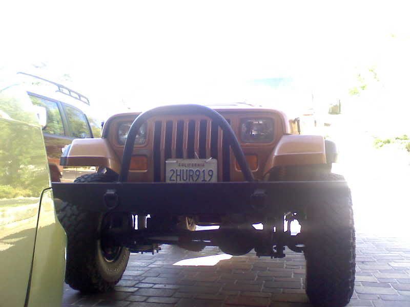

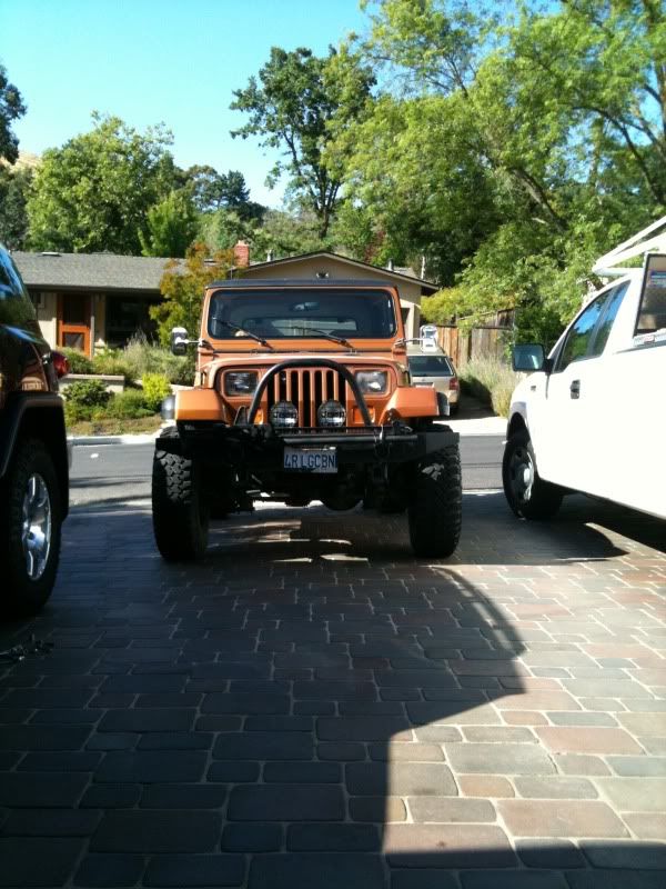

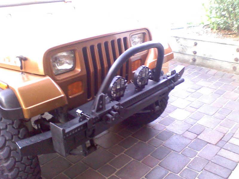

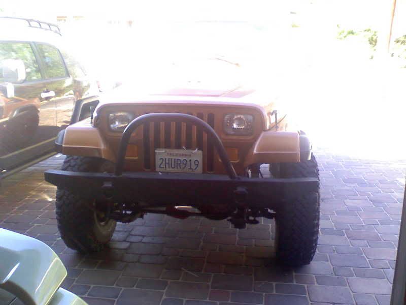

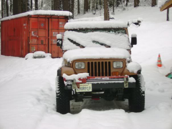

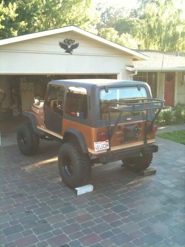

Finally got sick of looking at the stock front bumper on the jeep, and didnt have the money to buy one (considering i was 16). Then i came up with my great idea, when i was 15 i built a nice stinger bumper for my Scout 80. Decided i would steal it from the scout and modify it to make it fit the jeep, so here you have it, my home made bumper with some lights and the hi-lift jack (painted black) all on the front of my jeep

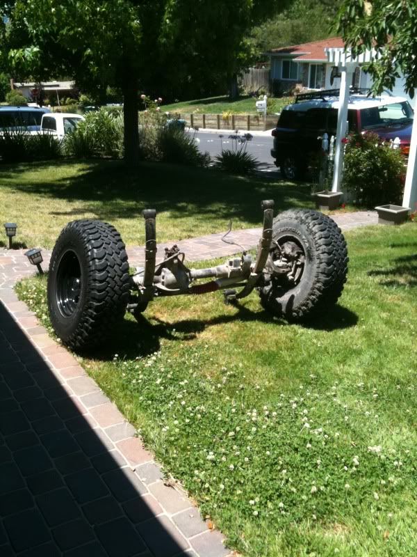

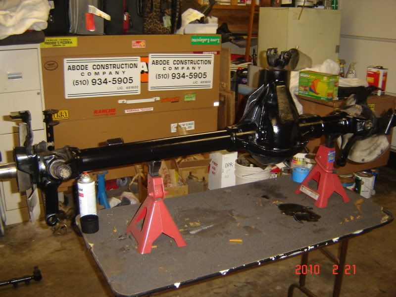

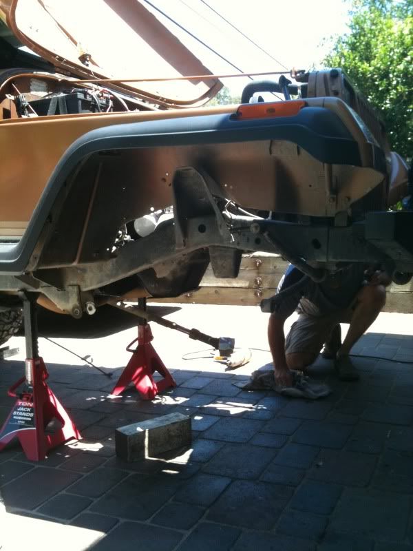

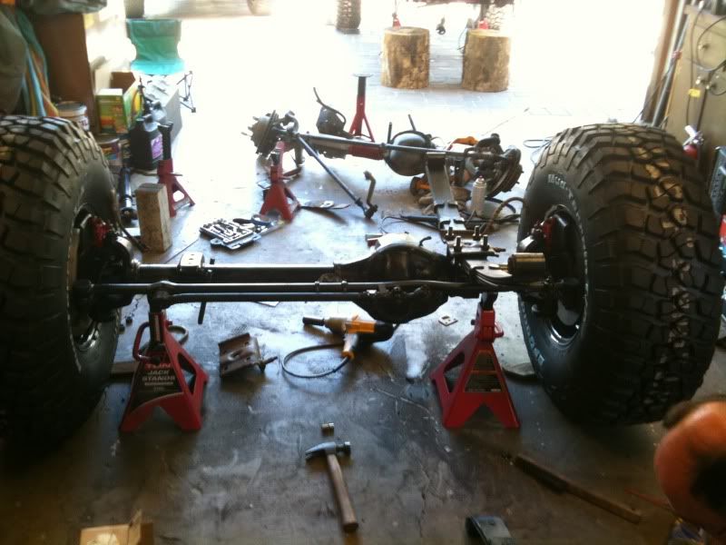

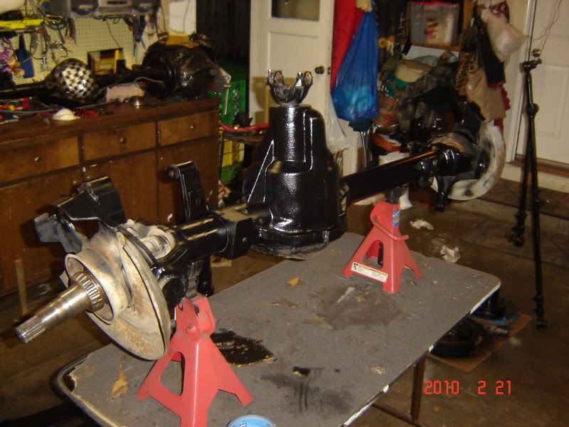

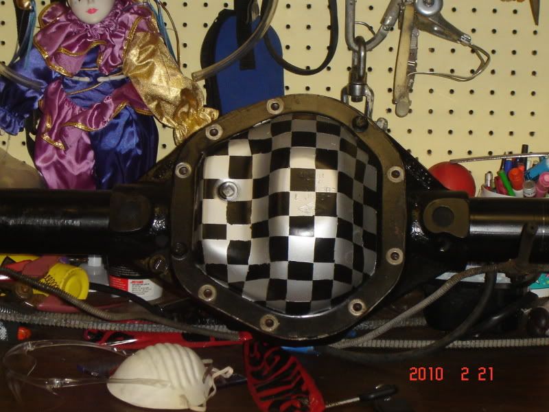

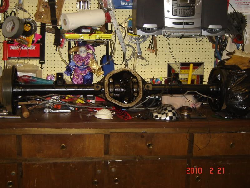

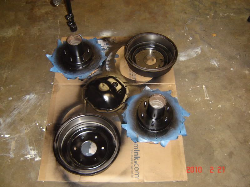

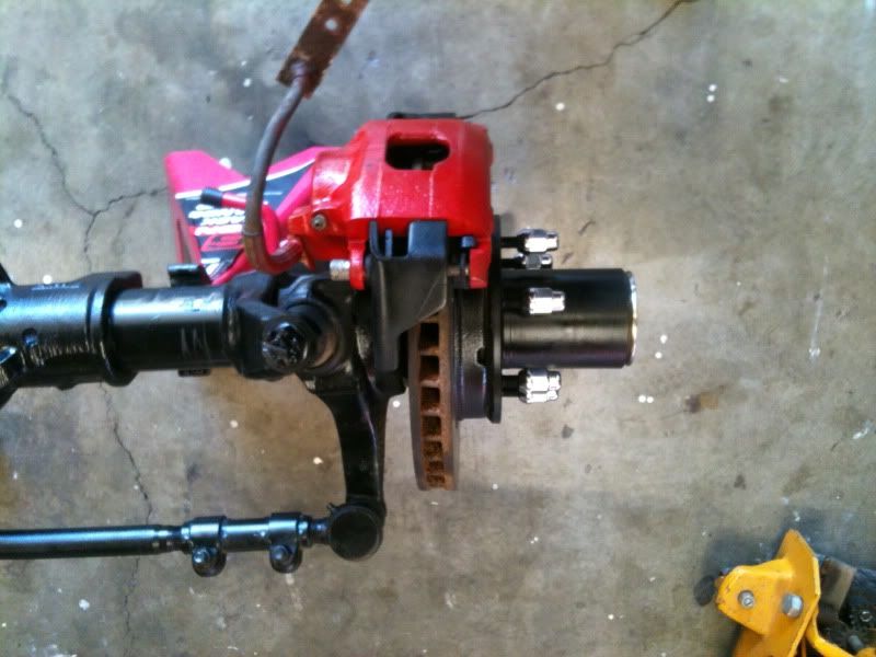

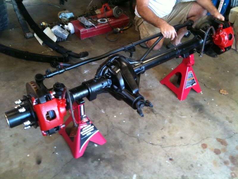

Last summer i got inspired by a local jeep club member to build my rig even more, This made me start fantasizing about an axle swap and going SOA. Thanks to E_rock and histhread ( www.jeepforum.com/forum/f37/waggy-d44-axle-swap-yj-189711/ ) on the grand wagoneer axle swap, he truly inspired me to go front and rear 44's. So as a christmas present my parents bought me a set of axles that i found over craigslist. I rebuilt the front with my fathers help, although i was the one that did all the grinding and cutting removing all the trac bar mounts, all the leaf perches, and turning all the drums and rotors in auto shop, bead blasting my rotors, and then painting them.

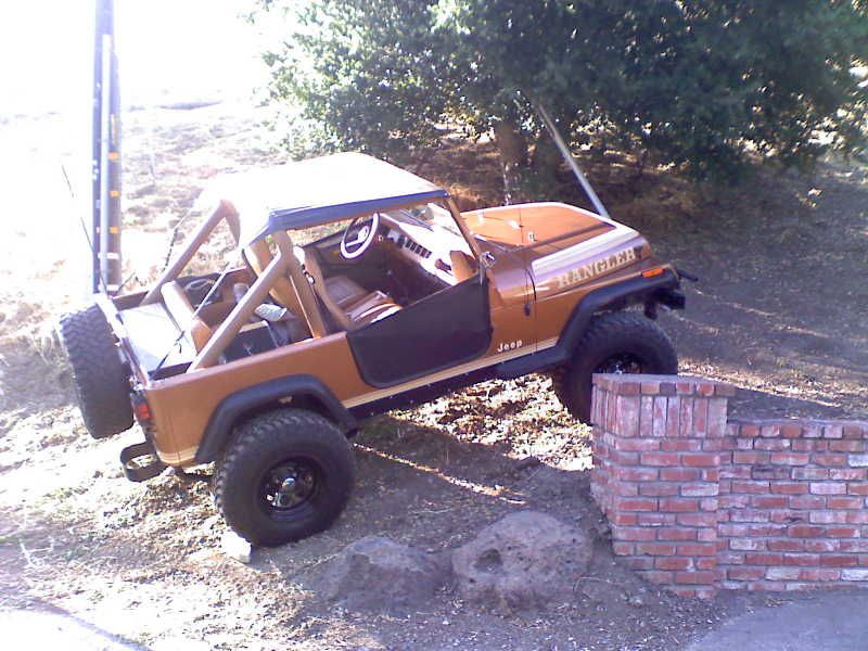

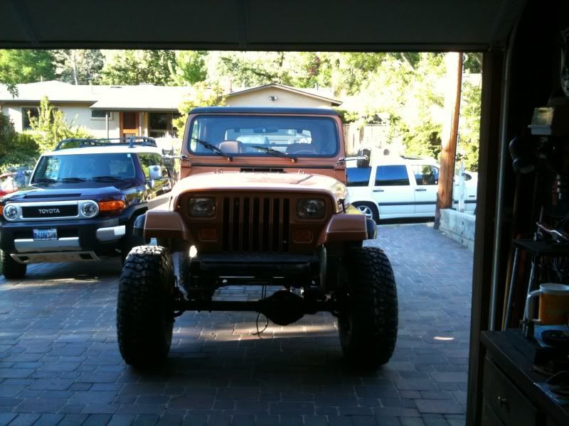

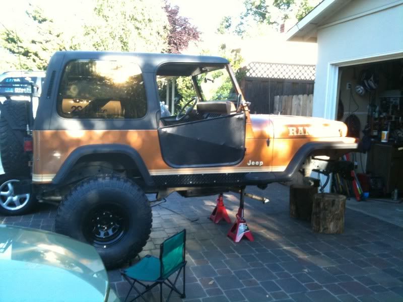

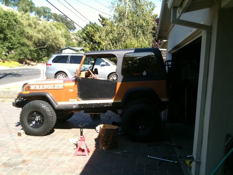

Here's what the jeep looked like just before i swapped in the axles

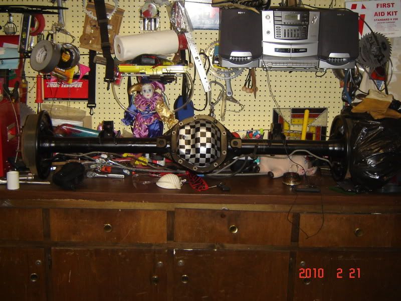

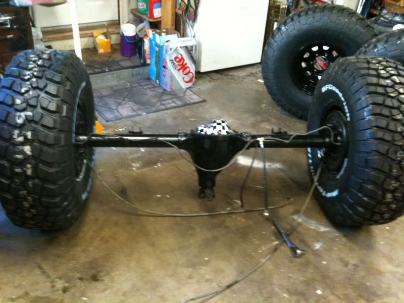

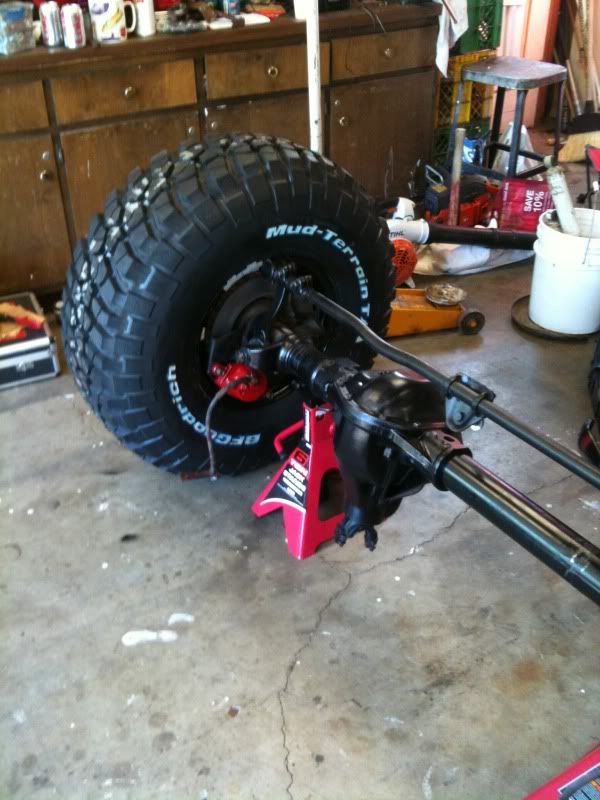

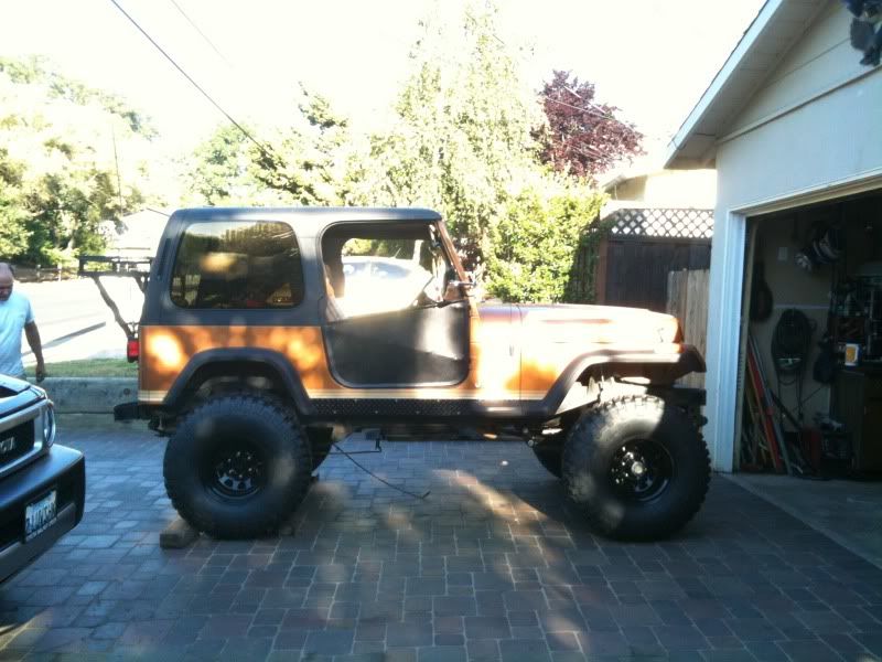

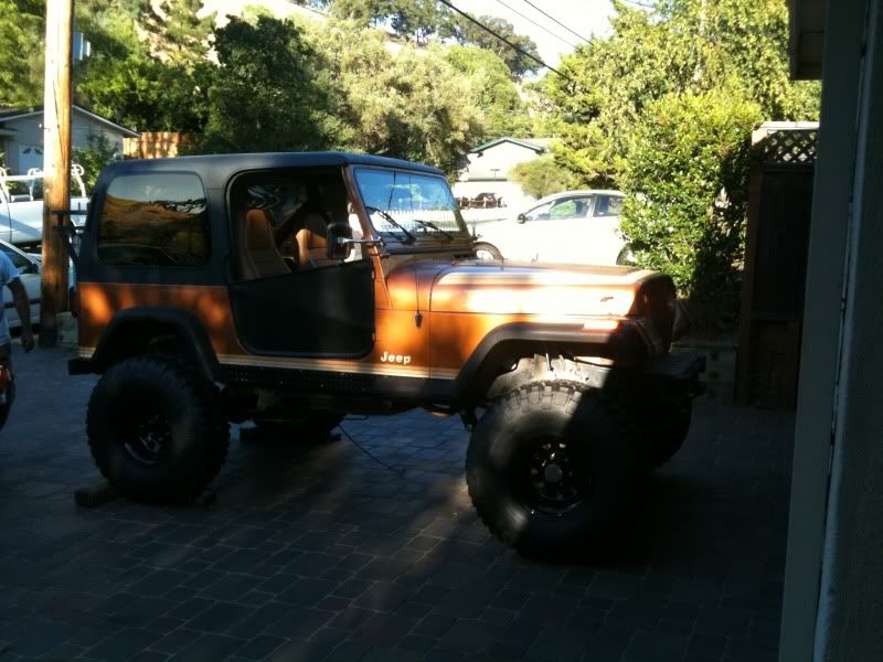

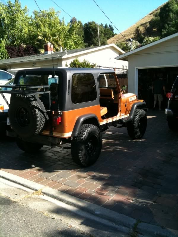

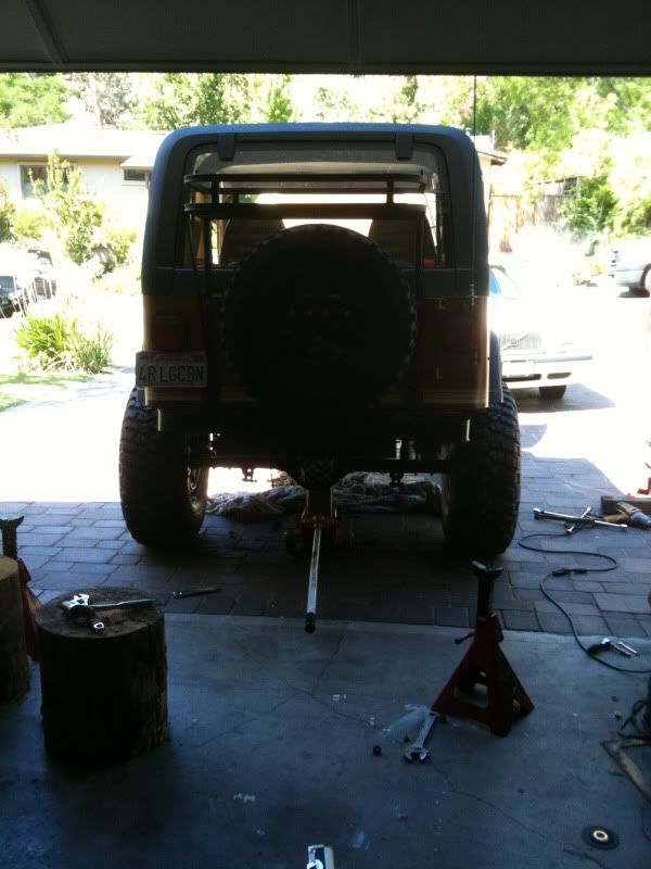

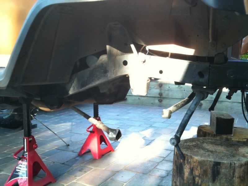

Next on the list was getting them actually under the jeep. This took me a total of about 6 work days, it was alot of work, but here are the pictures of the rear end

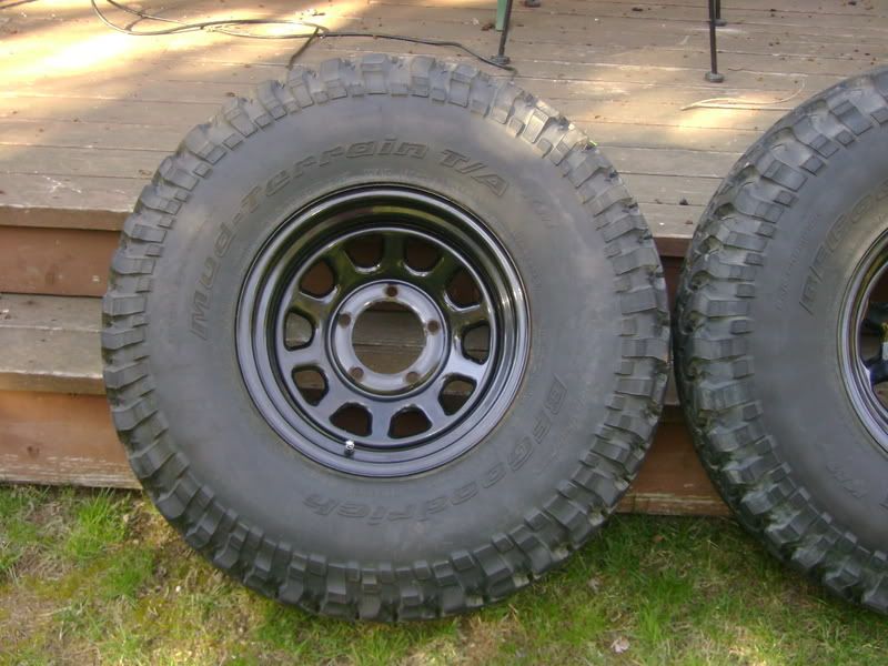

Got a set of some 35 BFG KM2's for my graduation present, mounted on some 6 lug steelies (to fit the 44's from the grand wagoneer), 10 inch rims, 4 inch backspacing, wanted to go with a deep dish rim to make up for the couple inches lost in the width of the rear axle, although the front axle is actually wider than the stock YJ 30 as you will see later
Those 35's sure do make that 44 look small
Now if you look closely at the above two pictures you can see the difference in the lift height, first i put in the whole 7 leave wagoneer spring pack, which with SOA and the lift from the spring pack gave it about a 9 inch lift which was a bit to high for me, so i took out the bottom three springs, and it sat there nicely for a couple days then it began to settle, so then i put the 5th leaf back in the spring pack and bolted it up, today i found out its quite a stiff ride now, so if you are considering doing this, and using grand wagoneer front springs in the rear, there is your warning
and finally the view from the side not sure if this is before or after the spring pack was adjusted though

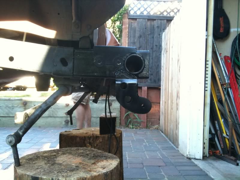

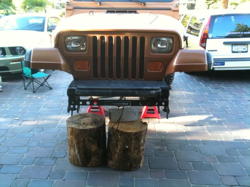

Now the start to the front end, I purchased a warrior "shackle reversal system" of some guy on craigslist, incase you don't know what this is, basically it give you a new mount for the front end to hang the leaf spring from, that way you can mount the shackle behind the spring, Why you ask, it helps your jeep drive straight down the road and makes the front end much softer (not in ride so much as in hitting objects, takes alot of the shock).
Removed the front axle! not nearly half the battle by any means
Now here came the FUN part (btw the fun was entirely sarcastic), anyways im refering to the four hours or so of cutting and grinding the old mounts off the frame in 95 degree weather. Gotta love those sparks but finally we finished installing the mounts for the reverse shackle kit
And finally by the end of day one on the front end we called it quits for the night after finishing up welding the mounts on

Next day the jeep went back together...minus rear shocks, front sway bar, steering, brakes, e brakes (needed to swap out yj e brake cables for the waggy's) , and a few other things. but thats besides the point, Here is me and my father's work on the front end
I LIKE THE RED CALIPERS
