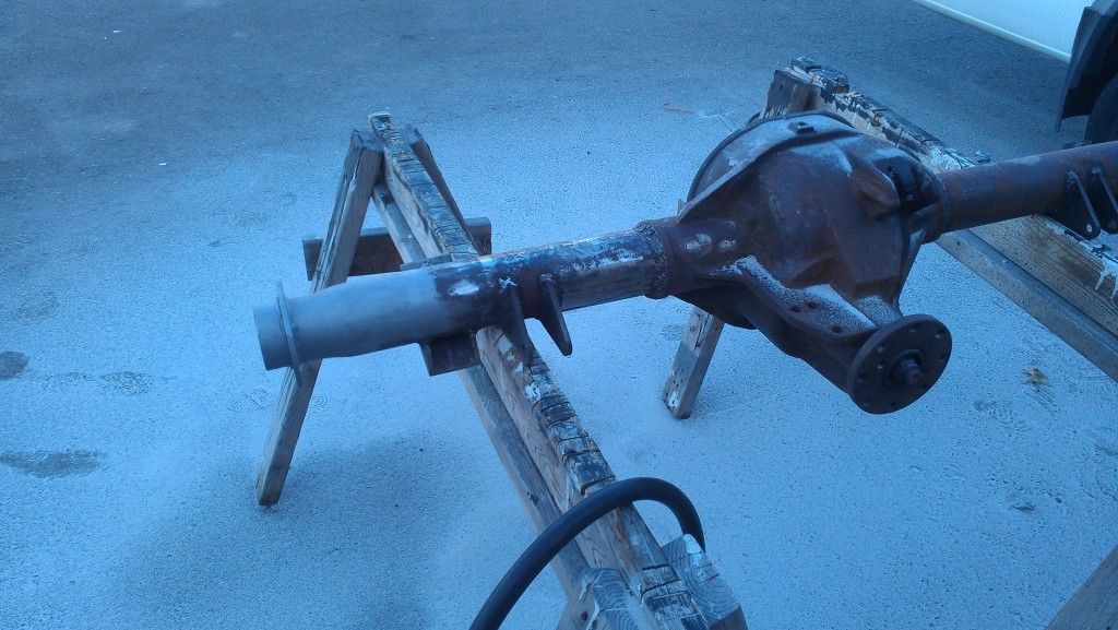

Plan
Measure
Cut
Clamp
Weld
Weld again because your MIG was out of gas the first time...
Now Position
Weld
Sandblast
Insert plug, done

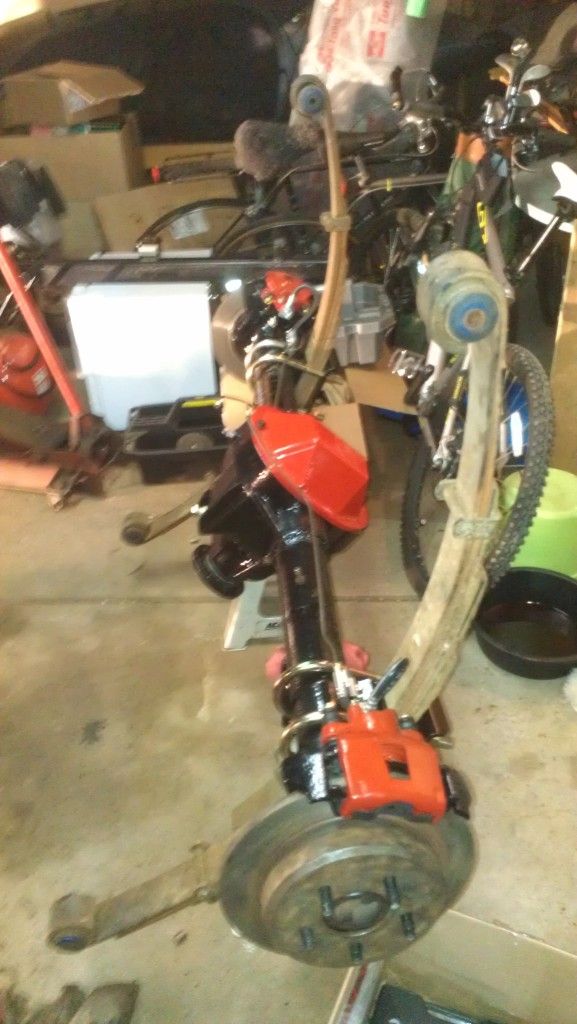

Been working on this thing as much as I can but I'm dealing with some serious time constraints as I'm working 50 hours a week and going away to school in two weeks. So much to do.
But anyways, got the second coat of paint on
Installed the shafts and cross pin, everything inside the diff is ready to go. Crappy pics, the humidity was killing me.
Installed the caliper mounting brackets
And the moment we've all been waiting for...
Ready to be swapped

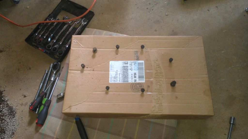

Punched holes in a piece of cardboard to remember which bolts go where on the T-case

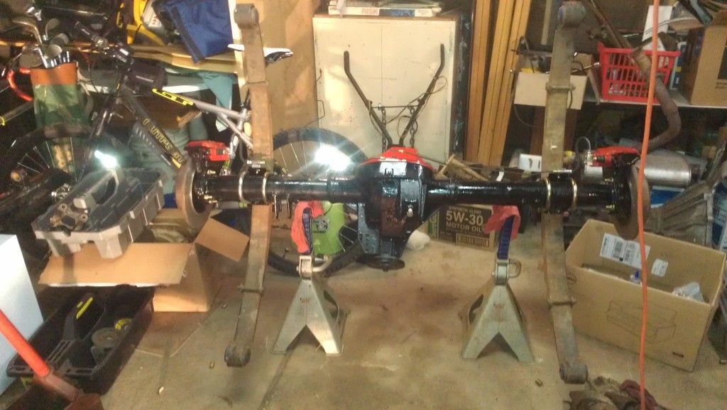

Springs bolted up to the 8.8

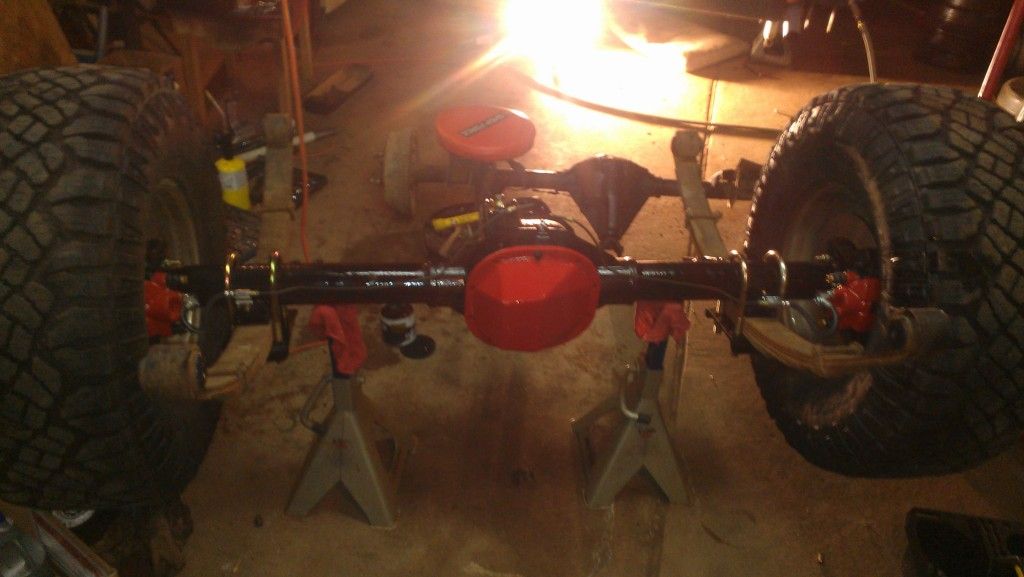

Tires on
Ready to roll under
My brake setup...I needed to extend the hard line so the soft line would come down centered on the axle. Welded a piece of angle and relocated the mounting plate for the hard/soft connection
And installed! (In the wee hours of Tuesday morning) Sorry for the crappy pics again, it was late and blah blah. I'll take better ones if anyone wants to see more detail

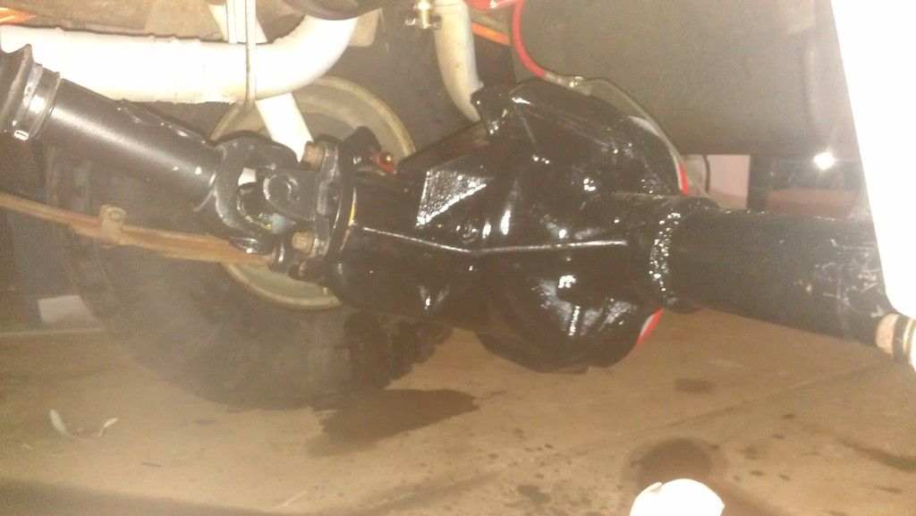

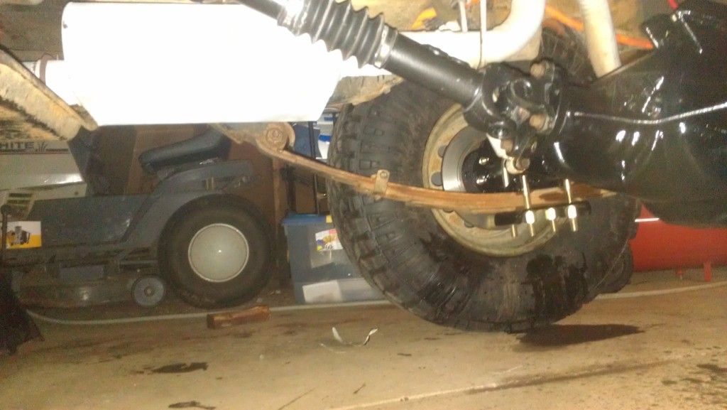

Pinion angle...I might shim it
Its what I get for guesstimating...what do ya'll think?
