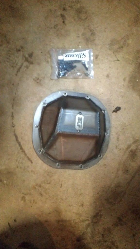

Geeze oh geeze, where have I been?
Small update today, the BTF diff cover arrived.
That's all I can post until I stop drooling..

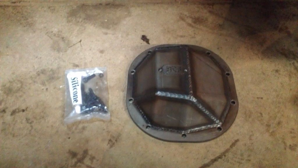

I painted the diff cover today, flame red, same as the jeep.

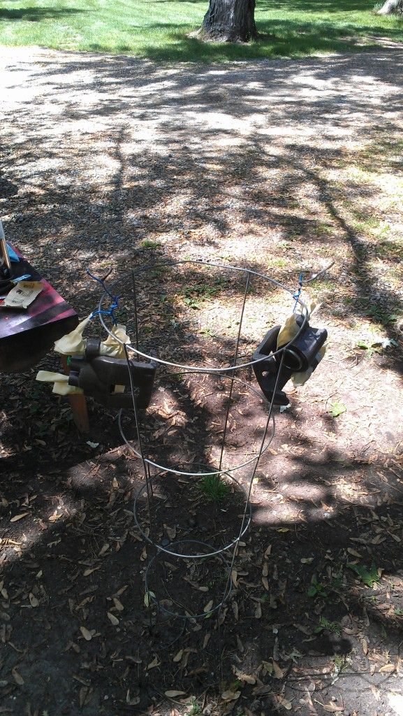

Got the calipers painted on my super custom painting rack..
They are much more red than they look in this picture
