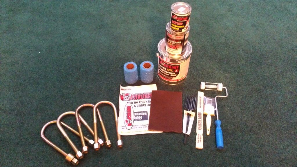

Got some more parts today..
Monstaliner One Gallon kit, black. And my free quart of chassis saver (which I'll be painting the axle with)

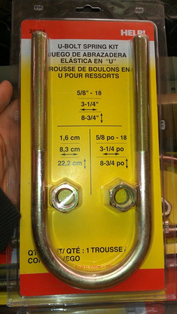

U-bolts came in from work (right ones this time)

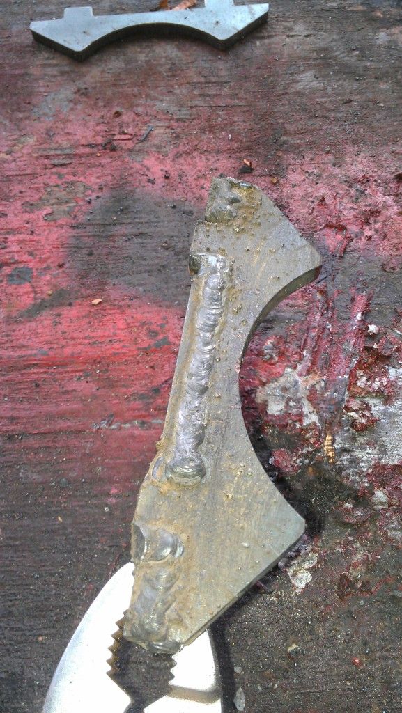

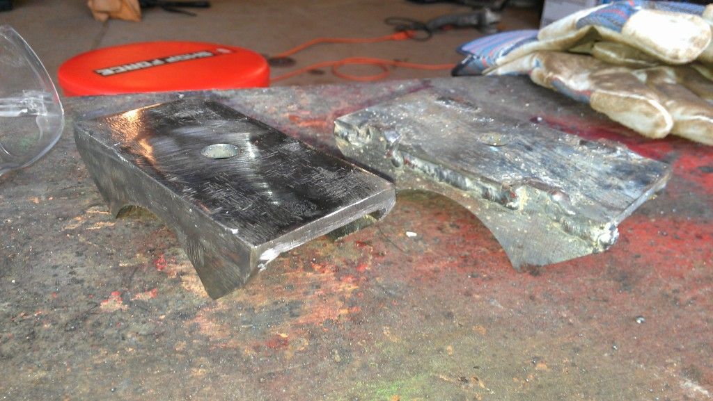

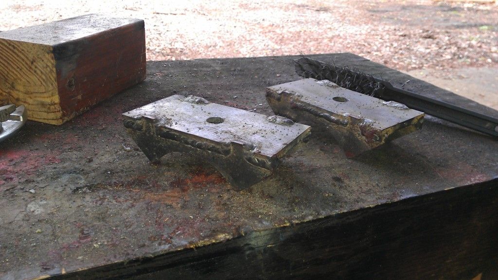

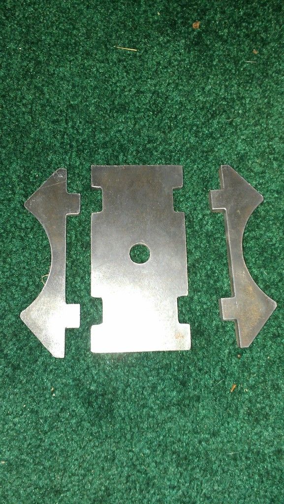

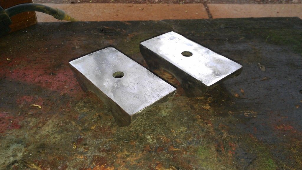

"Assembled" the spring perches today
Before:
During:
Done and everything ground smooth
In case you cant tell, I'm rather proud of how well these came out....

Wow! looks good. You know a really good trick for getting rid of that spatter? use Anti-spatter it comes in a spray can, pick it up at any welding supply store and you will virtually have no spatter just spray it all over everything before you weld.

Those perches look awesome, man. You did a very good job! I might send mine to you to get welded.
