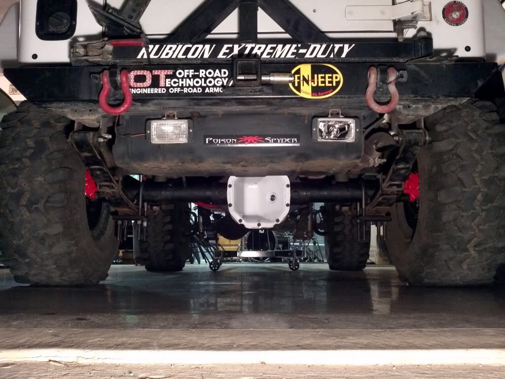

just put mine in this weekend... just brakes to do, u-bolts to trim and a flange yoke I had to order (absent from my donor).

Where's your license plate? trying to find a new place to put mine! Sick of getting gas everywhere...

My plate goes in my spare tire w/ led lights...

Aww man, I hate to tell you, but you put the axle on the wrong side of the leaf springs.

Sheesh, that'd be crazy tall. Wonder what my DS angle and CG would work out to be...
Originally Posted by JEEP_Nut1218 View Post
Looks good! What diff cover is that? And are you getting the ford stock flange yoke or a conversion?
It's a Ruffstuff (Dan and crew took care of me), and I'm keeping the ford flange (yoke arrives today!). Unfortunately, I'm laid up after some minor surgery so I can't do anything today.
