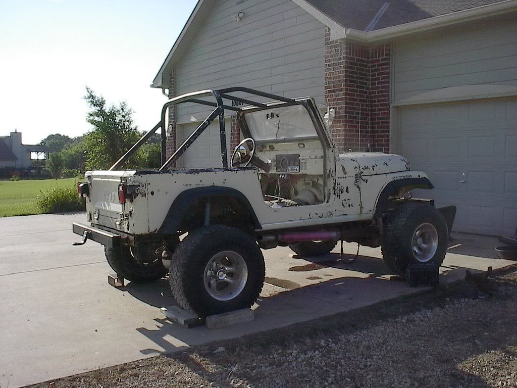

Anyone used the MM from JC Whitney? They are weld in and for everything about 60 bucks. I'll look for a brand but they say that they are made for a Jeep to Chevy 350 conversion? MM's are on my shoping list and I wanted to make sure I get the right thing the first time.
2nd. How do you know exactly how high to mount up your radiator? Is there a certain height. If you had to choose to high or to low which would you go?
3rd. Stick with manafolds if you can. Headers are a PITA and they have to be the right ones or you will be running mufflers for rockers. Here is a Jeep my neighbor picked up a few mo. back. It has been a complete frame off but this is what it looked like when we took it off the trailer. Keep in mind stuff is hanging off of it but look how low the cherry bombs are.

Sorry.....Here is the pic I didn't know
how big it would be. Don't have time out the door
to work to resize.
He went the homemade route
for his weld ons and got the other
parts from AA. Ditched the headers
when it was time for the 350
BUY IT DONT' BUILD IT!! You will be money and time ahead. (Flip off)
