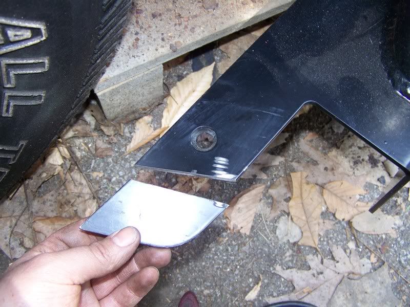

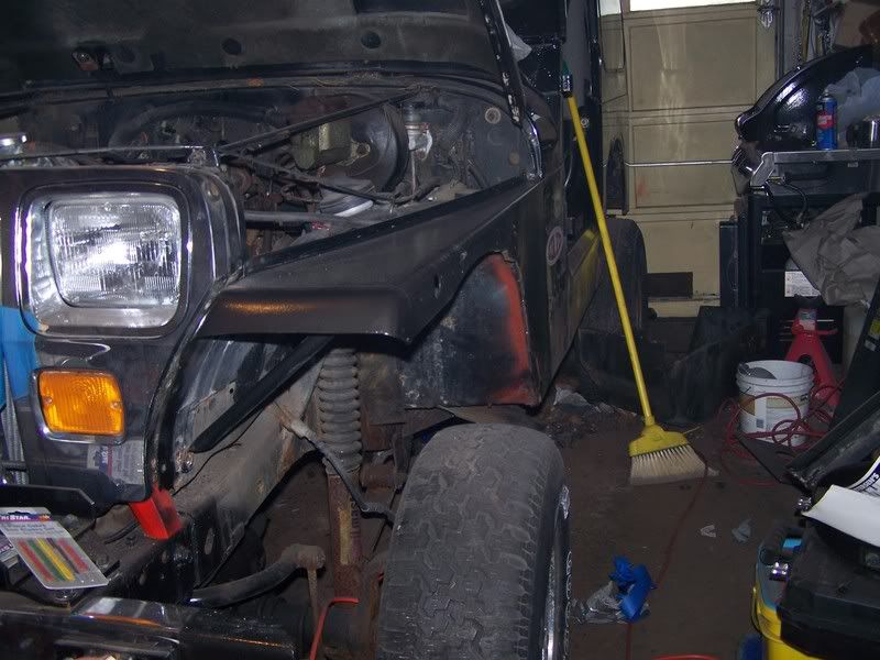

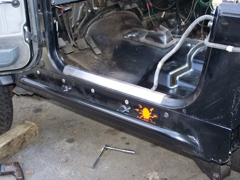

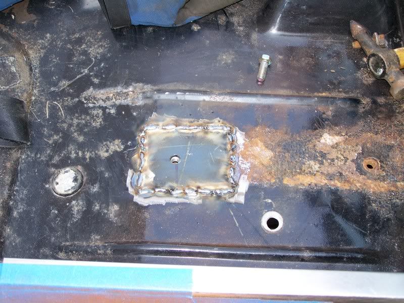

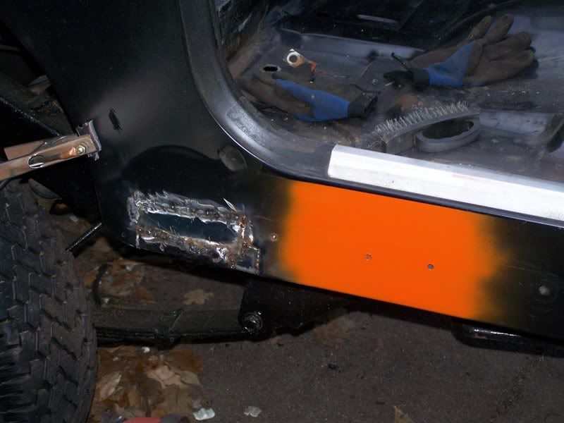

I had to replace three seat mounts.
I also got one rocker knocker installed.
I had to trim it to clear the TJ flares.

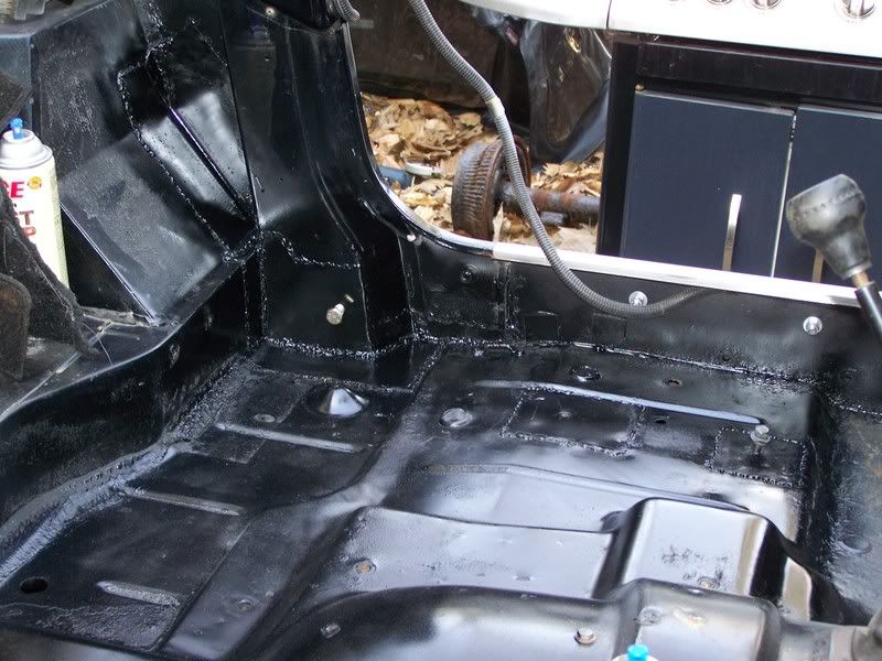

Patched another small hole on the passenger side of the Heep and painted in prep for my Rocker Knocker.
I would say it was a productive weekend.

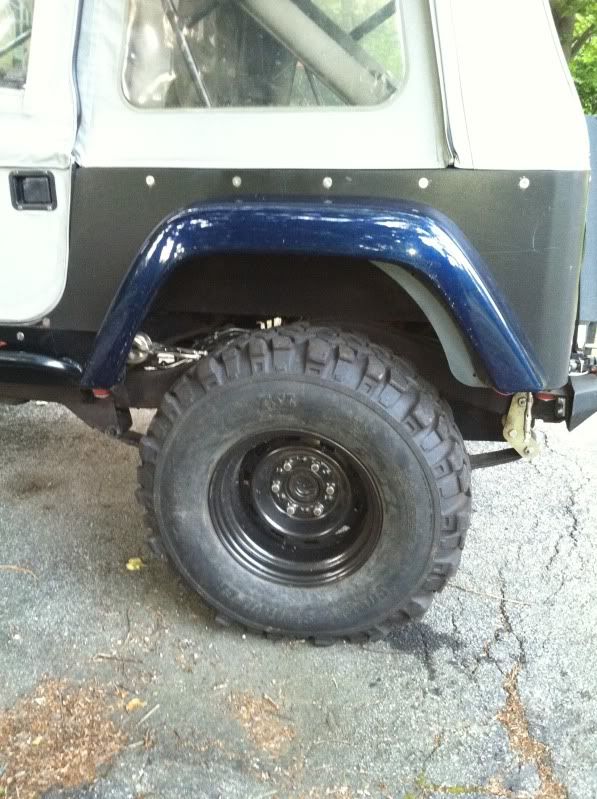

Originally Posted by obsessedjeeper View Post
awesome find and great work! could you post up a little more about the way you flat fendered it and post up some more pics of it? id like to see how it looks in a whole jeep shot if you dont mind
I found one but will get more tomorrow in the daylight.

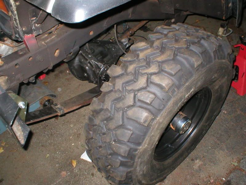

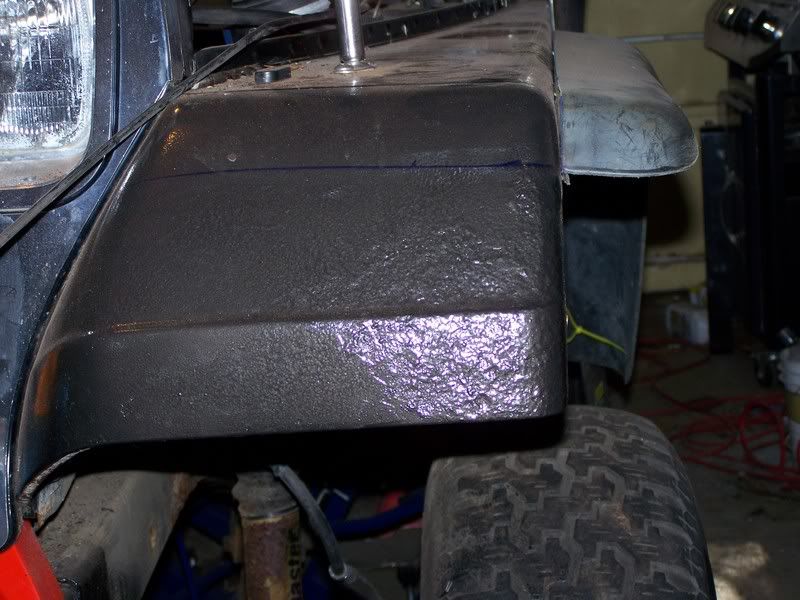

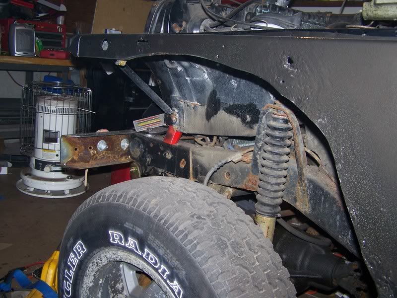

As for the frnders, I don't have a ton of pictures from when I flat fendered them. Actually the hardest part of flat fendering was trimming the flares. I did that first. I removed the stock flare and mounted the TJ flare flush with the top of the fender. Then marked the flares about where I wanted to cut them. I then traced out cut lines and trimmed cut and sanded...a lot. When I had the flares how I wanted them I remounted them to the fender and marked the fenders for cutting. I then cut the fenders to match the flares.
Here are some pics.
I did also have to pop rivet the seem back together after trimming the rear portion of the fender.

how do you have tire coverage with the chopped TJ flairs? my tires stick out 3"?

Thanks!
The rims in the pic have 4.75 of backspacing.

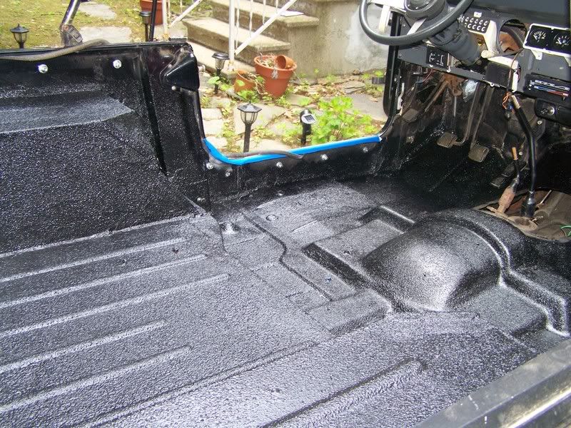

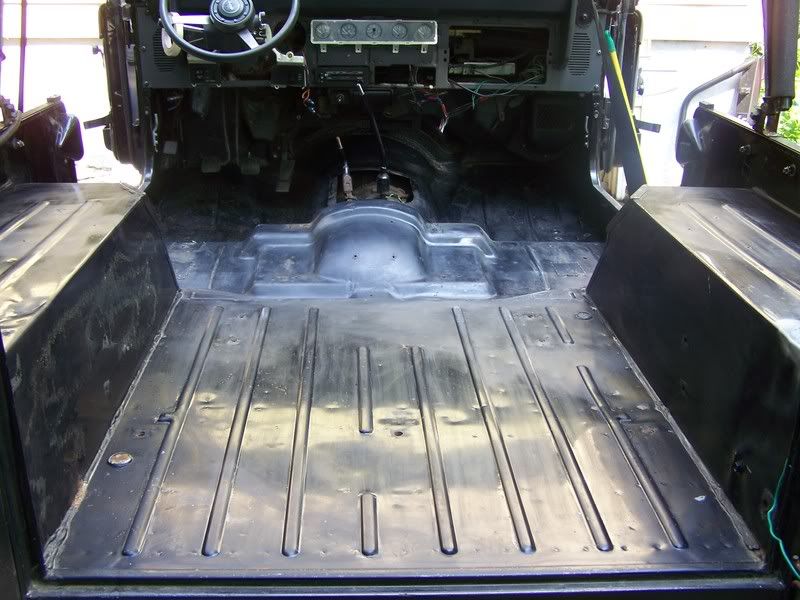

Wow, I totally forgot about my build thread. I don't get on here as much as I used to. I have a lot of updating to do.

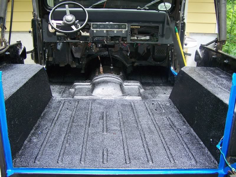

Well, since my last update I installed a D44 in the rear I then sold the D44 to buy another D44 set up with ZJ disk brakes. I then Herculined the tub. Here is a little before and after.

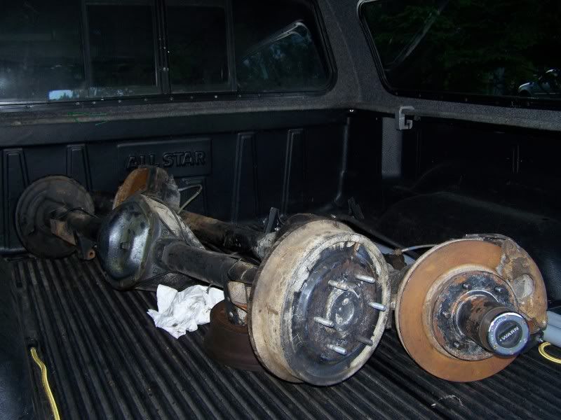

Originally I swapped in a set of 4 cylinder YJ axles with 4.10 gears. Then I swapped in a Comanche D44 (still had stock 3.07 gears), which I sold. I next picked up another MJ D44 set up with disk brakes but no gears. Then I found a deal on a set of Waggy axles already set up SUA for a YJ with 4.09 gears and a LSD rear. I wanted to stay SUA anyway to keep a low center of gravity. I am currently running Chevy Blazer rally wheels with 34x10.5x15 Swamper LTBs.

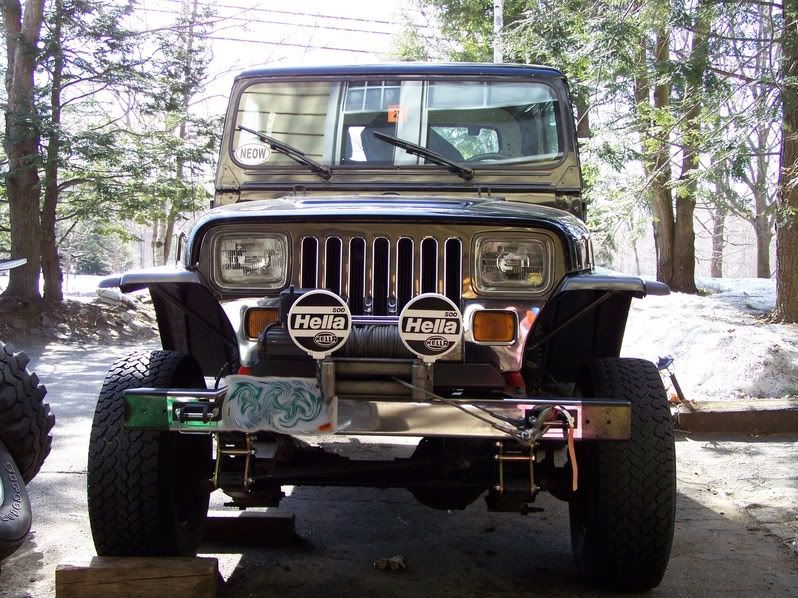

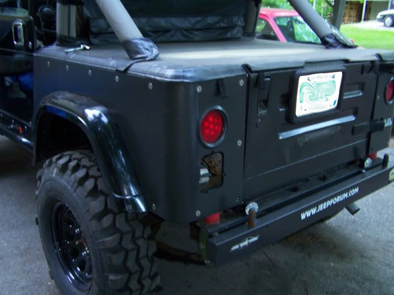

I picked up and installed a set of MORE shock hoops. I really like the final product. While I was at it I replaced the rusty half rotted hard brake lines.
I also finally ditched the stock front bumper for a custom shorty bumper.
This is how the Jeep currently sits.
My next step is to add some rear flares. Here is a mock up.

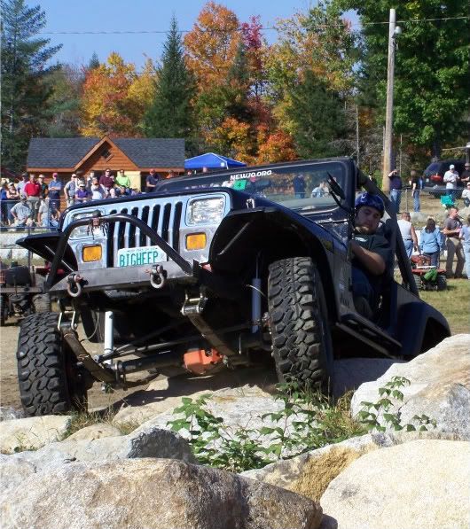

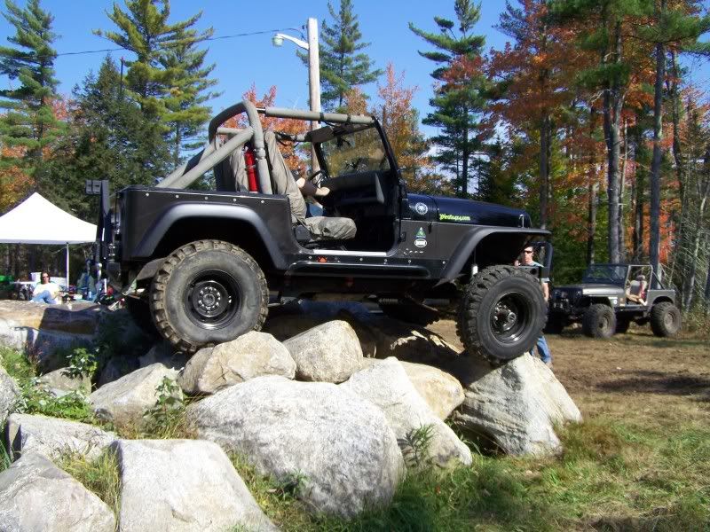

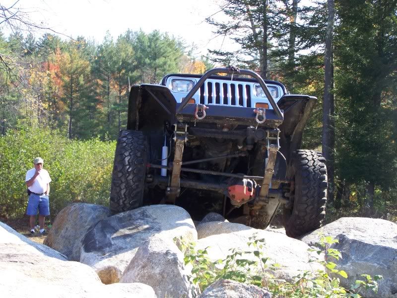

Last month my club did a Rock Crawling Exhibition at a fair in the town of Sandwich, NH. It was nice to finally get the YJ on the rocks and actually have people there with cameras. Here are a few pics.

After the fair I decided the rear limited slip had to go and a locker was a must. Then I found a deal on a Ford 9" out of a early Bronco already converted to disk brakes with a mini spool. The only problem (if you want to call it that) is it has 4.56 gears. So over the winter I need to swap in 4.56 gears in the front axle and convert it to 5x5.5 bolt pattern.
