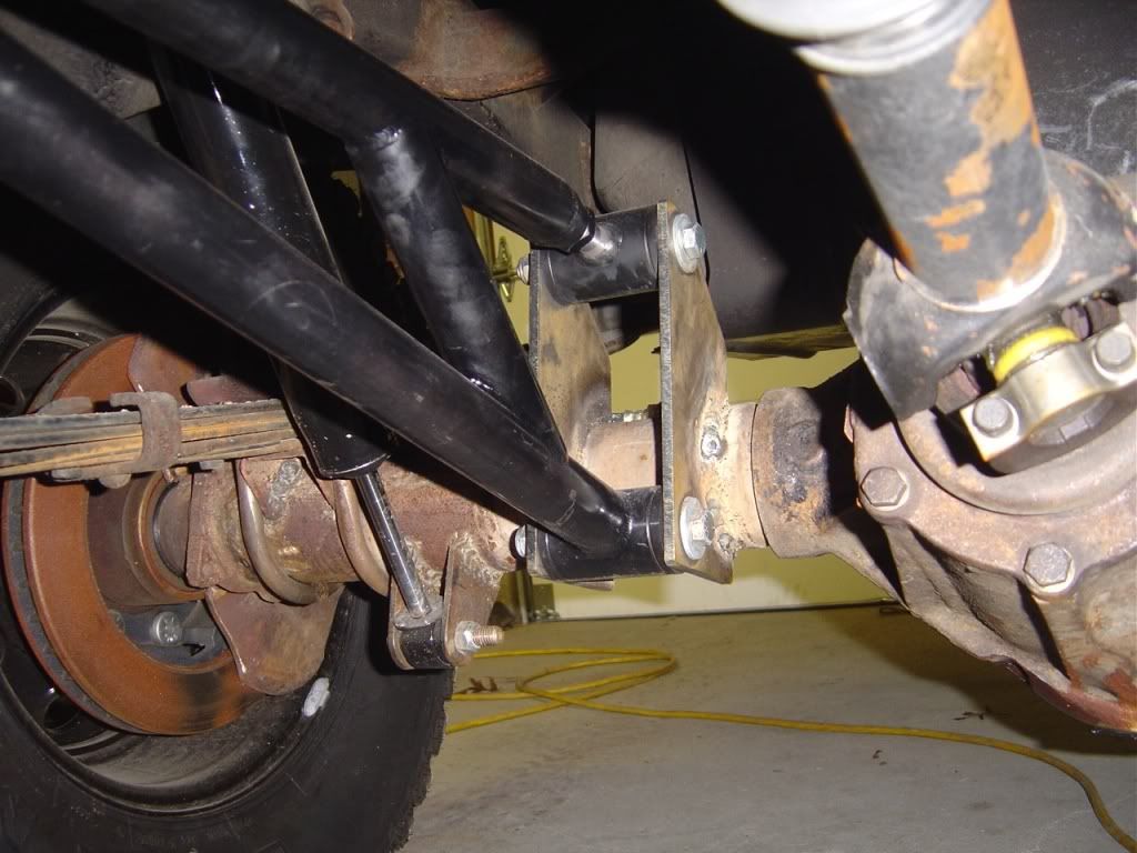

By the way, great looking ride. How does your spring-over behave on the road ?? Assuming you drive it on the street. I guarantee I'll be in touch over the next month or so, until I get this thing on the street. Thanks again.
My Jeep rides smooth like it was bone stock. The only problem I had was axle wrap. I fixed it by using SAM's anti wrap bar. See Pics
