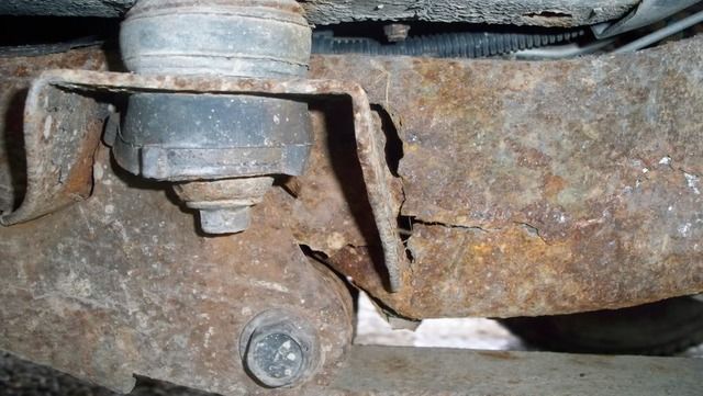

then upon inspecting the frame we found this:
luckily my dad's friends a pretty good welder and he was able to fix it up good for us

good luck with the build! i dont want to be a smart**s, but i suggest checking out that frame VERY closely, as the pics shown seem make it look in prety bad shape, and i dont want to see a fellow jeeper get hurt. other then that, keep on jeepin! it never ends! nice looking project!

****, that jeep needs a new frame

it was patched up pretty good by my dads friend, tomorrow I will post a current picture of the frame

got an pics of the frame repairs? good luck, the rust monster got my gfs yj.
looks like a decent jeep other then that
love the green sahara!
id prolly work on making sure the frame is good to go. my 90 sahara rotted out around the rear shackles.

Check the frame with a screwdriver (see it it will poke through) around the steering box and also around the rear shackle mounts. Sounds like your dad`s buddy is being a big help. If you do find rust, search using frame rust or frame repair as your key words to see what other folks have done.
