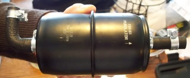

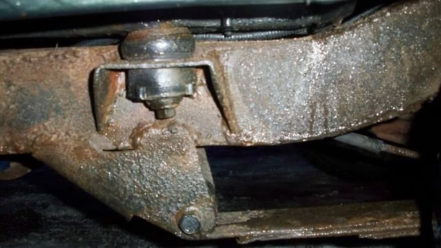

Well I finished the fuel filter today took a look at the hoses and they looked to be alright to use again so I put new clamps on and hooked it right up and started it up and no leaks!
Also the picture of the repaired frame, I tried to use the same angle the other picture had, I did not take a picture of the underside

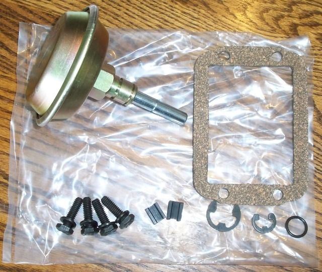

The 4wd vacuum actuator came in today I'm surprised at how fast it was shipped to my house I wasn't expecting it for a few more days and I didn't even select overnight shipping haha. I probably won't install it until this weekend because if anything goes wrong that I can't fix then I won't have a vehicle.

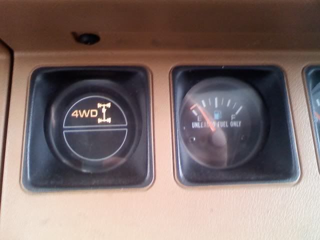

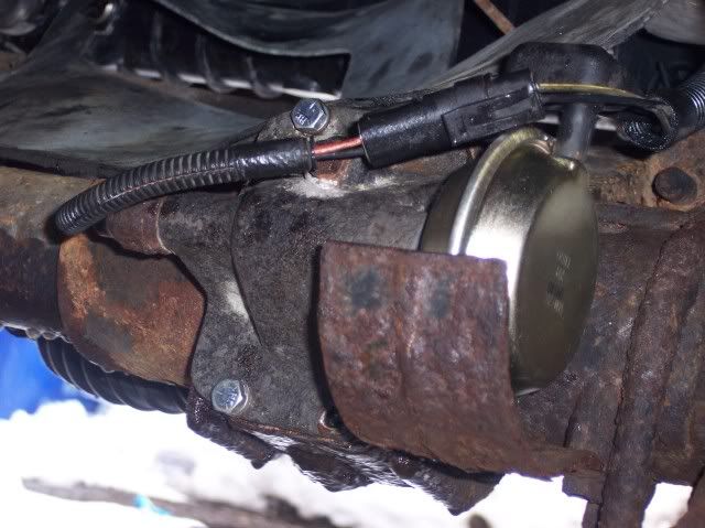

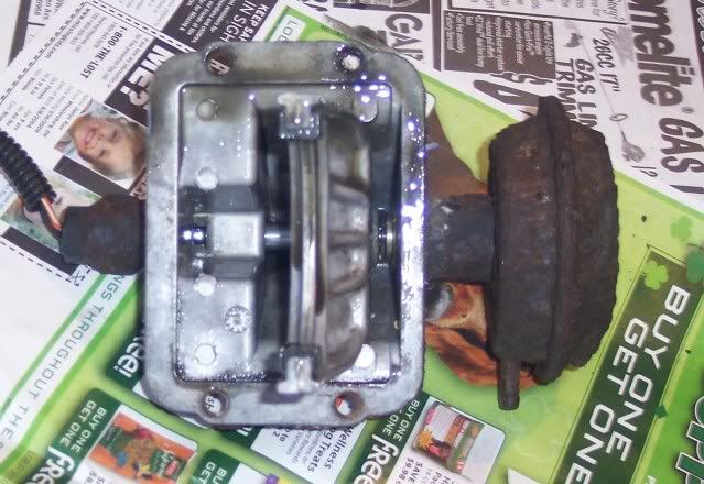

Well we installed the actuator today and the 4wd works great! here are some pictures
This was the disassembly:
I took a picture of the assembly but it became corrupted for some reason
Here it is assembled on the Jeep:

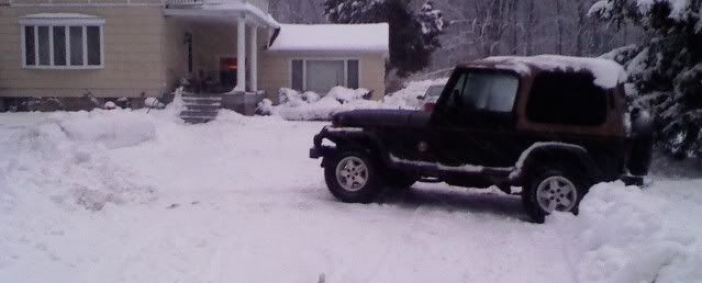

and the light even works too!!!!
this happened yesterday when i pulled in hopefully this will help prevent this from happening again haha, better tires would probably help too:

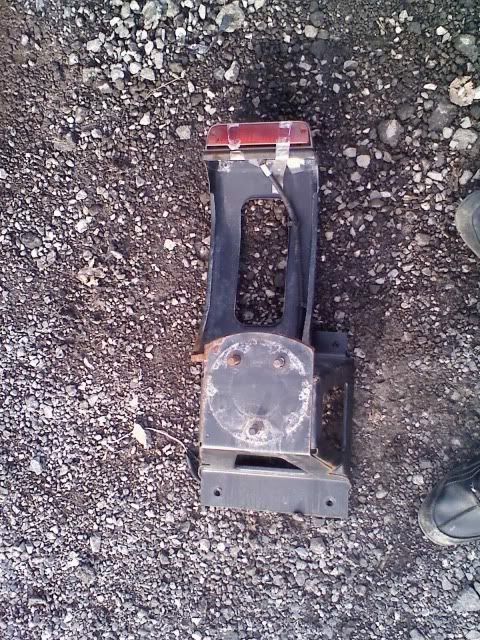

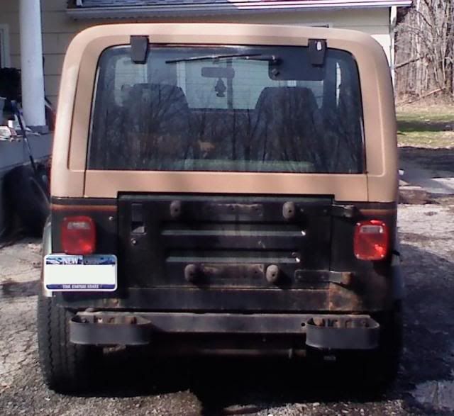

With the spare tire off, I was able to remove the 3rd brake light/tire carrier assembly. I wanted to remove it mainly because the third brake light never worked because of the rotted out connecter which I am having a pain removing
I like the look and feel of no tire carrier on the back of my jeep:

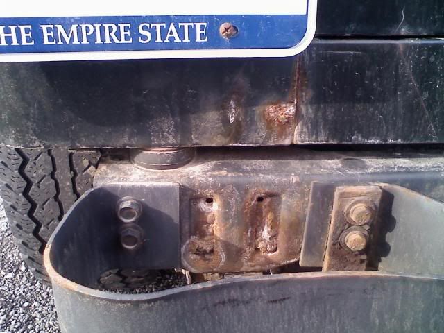

One last thing is I found some rust patches I am going to have to fix up:
More Rust:

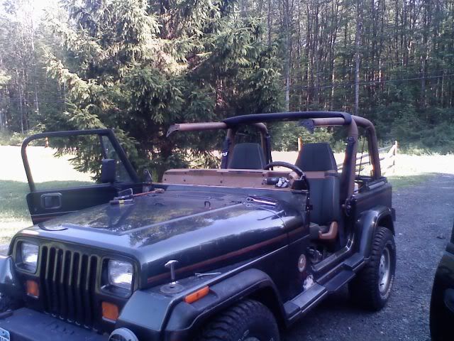

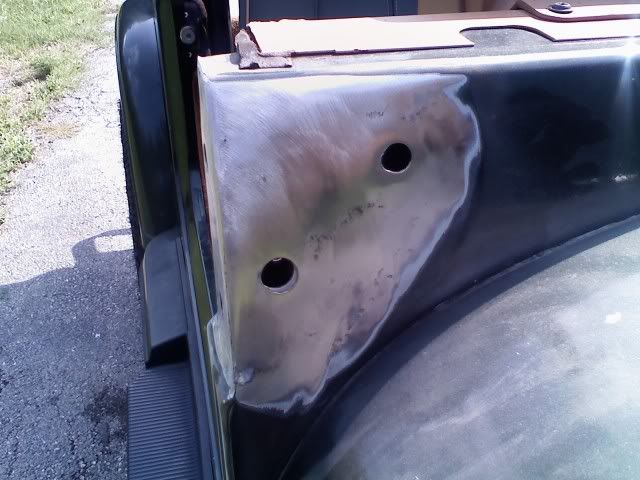

These things include: new tires (Wrangler Authoritys 31x10.5), new calipers (old ones started leaking), and I also fixed a few rust holes on the body with some bond. i am currently working on replacing the rusted windshield frame on my jeep, this is how the jeep sits today:

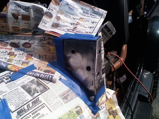

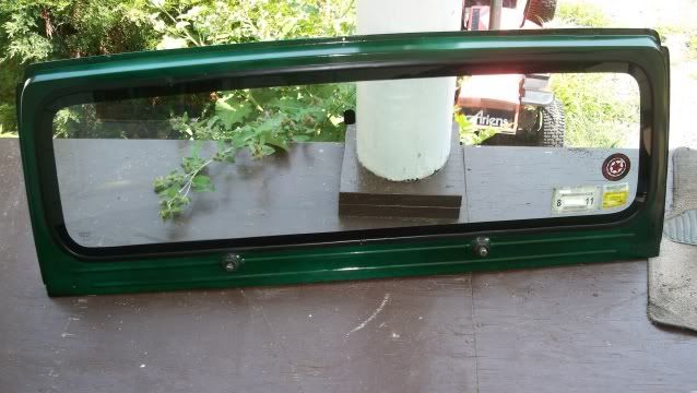

Out with the old:
In with the new:
here is the new windshield frame, painted, and new glass in it (old windshield glass cracked during removal). The paint is slightly lighter than the jeeps color but it doesn't bother me (only had enough paint for 1 coat).

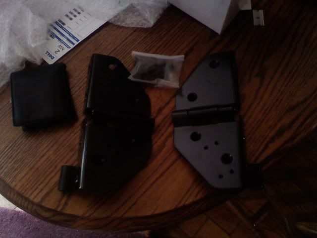

Also the hinges came in:
I was wondering ... I want to keep them black but should I repaint them so they don't rust or is the factory paint good enough?

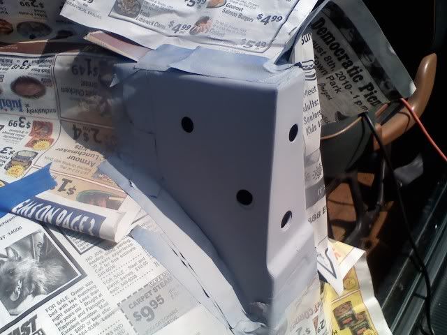

Also I sanded and painted the area under the hinge so it doesn't rust:
I don't have a picture of the green on it yet though. My goal for tomorrow is to get the windshield finished and attached ... the cowl seal from quadratec should be delivered tomorrow
