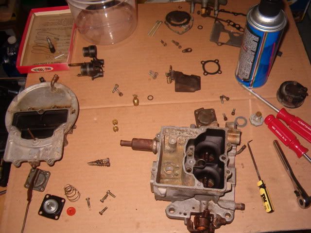

OK so rebuild/clean. Pretty straight forward, just take everything apart and spray all passages with carb cleaner to clear them out. Then soak all parts that are not made of plastic. After that put it all back together and adjust float 9/16 inch from top of float bowl.
Pre soak image.

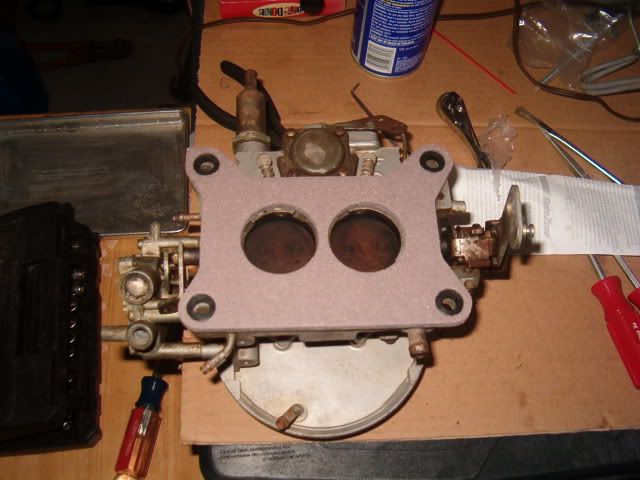

Then i found something interesting, my carb adapter doesnt seem to cover the whole base of the mc2150 and leaves a rectangular gap. I used the right part # suggested in other threads and am wondering what problems this may cause and how to fix it.

Does anyone have the dimensions of the summit racing carb adapter. Also any one who used the mr gasket adapter run into any problems like this?

hmmmm..... I used the mr gasket adapter and didn't have that issue but i believe mine is a 2100, was always told they were the same though. (the difference maybe that yours looks to be a "smog" carb which imo is good because it gives you more vac ports. At first look at you pic, i see the adapter plate is upside down, if you could flip it over to make sure the gap is going to fall in the same place, then if you take a pic like the one above then with the plate removed, my instict is that it won't hurt anything because you'll still have a good seal between the business parts of the carb and the intake. i think the part overhanging in the pic is just a void in the housing and shouldn't affect performance but again hopefully someone that has an actual 2150 can verify this. Also what size carb did you get? is it a 1.08? it should have a circle stamped on the side of the carb with numbers in the middle.

jeep108, ive been looking around forums and have found people running into this problem. Yes my carb has the 1.08 cast and the other numbers i saw were 6AB3 and 6FRA. Some of the other mc2100 with less vac lines have this part covered and leaving it exposed would cause a huge vacuum leak. The gap shows no matter which way the adapter is facing. I have found through another thread that you will need a carburetor base gasket to cover this gap so i went out and got one from autozone.
Autozone carburetor base gasket P#60716. Its a pretty thick gasket and seems to cover it nicely.

looks like it's all coming together, (btw, i hope i didn't come across as a jack @$$ by pointing out the plate was upside down, just wanted to make sure the gap would fall in the same place Had i paid a little more attention to your pic and noticed all the vac ports on the side with the gap, i'd of known better than to come up with the "just a void in the housing" theory.

you still need the plate, if you look at his pic of the adapter plate you'll see the 4 inset holes, those are where the intake bolts will match up

the one i used is the same as the one beechedjeepzj used, mr. gasket part #1937, got my from the local orielly auto parts, but you can get them online as well.
Also i would like to apologize to beechedjeepzj for giving bad info - i stated earlier in this thread he had the adapter plate in the pic upside down, turns out i had my brain in upside down (which happens a lot more often these days!) i forgot the carb mounting bolts are inserted thru the plate upside down, so again - SORRY BEECHEDJEEPZJ!!!!!!!! i would also like to thank those of you that read my post and realized that i am a moron for not pointing it out!
