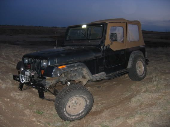

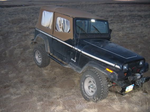

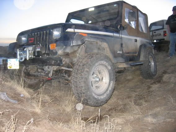

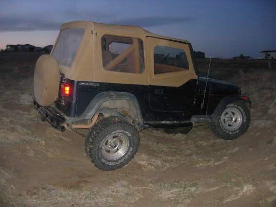

With swaybar and trackbars....
Without sway or trackbars....
'nuff said!

No sway bar, track bar....
1992 YJ I6 5sp
4" RC lift / 33x12.50 MTR's / Custom front bumper with grille guard/light bar and rear bumper with tire carrier/ 8.8 rear, dana 30 front--4.10's / 1" custom lift shackles
