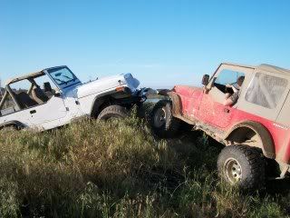

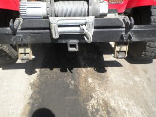

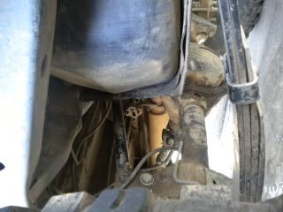

Just so you have an idea of what im working with...

Maybe some better pics that arn't sideways.
I can't even see any bump stops???
