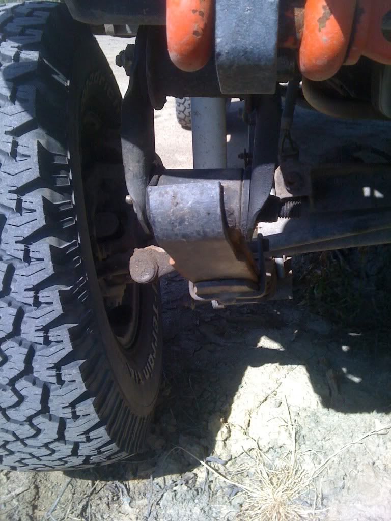

The PO put a Black Diamond 3.5" kit on. Each spring has a full wrap and a half wrap like in the above picture. The full wraps are at the front shackles and the rear frame mounts.
That's what made me wonder and ask the question.
Also, all bolts are 1/2".

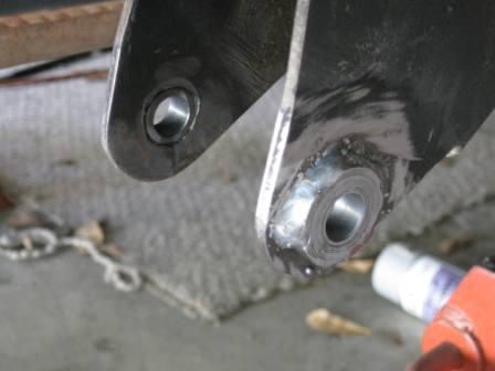

Went back and measured. The holes in the frame are 9/16 but the spring eye bushings and bolts are 1/2". Somebody screwed up. I'll have to find 9/16" bushings and greasable bolts.

The 1/2" bolts wallowed out the holes in the frame on one side. I drilled the holes out to 13/16" and turned some bushing to bring the hole size back to 9/16". Hopefully the holes on the front frame are OK.
