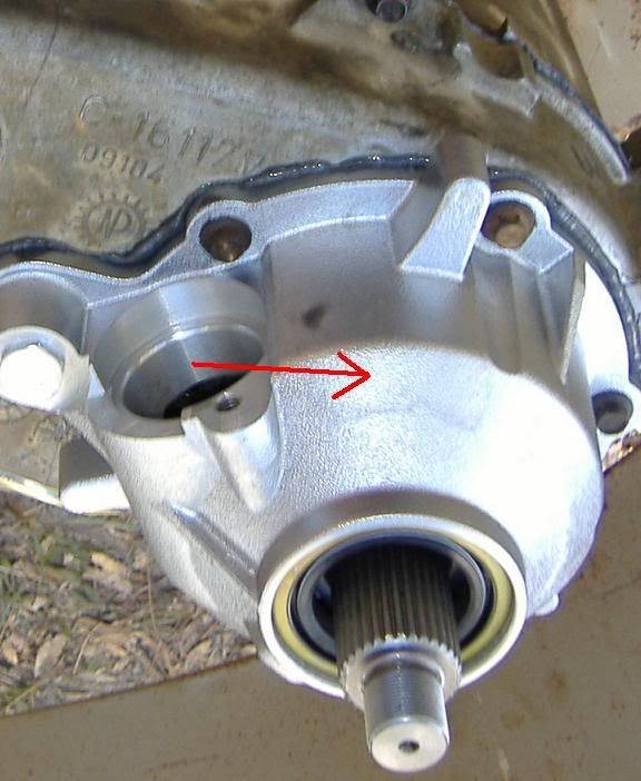

Also my speedometer doesn't work now that i installed the SYE.. I put the new gear plastic thing on the new shaft and it's plugged in but no speedo? Any ideas?
Check the orientation of the module that the gear plugs in to, it may not be oriented correctly in the SYE for the gear you have in there. There are 4 possible orientations.

Hey thanks everyone! I picked up some Neapco joints yesterday (no one sells Spicer)but i haven't had time to put them in yet.
I'll try turning my speedometer around to see if that makes it work, i did put the plastic gear on the output shaft btw. I hope i'm not chewing my gear up :

Just wanted to update that my speedometer gear that plugs into the SYE housing was 180 degrees off (there are 4 possible ways for it to go). This explains why it wasn't working. If you look at the speedo gear, one side of it is closer to the outer diameter of the plastic speedo housing. That part butts up against the shaft inside the transfer case (towards the red arrow). Just in case someone else is having the same problem i had...this is how mine worked. thanks guys
