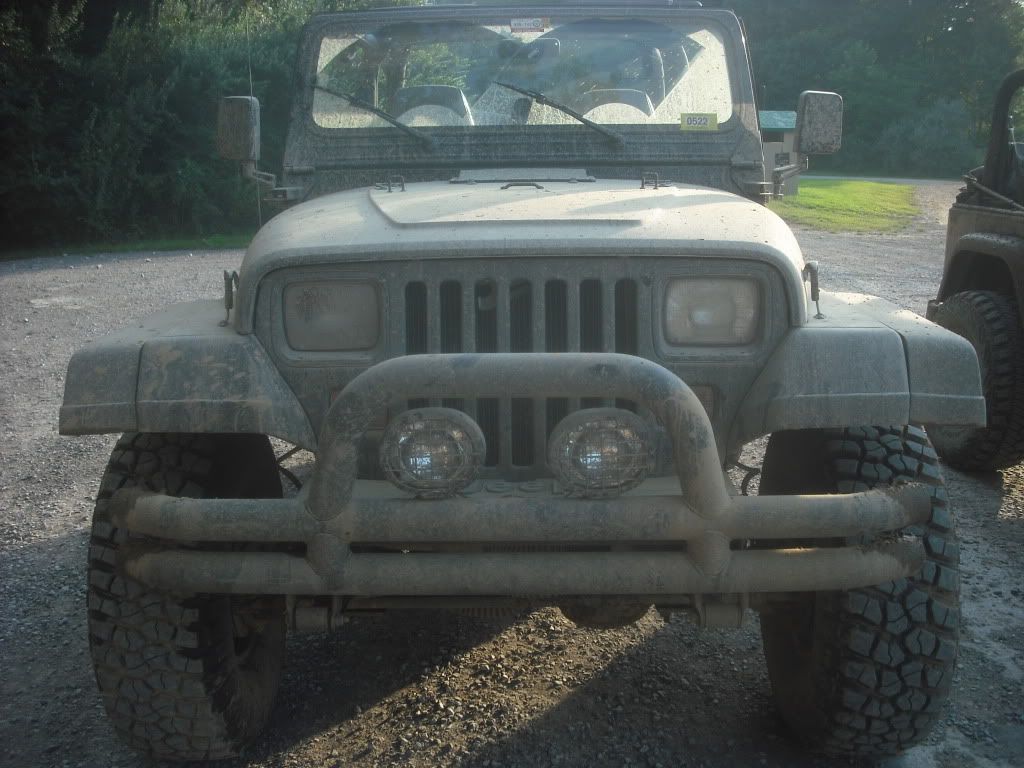

Well after nearly 4 months I finally got my jeep home ! We call it the mean Jeep because when I was Jeep shopping from Afghanistan my wife was looking through the links and said " I like that one it looks mean "
I am only here on R and R leaving in a few days so won't be much updated until I get back in August but figured I'd start the thread.
It's a 93 YJ 4.0 TF 999 SOA on 35" KM 2's I've also picked up a Ford 8.8 and D 30 out of a 89 XJ that I'll be swapping out in Aug/Sept.
Took it out to the outer banks in NC while I was at my brothers house and we had a a blast !

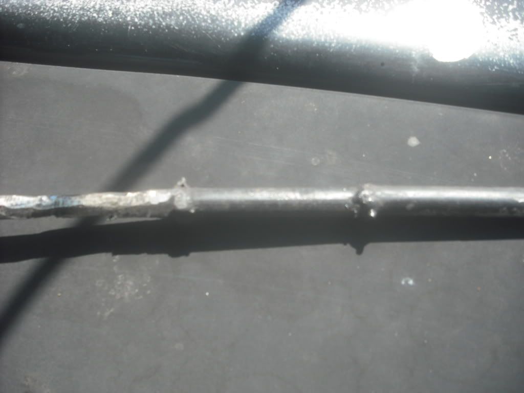

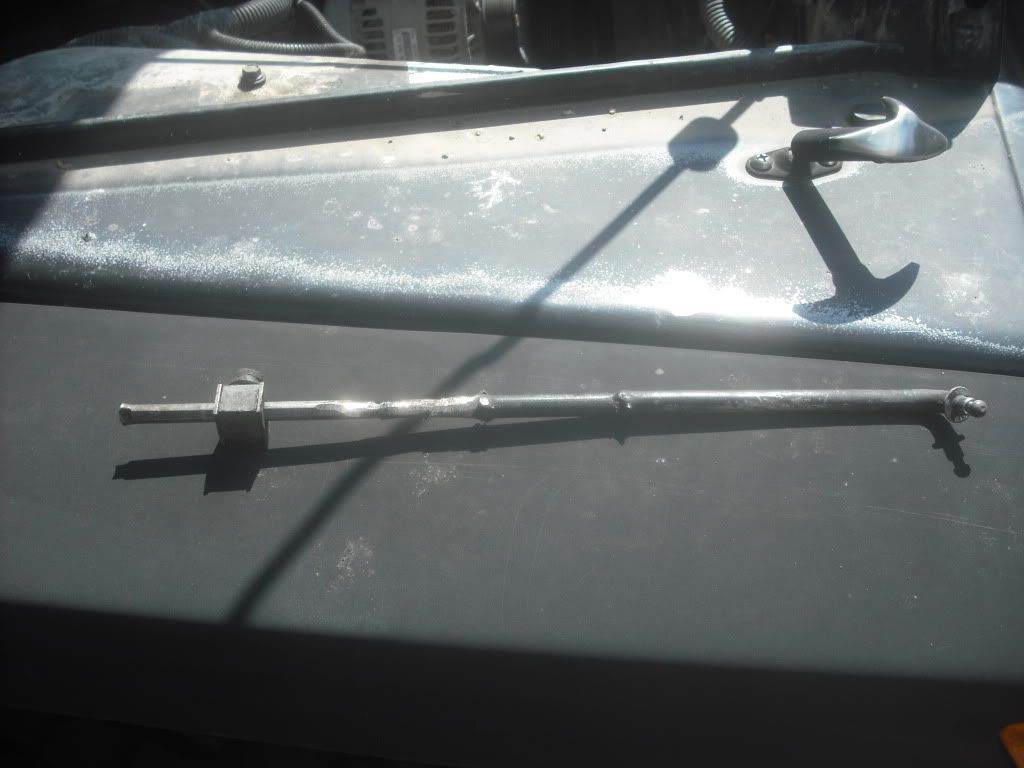

I do have 1 question for all you guru's my shifter column is off 1 detent ( ie P = r R= N N=crive etc ) I got under it today and tried to adjust it but the upper bar seems to increase in thickness and the adjuster is as far up as it will go. with the upper bar detached I can move the transmission through all the gears to include park and the shifter through them all as well. I called every local auto parts store no one carries the upper bar for this. So anyone know where I can find them or another year/make that would work ?

My brother and I have been talking about the tranny shift issue and after looking at it, I believe there was an extension braised onto the end, I had forgotten that the PO had pulled a 3" BL off it which would explain the need for an extended upper rod.. So I guess my choices are to put some sort of BL back under it or find an OEM upper tranny shifter rod... if any one has one kicking around let me know please !

Well I finally got back to the us 7 am on 08 Aug 2011 ! SO of course I got right to work on the Jeep yesterday I fixed the transmission shifter. The PO had removed a 3" body-lift the PO before him had installed but afterwards it wouldn't go into park after looking I found this
there had been a 3' piece welded into it to accommodate the body lift so 5 minutes later with the help of my 4" grinder I had this
and now I have Park again very handy since the e brake isn't hooked up and since I will be doing an axle swap next month that is going to wait anyways

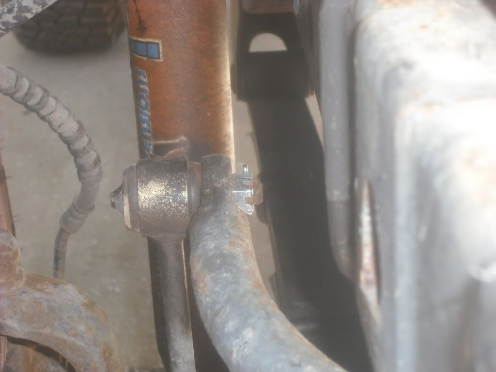

went out and found one of my sway bar links disconnected the other morning so $7 later ( seems no one carries single castle nuts anymore had to buy a pack to get the one I needed ! ) got that fixed

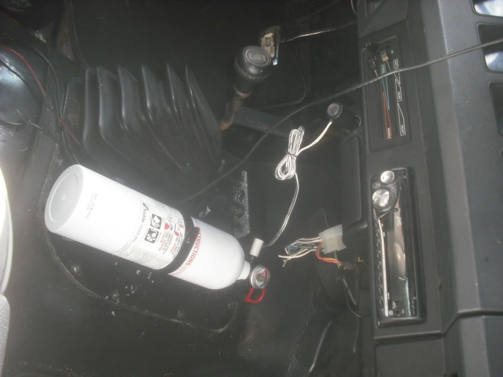

also got and mounted a fire extinguisher also can see the $35 pawn shop special radio I put in nothing special but it works and for the price if it gets toasted with rain or trail damage it will be too easy to replace
