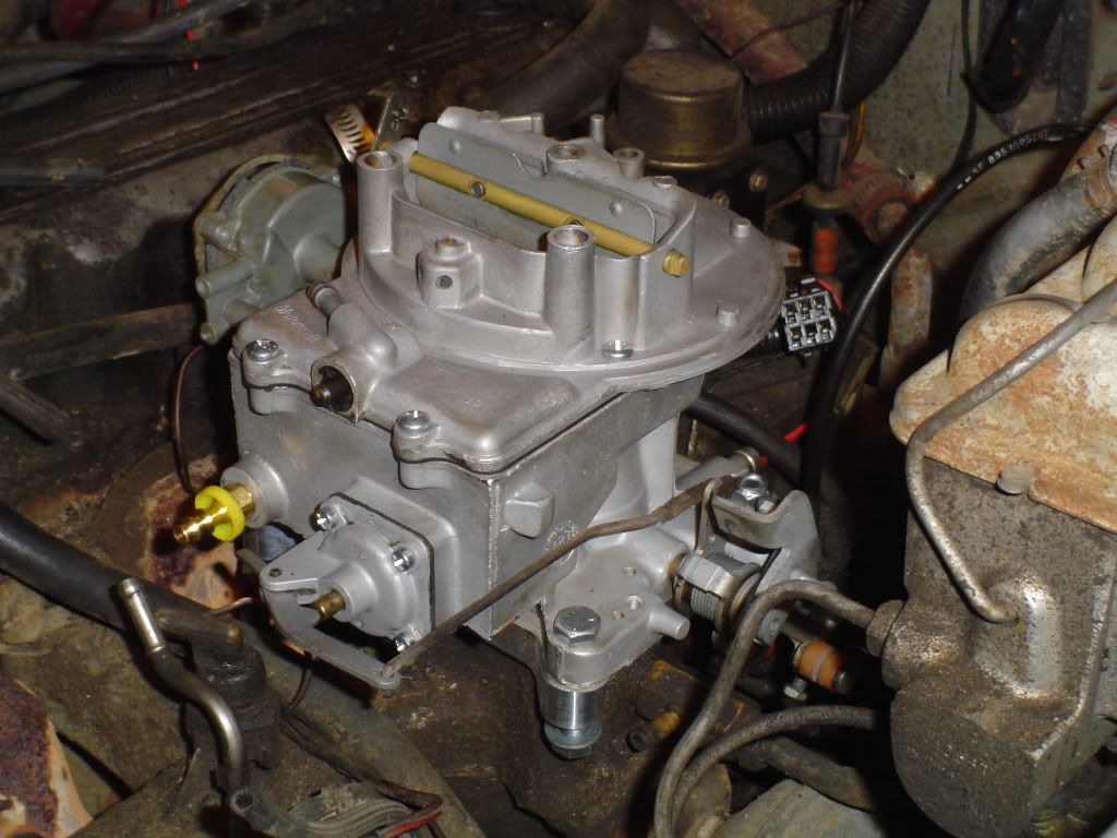

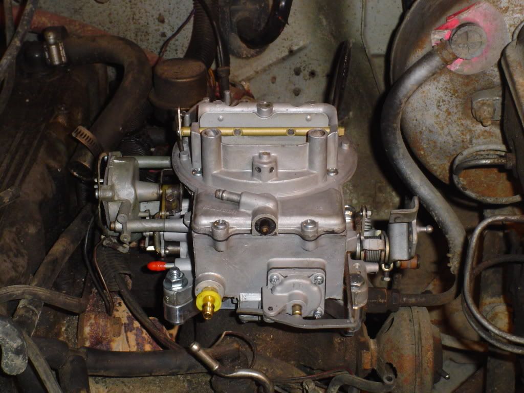

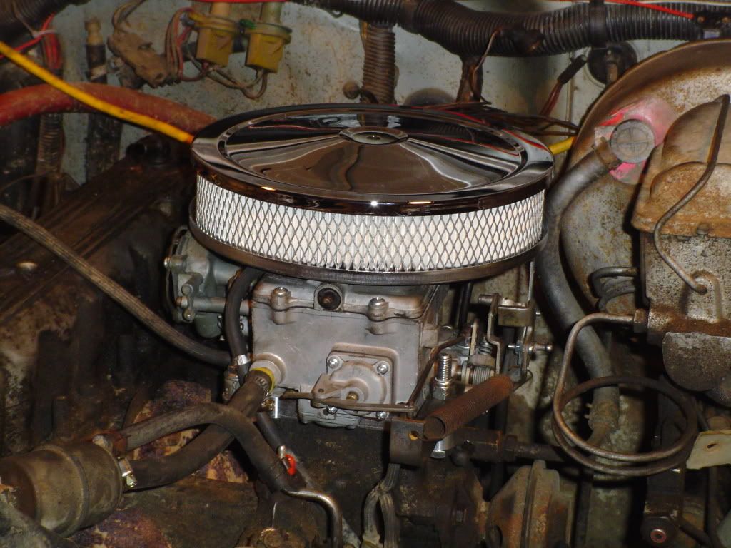

Here are a few pics of the progress.
Dirty old Carter:
Test Fit for the gasket:
Test fit for the adapter:
My new baby:
Everything test fitted and ready to rock:
Before the manual choke install:
Where is the fast idle cam in that pic?

wraithyjeep
wraithyjeep's Avatar
Join Date: Aug 2005
Location: Quinte West Murray Hills, Ontario Canada
Posts: 346
can't see it in the pic
I do see the choke blade adjusting bolt
it is out of site behind the choke thermomatic housing the big round thing in the last picture.
Ok, then I think I know what it is....on the back of that housing there is a screw with a spring on it. I backed it all the way out...without removing it and she still idles really high!
