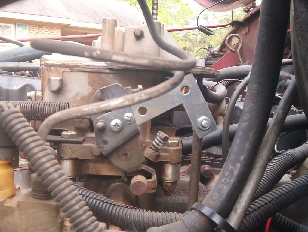

I just used a "L" bracket I got from Lowes for about a buck.
[IMG][/IMG]

Wow
Wow.. that seems too easy... LOL
I would have thought it to be alot more complicated to get it to work just right. Did yuo have to do any adjustments at all? Does the jeep kickdown into passing gear at the right time and only that time?
Just bolted to carb, pulled up throttle linkage rod, measured and drilled new hole and connected. It runs and accellerates like a charm. I have been very happy with the mc2100.

Do you have any other pictures showing the throtal linkage.. I think my carb came in today.... according to the tracking number..
