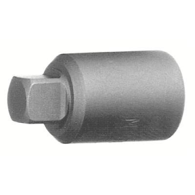

It's a 5/16" square drive that you need.
As for plug locations, I can't help you. My BA10 experience is limited.
Max
Where can i get this bit??? I only see it on UK sites....and so far no local stores carry them. Thanks!
