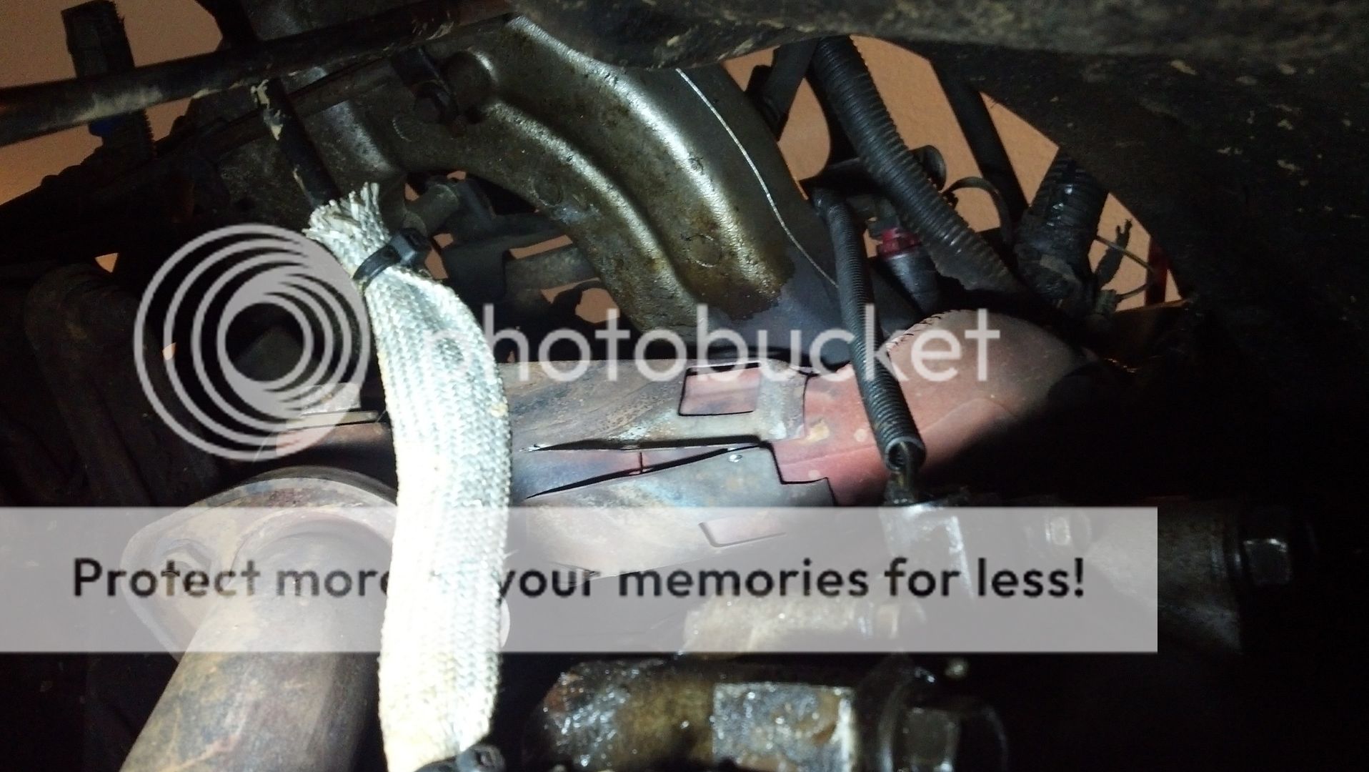

Is this a crack that is supposed to be there? My exhaust is very loud.
It is a 2.5 95 but this is an aftermarket manifold.
Thanks!

In the thinner metal? That's a shield and can be cracked. Look for black soot around any joints or where it bolts to something, the soot indicates a leak

Not the shielding but the manifold itself but no soot anywhere.

If you can feel any air coming out. Then fix it. I am pretty certain it should be sealed 100%. The crack that is between the two heat shields right? Weld her up.

Thats right. Don't use starter fluid. Use carb cleaner spray to check for INTAKE manifold leaks. Exhaust leaks you can feel with your hand. DON'T be spraying flammable liquid around hot engines anywhere.

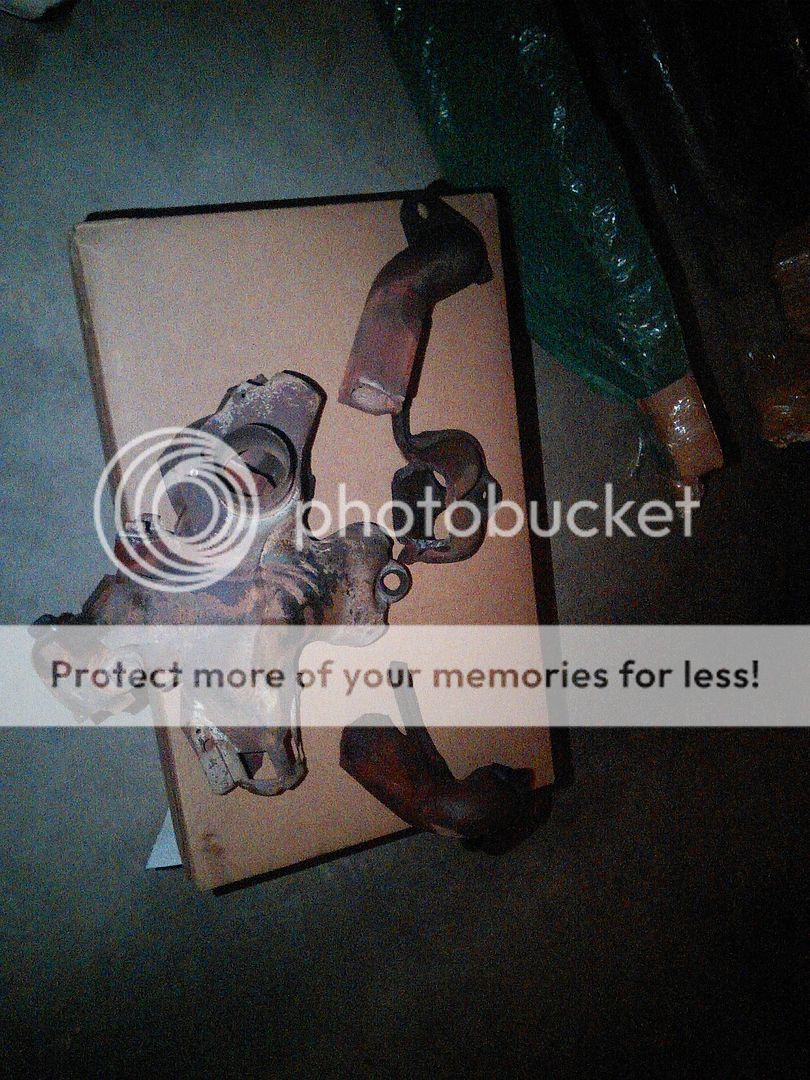

It's cracked, time for a new one! Mine cracked in a similar place:

Get a good header and replace it. Check your hanger backets for your exhaust. Usually a missing hanger bracket will cause the ehaust to pivot on the one that is still good and jam the down tube up into the manifold. It is also real common for the exhaust manifold bolts to back out. if you do have to do the manifold pulling the drivers side fender opens up a lot of space and makes it easier to swap. It should only take 1/2 hr to pull it but it wioll save you frustration and aggrivation in getting to the middle ehaust bolts.

I would say it is cracked....hopefully the Napa part lasts until the 2.5 dies
