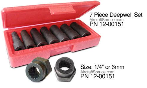

Here's what a set looks like & is good for anything one of these removers will fit on. They're available from Sears as well as numerous other tool suppliers.

Thats the one I used. the lock lug is not on super tight so they come off easy enough.
