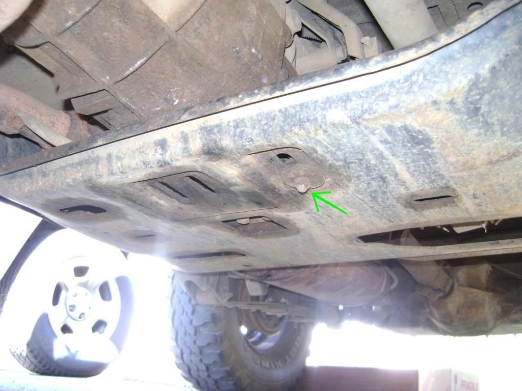

Would this bolt being loose cause driveline vibrations? If so, how tight does it need to be?

I'd suspect tht there would be some vibration but isn't there more than one mounting bolt!?

thats just to stop the torque from ripping the other rubber mount apart. normal to have a little play there
Driveline vibe might be a stuck front axle disconect? Your driveshaft looks pretty flat so unless your u-joints are bad i wouldn't worry about that

looks like you're missing the transmission mount...

There is supposed to be some slop in that bolt. As said above, it's just for the torque. If there's a little slop it's ok.
Mounting bolts are on there. There are just recessed.

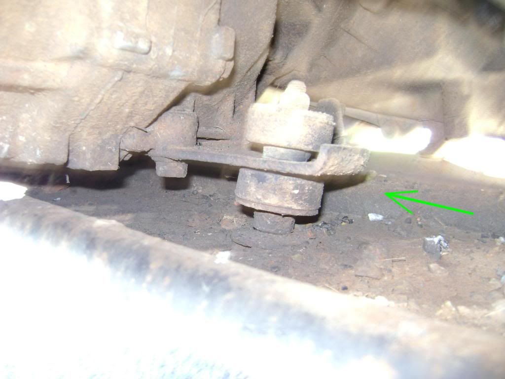

I concur, there should be a rubber brickish thing(best way i can describe it) under the transmission adjacent to that bolt.

Originally Posted by Jesse_87 View Post
Does anyone have a pic of this?
http://www.jeepforum.com/forum/f12/t...cement-903109/
Check this thread it will show you what it looks like and how to put it on.

I see what you mean.

you have it, its more under the tcase... you can see the recessed bolts from the bottom.
These guys don't know what they're talking about. You would know if it was missing everytime you accelerated and the shifter broke your knee cap.

Um, no. It's definitely not there.
my jeep was the same way. yes it is.
does that look anything like his setup?
You can't go telling people that are trying to learn about this stuff things like that if you don't know 100% what your talking about
