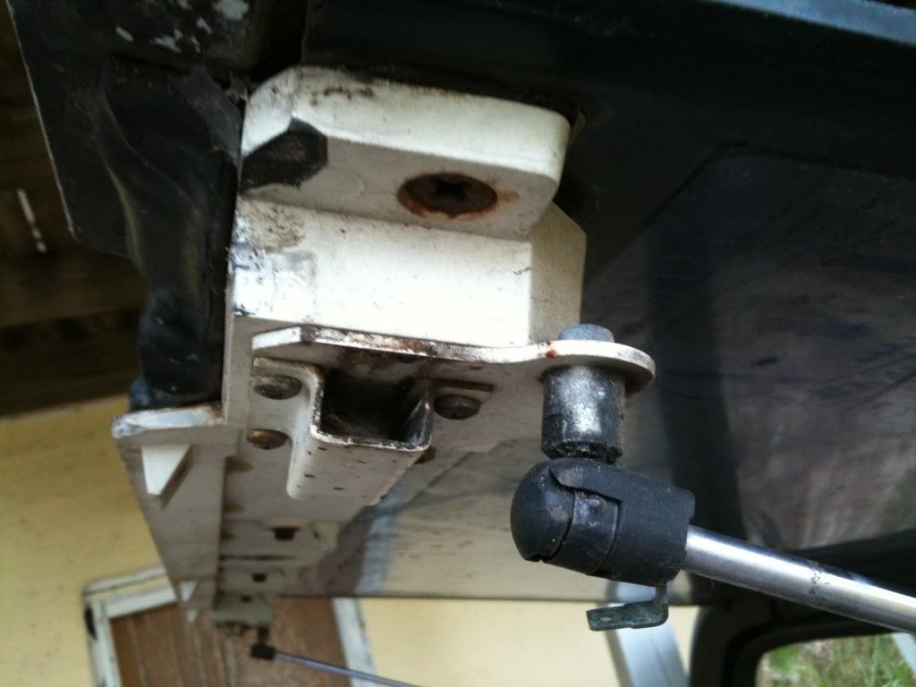

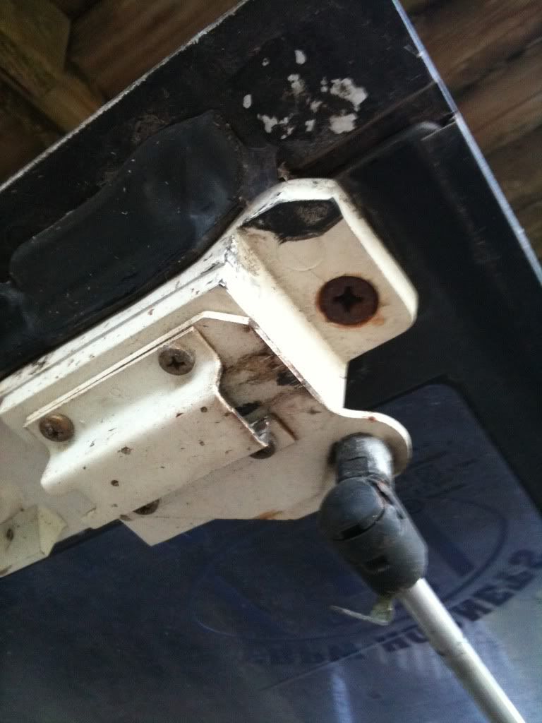

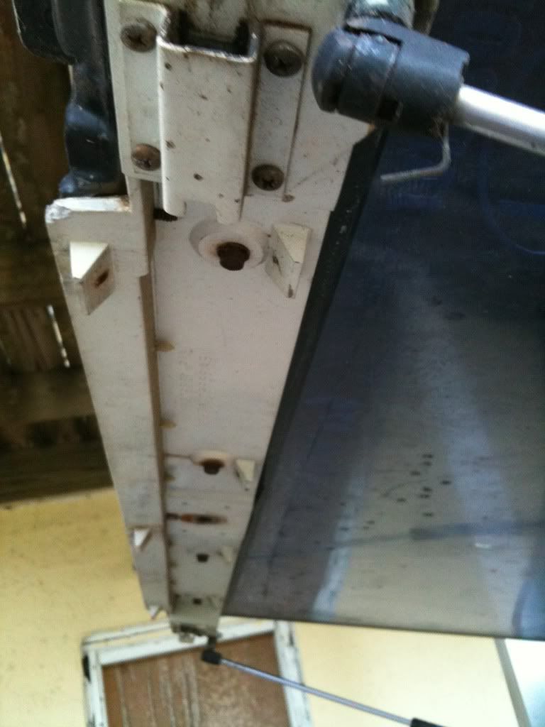

I broke my liftgate glass a couple weeks ago, It had the wiper motor and defrost. I never used them. A guy I work with had a frame broken YJ and said I could have his liftgate.
When I got it this weekend it was the type with a chrome handle and mine did not.
His inside fiberglass shroud was broken on both ends and mine is almost perfect condition.
Mine seems to fit where his came off except where the two latches come out.
Can someone take a photo of their shroud where the latches come out for me?
I attached the good one and bad one.
Thanks.
I could not take advantage of a free glass from another Jeeper so I offered him my old RCBS reloader.

Thanks,
I was wondering if there was a cutout on the side of the shroud(cover) where the latches come out.
When I put mine on the new glass the latches get stuck.

That looks like a CJ lift gate. The YJ top closes inside the tailgate. The CJ gate closes outside the tailgate, thus the need for a handle and latches to keep it closed.

The easy and simple fix is to remove the latch pins, springs, & cables and leave the handle. Then install your newer style cover on the inside.

Thanks everyone, I looked at the link for CJ and YJ tops.
The glass I got does have the groove for the YJ to close the gate and I am going to remove the cables and leave the handle.
Since it's laying flat, I'm also going to retint it.
