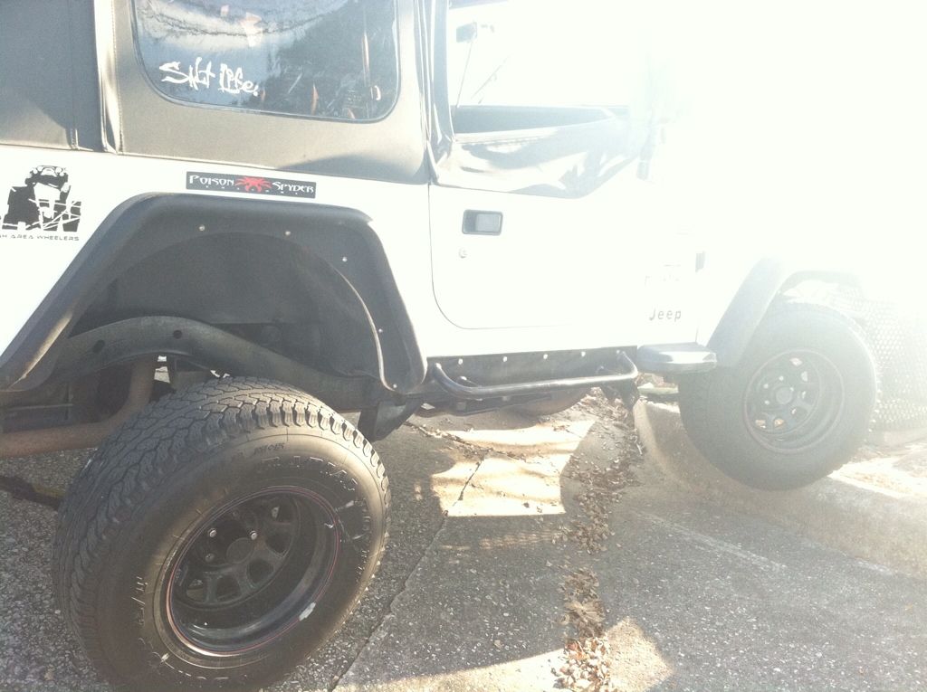

Actually, I did my entire lift for $350. Springs, shocks and tcase drop.
Superlift 3.5" springs=$225
Ford truck shocks via autozone=$90
Tcase drop=$15
Rides MUCH better than stock and flexes great off road.
They aren't bds but they work for a budget.
You simply won't hear much about Superlift springs because people stay away from them due to the price being so cheap. Naturally that's what drew me to them and I am pleased with my choice.

I've had mine for just under a year now with no sagging
How's this for flex?
And as for the shocks. They're good for a budget, but I'll be upgrading them when I need to. You can find the correct years of the trucks though if you look in my build thread.
Sweet i will defently be looking up your build thread from my pc later.
And thats pretty good flex.
