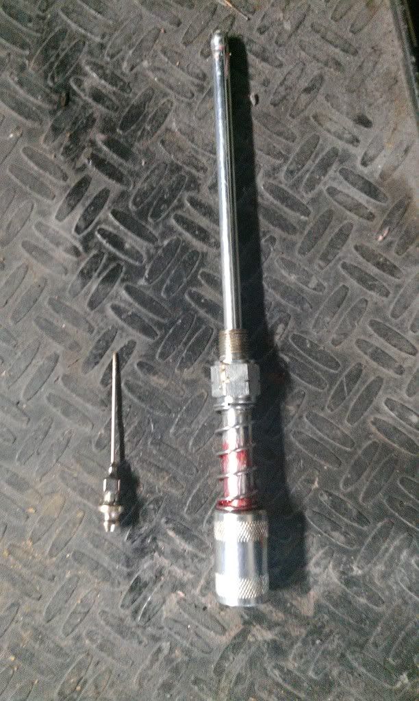

I use a needle zirk for pretty much everything if I can - mines the same as Grandboost's on the right;
Originally Posted by grandboost98 View Post
Very informative! I grease up after every wheelin trip since mud is inevitable around here which ends up being a couple times a month.
Ill see your injector tool and raise you a needle injector
but what's that on the left? is that for putting grease in a basketball???
#theneverendingaxe
HaskiE is offline
post #72 of 99 Old 02-05-2015, 08:39 AM
grandboost98
Location: Essex
Posts: 4,195
Thats a needle injector. I think its used to pierce through whatever it is youre trying to grease. Like something without a grease fitting like a CV boot or lower ball joint
CV Boot! gotcha.

Trying to hold the fitting on the zerk and then using two hands to pump the gun is a mess waiting to happen. Besides, the one handers gives you a sweet Popeye pumed look. All forearms! Glad I use it as my workout since my other one was leading to blindness...
The needle adapters used on the hose and then using a two handed grease gun literally takes four people to operate and even then it still makes a mess. I would highly suggest to everyone to get a mini gun and putting the long needle attachment screwed into it, not fitted with a zerk coupler. Just plumb it on there. You'll have a lot more control over your grease and not end up ten miles down the road trying to figure out what that smell is.
[hint: it's grease slung off your rear driveshaft onto your exhaust]
