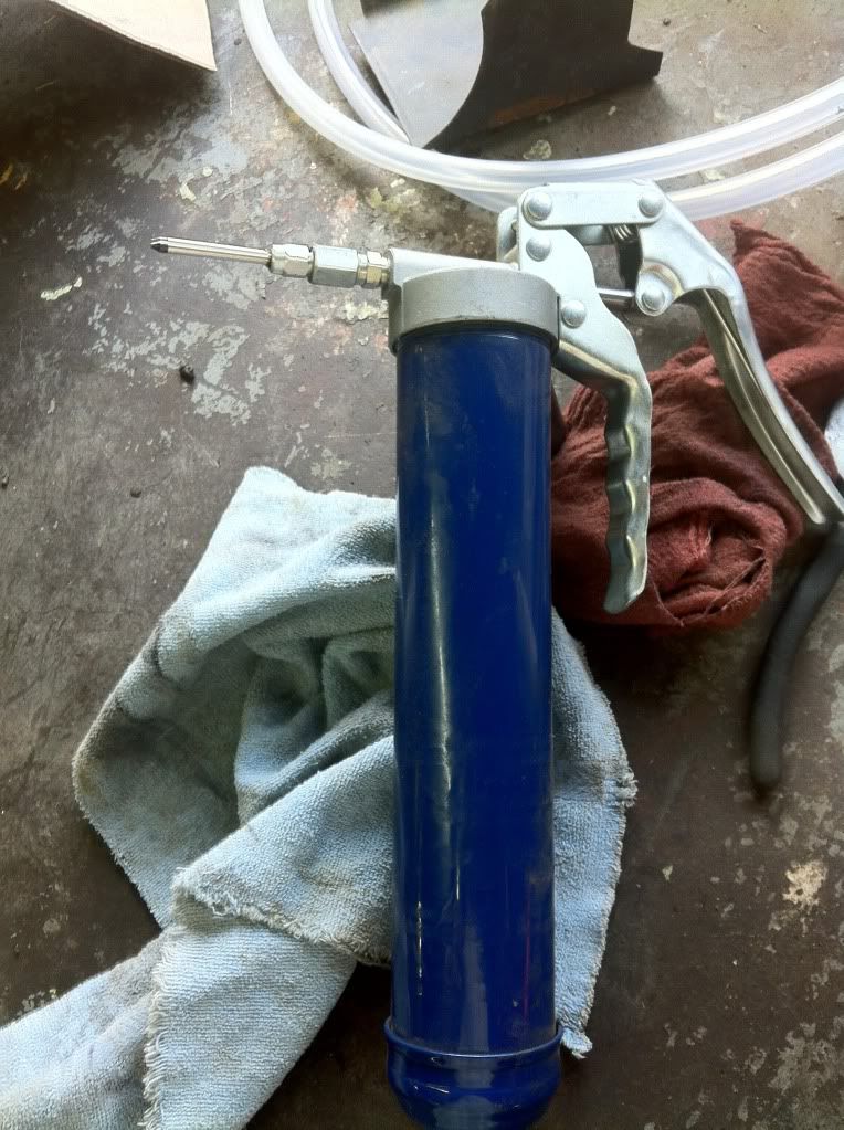

Spent a couple bucks for a second grease gun specifically for greasing the needle zerks.
Its a good time to get out and grease your jeep.

It's been a couple months. Get out there and grease your jeep.
I had a hard time with my cv joint.
