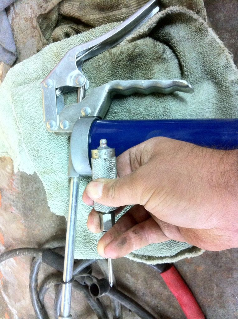

As a dedicated gun its not a terrible idea if you have the room in your garage or shop. I, personally, do a lot of greasing on a weekly basis and only run one gun for the farm equipment and occasionally use it for the jeep. I opted for the adapter above but if you wanted to go with a dedicated gun I would suggest going with the straight pipe because there is a lot of pressure needed to make sure the grease enters the joint. And yes, the Lincoln threads are all the same, I checked.
You would thread off the zerk adapter and thread on the tube starting where my ring finger is. I pulled back the sleeve to show folks how it works. And all the heads on the Lincoln guns are adjustable for grip on the zerk fitting itself. All it takes is the twist of the tip.

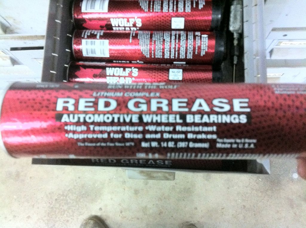

As for grease type, you'll want something high pressure, high temperature and water resistant. The cheapest stuff I could find was this bunch and it has been working just fine for a few months now.

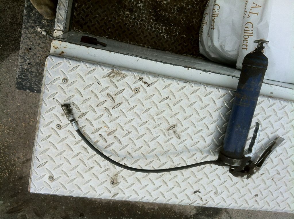

As for the gun I prefer, it looks something like this. Or exactly like this.
Remember that you only need to squirt grease to expel the water until you see the new grease push the old grease out. You don't need to run a tube of grease through each zerk to be effective. And remember that some grease is better than no grease. Even a couple shots makes a big difference.

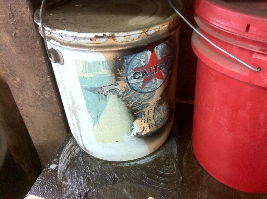

Eventually you will realize that it is an addiction, like I did; Then you will buy the bulk refill 5-gallon pail and not bother with those wastful little cartridges anymore. Just keep a box of rubber gloves around for re-packing the guns!
It's not pretty, but it was cheap! I use the 5 gallon tub for repacking wheel bearings

Forgot to mention, the brand of guns and accessories that I'm using is "Lubri-Matic" they have been around since forever, like 1921 or something. I'll prolly pass those guns on down to my nephews when I die or something. FWIW I totally agree about having the straight pipe on the needle gun. I have to find the red stuff and try it sometime - I have the moly EP marine stuff in these because its what worked best for me.

The red stuff is nothing to seek out, its the bottom of the barrel in my arsenal of lubricants. But for a jeep, they'll pretty much all do the job. It's not like we are running serviceable radial ball bearings on our vehicles. The types that see over 1000 rpm need special grease, jeeps really don't. Just make sure that its not going to corrode your tie rod boots and is automotive safe.
