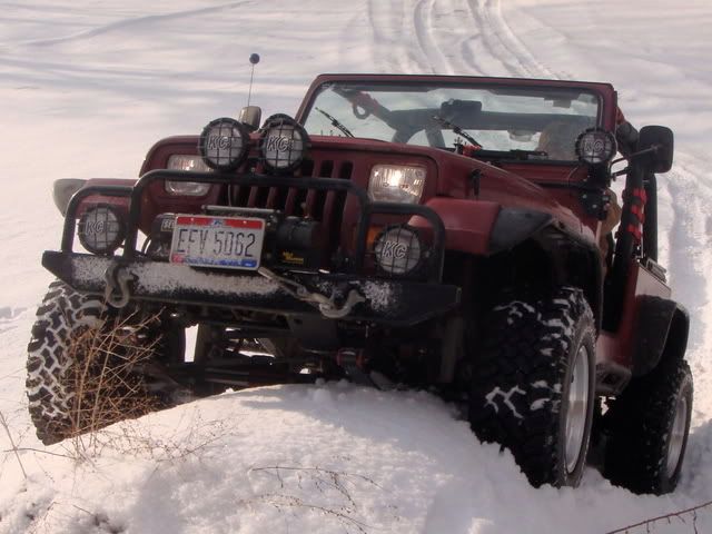

Mines 2x5" rectangular tubing, with some heavy sidewall 1.75" tube bent at an autoparts store. Their exhaust pipe machine was just strong enough to bend the tube, but they probably won't do it for anyone, I jsut have hook ups since my dad used to work there. Then I had it powder coated. It's a pretty beefy front bumper, it weighs about 150lbs.
