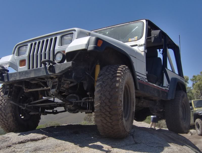

Heres my bumpers. both are 3/16" steel. i think 3"x5" rectangular tube if i remember correctly. built em a long time ago. Both bumpers are sealed and plumbed for air and are my air tanks for my OBA system. the D-ring hangers on the rear came from Poison Spyder Customs and I plan to eventually cut off the solid mo9unt rings on the front and put this style on it as well.
For mounting, the front bumper is actually mounted on the stock front bumper. I cut the stock one down and welded it to the back of the new one and used it as my mounting bracket. for the rear I cut out the stock tin foil rear cross member and welded it directly to the frame rails

Originally Posted by rustywrangler View Post
Typically one has a compressor on board with the tank/bumper. I advise against those honestly.
out of curiousity, why do you advise against this? I think its a great idea and I have never had any issues with mine. Its a hell of alot better than trying to find a place to mount an actual air tank and have an air tank take up alot of already limited space in a YJ

Maybe becuase if somehow you puncture the tank/bumper you no longer have a tank full of air?? I thought about this idea as well a loooong time ago but decided against it. Im not saying your wrong for having your OBA tanks as your bumpers, cause your jeep is sweeet! But what would happen if you were to fall on a rock and puncture it? I know its thick steel and it aint gonna break it but anything can be punctured.

i agree with that but if it ain't happened to me yet, its probably not going to. I'm not exactly gentle with my YJ. and if the steels thick enough you really shouldn't have to worry. Also I don't keep my tanks full at all times. I only use them when I need to fill my tires or run air tolls and usually the YJ is standing still at that point. as for puncturing a tank and making my system useless, well I have 2 tanks so I could just cap off the line to the punctured tank and use the other one until I can get the broken one fixed. But seriously, I've come down very hard on my bumpers numerous times and got nothing more than a few scratches.

well then good deal Just for those building a bumper like this, make sure its completely sealed

and that is the very hardest part!! took me hours to nail down all the little pinhole leaks. best way to do it is to hook the tank up to your shop compressor and spray it with soapy water, then use a grease pen or sharpie to mark your leaks then just keep goin back and spot welding over em until you get them all sealed up
