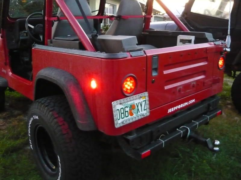

I wired the side marker lights up today, they are really bright!
They are wired only to the park light circuit, so they do not flash with the turn signals.
Here's the run-down on the wire colors on my '91 YJ's tail lights.
In the factory tub wiring harness
Left side
gray/black = brake & turn
blue/red = park lights
dark green/brown = reverse lights
Right side
gray/red = brake & turn

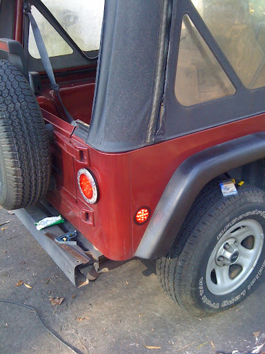

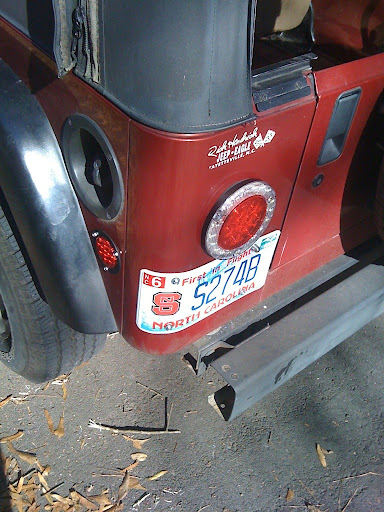

Location: NY
Posts: 48
Got these installed and wired up - I like how they turned out. My side markers are pretty bright like some of the other peoples on here, but it's fine:
Passanger side:
Picasa Web Albums - srsterno
Drivers side:

post #21 of 39 Old 01-02-2010, 04:08 PM Thread Starter
Mean Max
Don't poke the bear
Mean Max's Avatar
Location: Stuart, Florida
Posts: 13,734
Passenger side:
Driver's side:

are those reverse lights around the taillights? those are pretty sweet!
Dustin_95YJ is offline
post #23 of 39 Old 01-19-2010, 06:32 AM
srsterno
Location: NY
Posts: 48
Sure are...got them from here:
Hose Clamps, LED Truck Lights, Heavy Duty Truck Parts, Wire Loom, Trailer Parts, Fuel Warmers, part no MX-M85429R (50.79 ea). If you go this route, be sure to get 2 of the 3 pin harnesses per light. I only got one for each light and ended up having to make my own harnesses for the other two. It's not that difficult, just time consuming and a little less clean of an installation.
I really like them though, and they are a cheaper solution than the other intregrated SST/R product out there (although you have to drill another hole for the side marker lights).

i like those side boxes you have in the back do you have more pictures of them. did you make them or buy them?
Timmy69 is offline
post #30 of 39 Old 01-22-2010, 11:50 AM Thread Starter
Mean Max
Don't poke the bear
Mean Max's Avatar
Posts: 13,734
I like them too. They are (were, really) sold through Bestop brand products and the name "Rough Rider" is imprinted on the lid. I purchased them a long time ago from the closeout section of Quadratec. They are no longer available from Bestop, so finding them is next to impossible.
If you hurry to Collins Brothers Jeep, they did have some listed in their "Closeout" section, under the "Bestop" icon.
You can see the gray ones in my wife's '93 YJ here.
And more of my '91 YJ
Obligatory JF sticker picture.....
BTW, the ratchet strap is the product of the domino effect.
