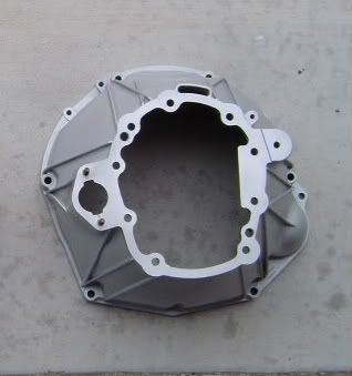

Are you having one sent to you? If you tell them exactly what you're looking for they should be able to find it.
You could send them a picture

No need for a new clutch, the throwout bearings are similar if not identical in diameter. Not a bad idea to replace the clutch if yours is old since you'll have everything apart anyways. Not sure what a ram clutch is but you can get a Luk brand clutch for much cheaper than $300.
