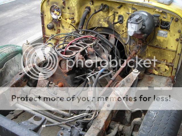

so basically all my under hood electrical is FUBAR and i have no idea the condition of the vacuum lines because the ball is missing , i managed to get a newish wiring harness from a buddy of mine with the "nutter" already done but some of the things that are broken are confusing me.... for example:

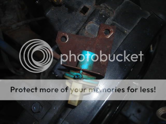

what is this, someone told me that all it dose is turn the "idiot" light on the dash when your 4wd is activated, if this is the case do i need it? (it had a vacuum line attached to it and a broken wire. it was located on the firewall just below the battery tray)

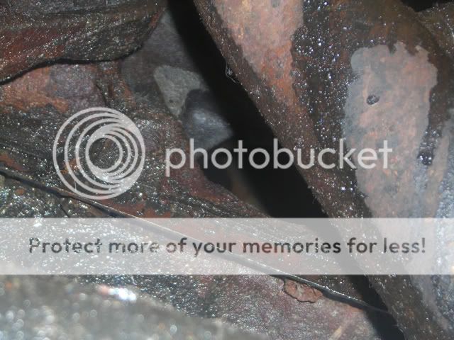

also the colored vacuum hard lines from the tcase all seemed to be intact except the blue one as seen here

That blue switch is indeed just for the 4wd light. You do not need it, but it is nice to have. If you want to leave it disconnected, block off the vacuum line that went up to it so you do not produce a leak giving yourself no 4wd.
The blue vacuum line with the saucer looking thing on it is just a vent line. it basically sits in open air like that so that when you disengage the 4wd, the vacuum in the system can be bled off allowing the actuator to relax. If you are going to be mudding or fording lots of water I would just stick some extra hose on it and route it up to a high spot to keep moisture out of the system and prevent rusting.

With your block open like that. And the inside rusting, Your motor is probably messed up. You need to have it rebuilt and maybe sleeves put in and all kinds of annoying stuff. If you are planning on putting a V8 in it anyways just rip out all of the wires and just buy the V8 wirring harness
