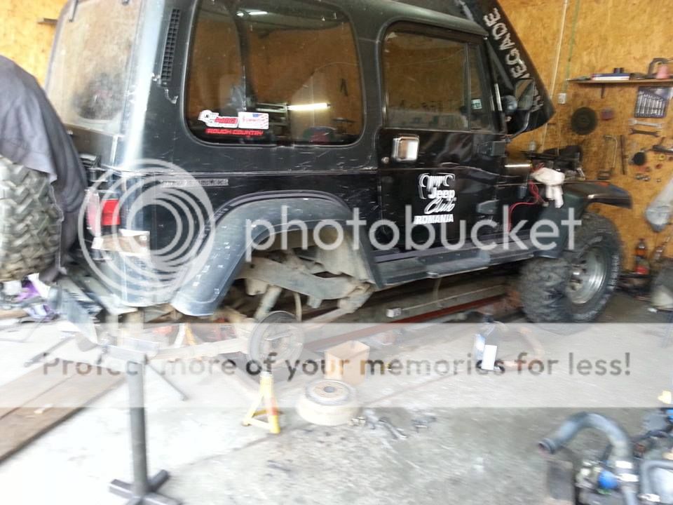

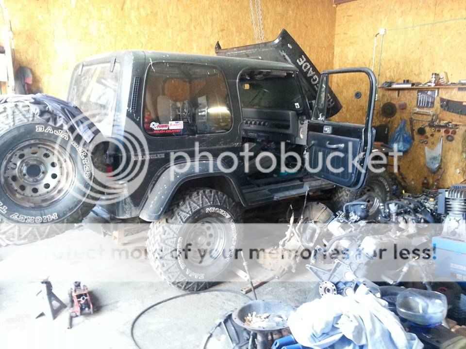

I have completed the new electricals and now Im putting in the 4.0 engine with a AW4 auto trans, hope next week Ill be able to get its first run
This is the status today... hope next week Ill show you it reassmbled

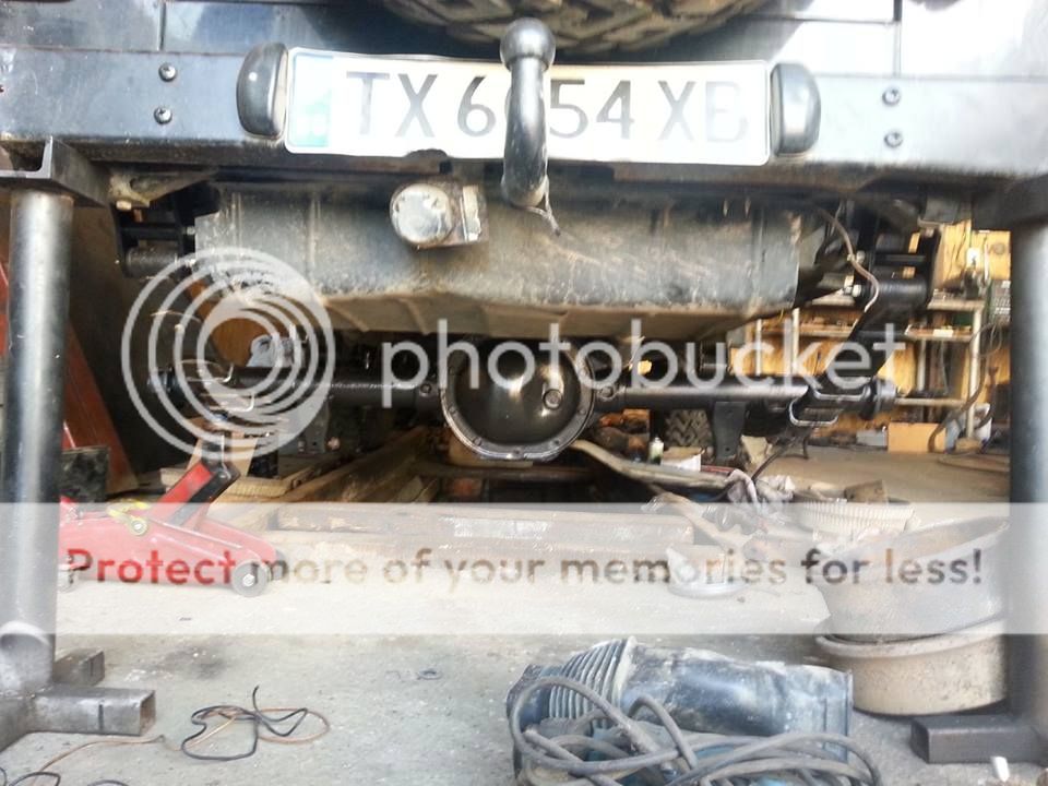

By the way I found another problem... the AW4 transmission is about 2" longer than the old BA10, so Ill need a SYE for sure and new shafts...
Also I begin to SWAP the D35 3.07 ratio with a 4.56 Chrysler 8.25.

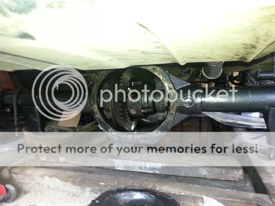

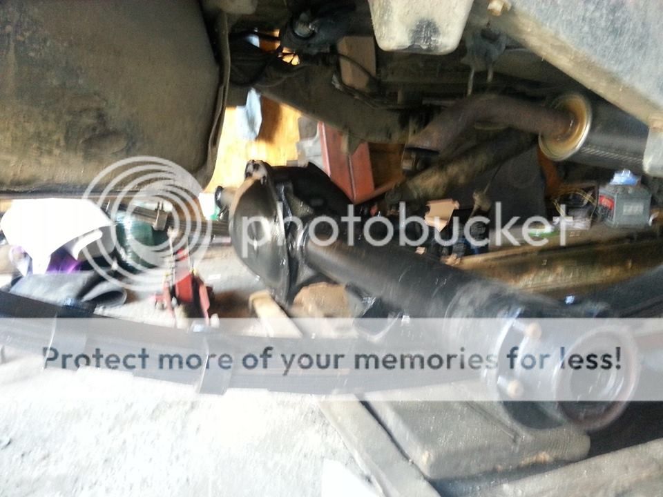

Ive began to swap my D35 rear axle with a Chrysler 8.25, not a great thing but better than the D35... here is really difficult to find stronger axles.
Ive got the 8.25 allready installed, but when I opened it I found that its a Track Lock version, not open carrier... ....... not good because I planned to install a Spartan Locker and now I will need an open carrier for this....
