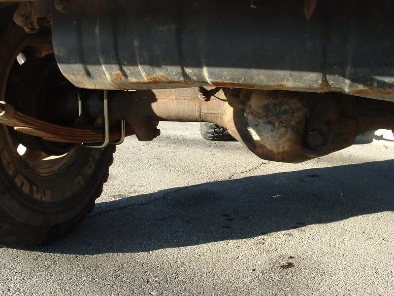

Helped my buddy do some mods on his JK Rubi, noticed his front driveshaft looks like this:
The part that goes between the axle pinion yoke and the u-bolt is what I need. I have found Currie's "companion flange" that looks like it, but it is for 8.8 Fords.
Anybody know a part number for this animal?
