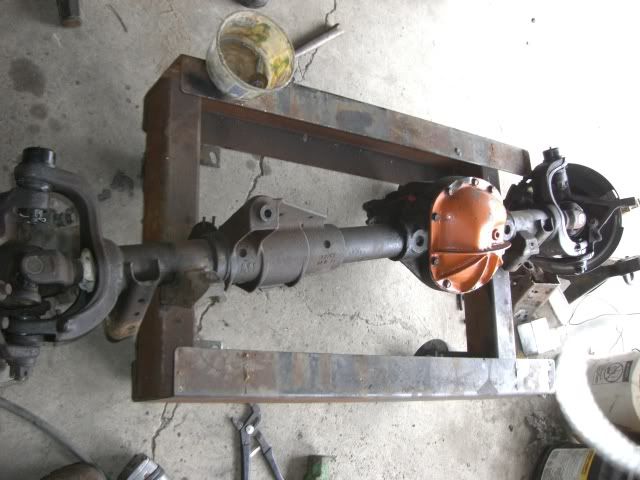

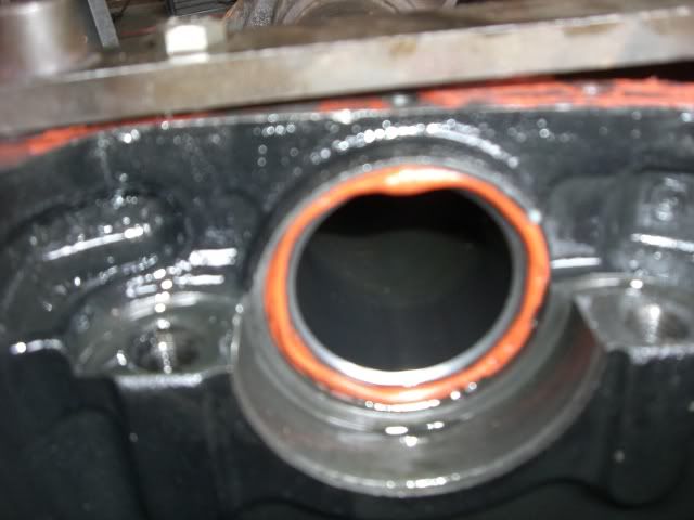

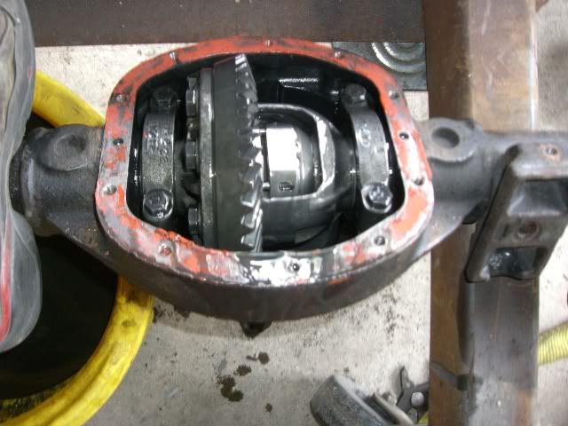

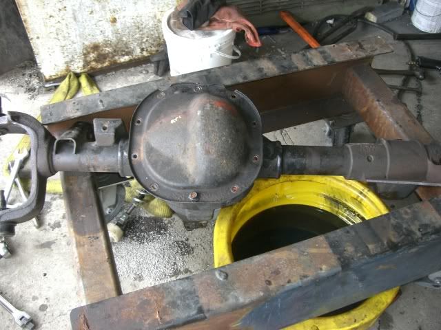

aaronc88wrote this up in his thread but im putting it in mine, waiting for my springs to come in we started working on the 30. Took out the axle shafts and then knuckles, also pulled the carrier and changed the axle shaft seals. Wile we were changing the driver side seal we also installed the seal to allow for a one piece Cherokee shaft to be installed.
Lockright locker already came installed from previous owner.

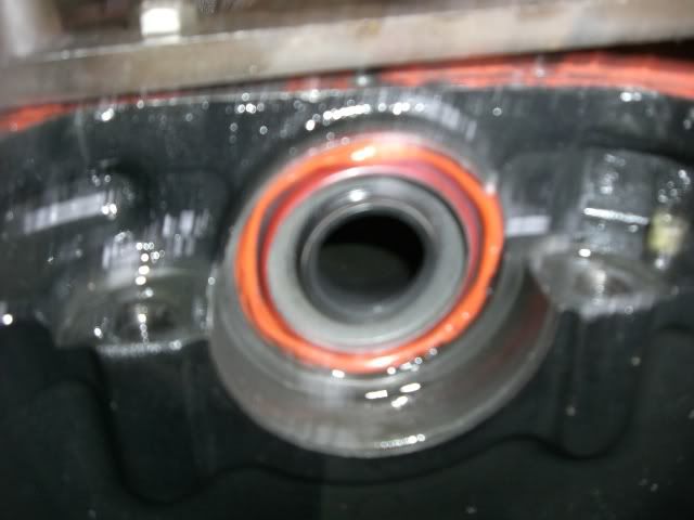

The inside of the axle tube. This seal fits in without any grinding of a seal boss, unlike the seals that some people use to do this conversion.
(yes that is an 8.8 cover) just using it to keep out the dust.
