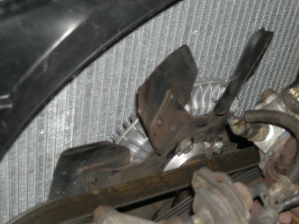

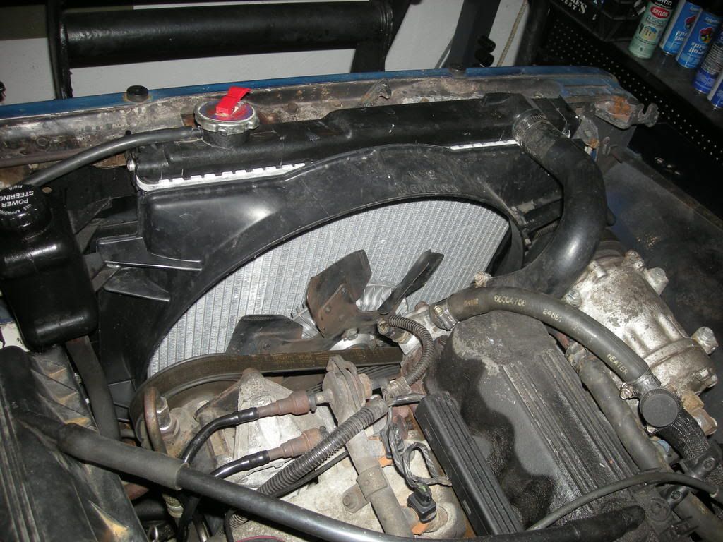

Here is the new fan installed. This is off a 93 4.0 looks small but I think it will do the job. To bad now its cool out and in the 60s and the hood it off it but it did seem to run at 210 in the driveway. I let it run a for a while. Ill have to put the hood back on and take it for a drive to see what happens.

If I am not mistaken your fan shroud could be the cause of your overheating problems.That isn't a fan shroud for a YJ. I think it is for a 4cyl Cherokee or Briarwood and that would make it overheat for sure
EDIT:
See if you can find this part number on it 5300 0015. If so then it is for a cherokee.
Part number should be 5200 4214-1. And the ahroud completely encases the fan so you can not see it from above like your can be in your picture.
EDIT:
Well this shroud came right from the dlr. They looked it up and said that was the one I needed. The 4cyl is bigger and encases the fan totaly. I have the 6cyl.
I think its the new 7 blade fan making it look bigger. Not sure why but the 5 blade fan blades I had on there before were bigger. Not sure if that will hurt things or not. The yard that I got this from said it was off a 93 6cyl wrangler.
Not sure why Jeep would use a 5 and a 7 blade fan on these things. It does seem to be pulling more air and pulling it the right way. I guess only time will tell.
EDIT:
I have to agree with laybackman, the one on the picture isn't a fan shroud for a 4.0L. The space between tip of blade and shroud should be less and the shroud doesn't look like an original one. Go by the jeep dealer with the partnumber laybackman supplied and get a good one. You'll see the difference immidiately.

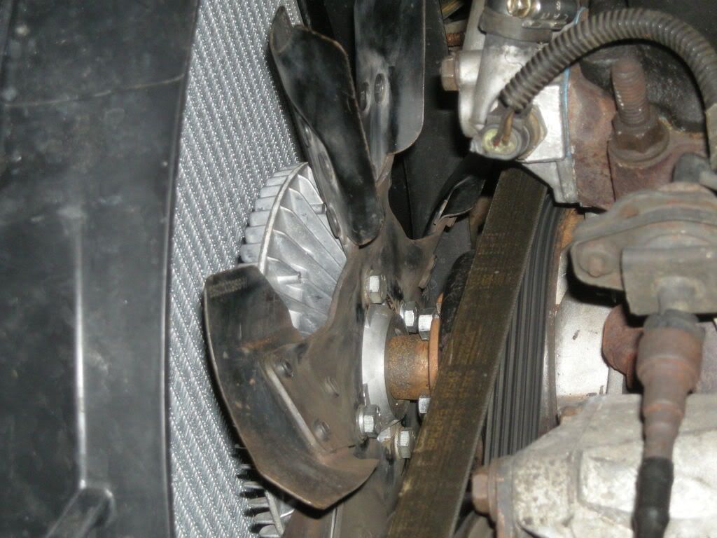

My shroud on my 91 is stock and looks identical to yours. My fan blades (which are stock, also) are larger than yours leaving only 1 inch between tip of fan and the shroud. I took some pics but am having trouble sizing them. I'll do my best to get them up tonight.
I work on a lot of 4 bangers. They use that big shroud. I am certain your shroud is Ok. Fan does not look right.

The fan is off a 93 wrangler I was told by the salvage yard. Mine use to have a 5 blade this is a 7 blade. if you got pictures post them to photobucket.com.
I have been searching for someone with a 6 and the right fan to post pictures.

Here are the pics. It is a five blad but notice it is larger. I have owned this jeep since new. Never changed fan or clutch assembly so I know it is right.
