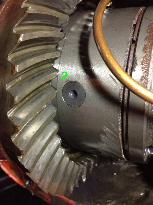

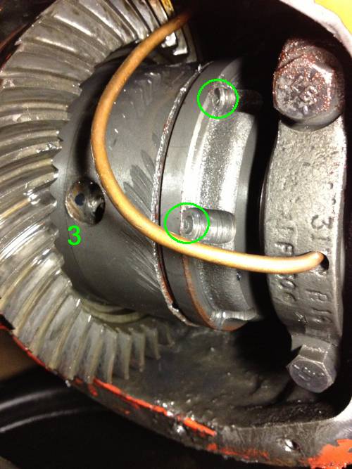

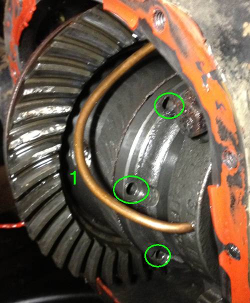

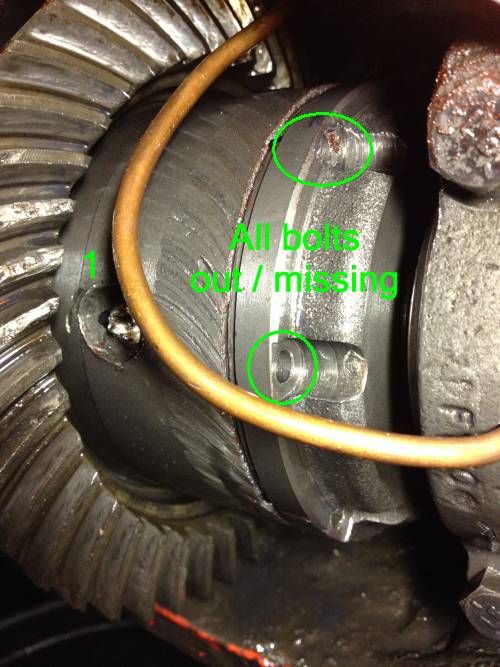

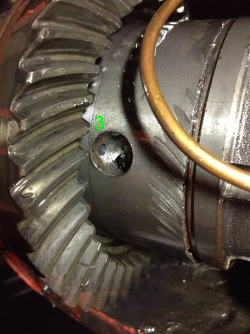

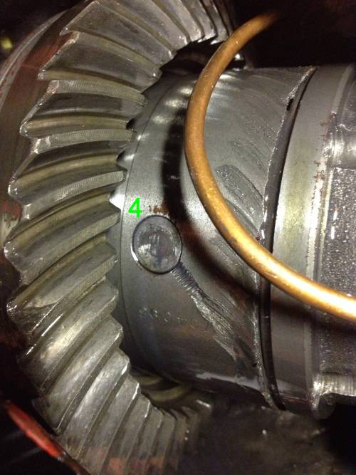

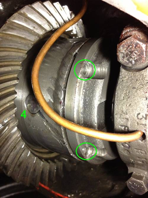

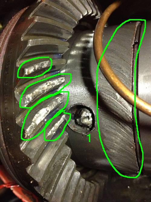

Update: I kept thinking it was the xfer case chain popping a tooth, but no. The front diff... ARB, ring gear and likely pinion gear went to lunch on themselves.

The first time - at road speed - but I forgot to disengage 4-hi while on asphalt - my mistake and it's set firmly in mind.

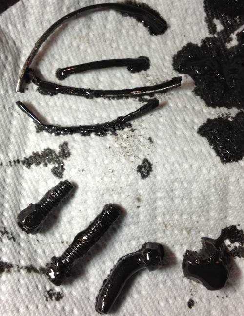

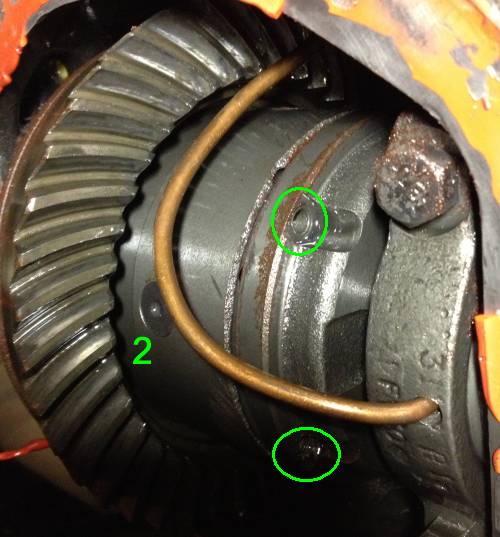

Carnage pix...

Front axle / diff.
Yes, expensive lesson - though I suspect the bolts were likely loose or mostly out when I purchased the Jeep a year earlier. When I purchased it, I knew the rear locker was toast (an expense known of right out of the box).
The PO said all fluids were just changed by a mechanic - so I figured no need to open the front diff to change fluid or inspect. Had I opened and inspected I suspect I might have found loose bolts holding the ARB together (and I might have been able to tighten and not be in this situation).
I'm not sure being in 4-hi on asphalt (re - drivetrain loading due to differences between front and rear wheel rotations) was the cause but I suspect having the front diff "spinning" faster than normal (trail speed is sub 15MPH) may have resulted in one of the "floating around" bolts being caught up in the flow of thick diff fluid (winter snow run) moving at a faster than typical speed (I have lockouts on the front hubs so the front diff doesn't typically rotate at all when I'm on road). I suspect one of the bolts was slung up and caught either between the pinion and ARB case (note the bolt threads impressed into the case near "pin 4") or between pinion and ring gear. That is likely when "the big bang(s)" first came about. From then it went downhill. I kept using it as it would only happen occasionally and I kept thinking xfer case chain, which I'd open/repair/replace over the winter.
