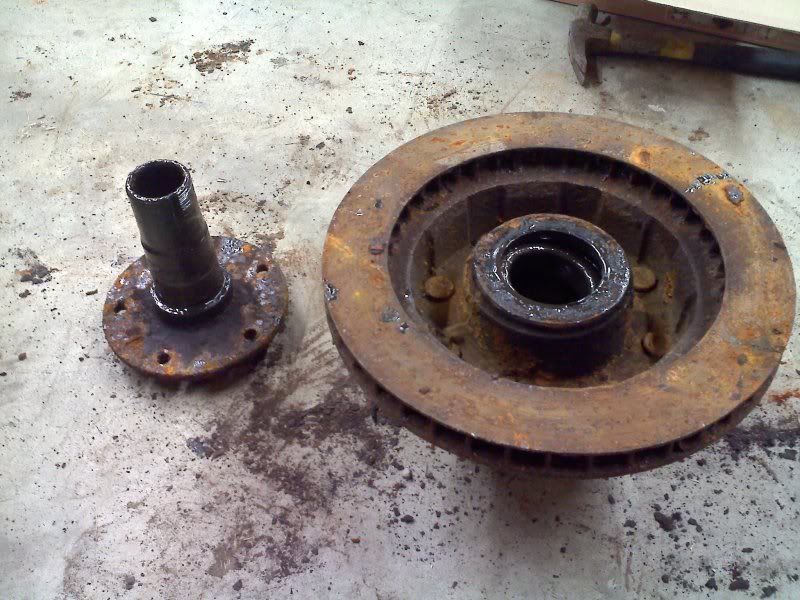

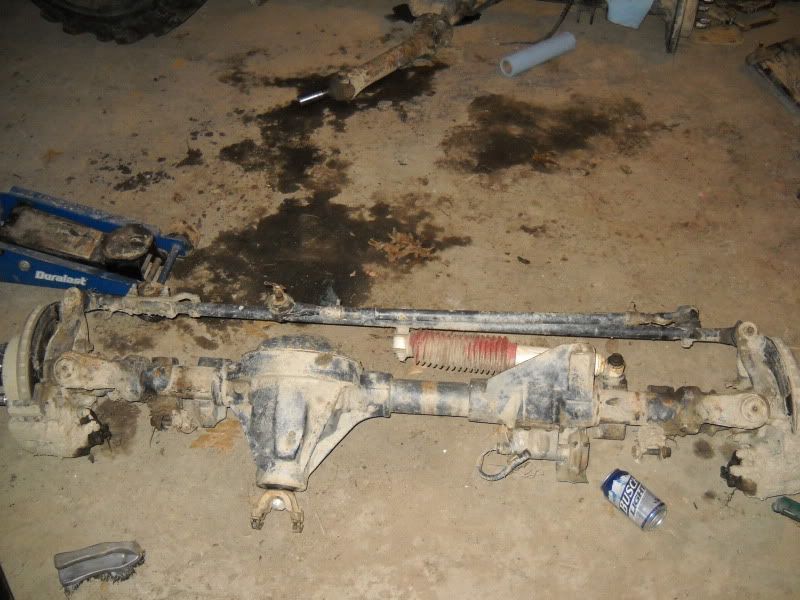

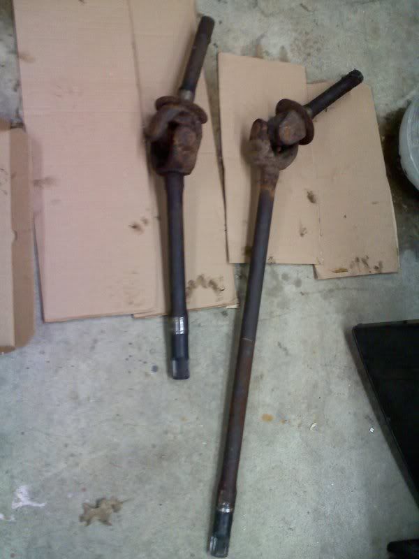

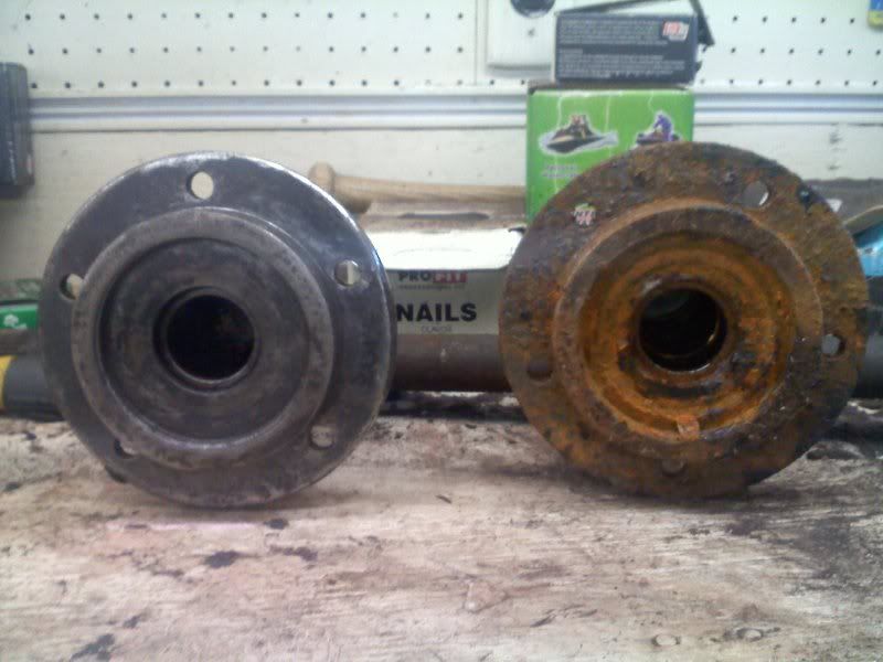

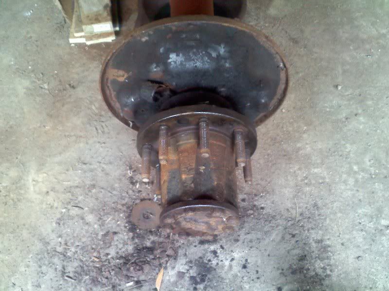

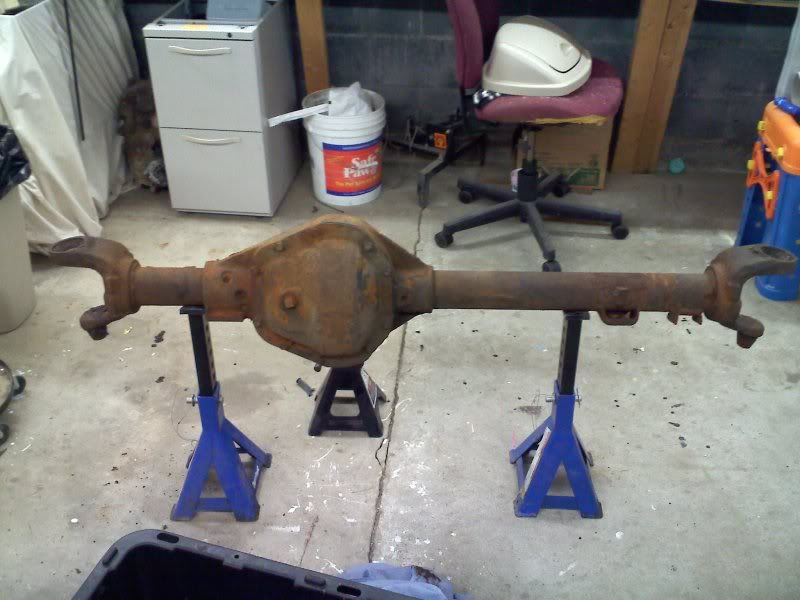

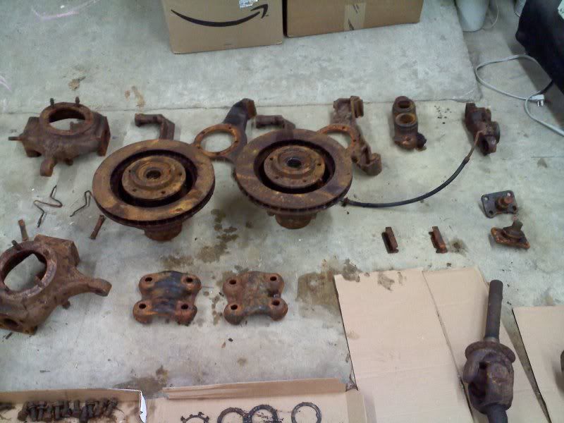

The High Pinion '79 Dana 60.

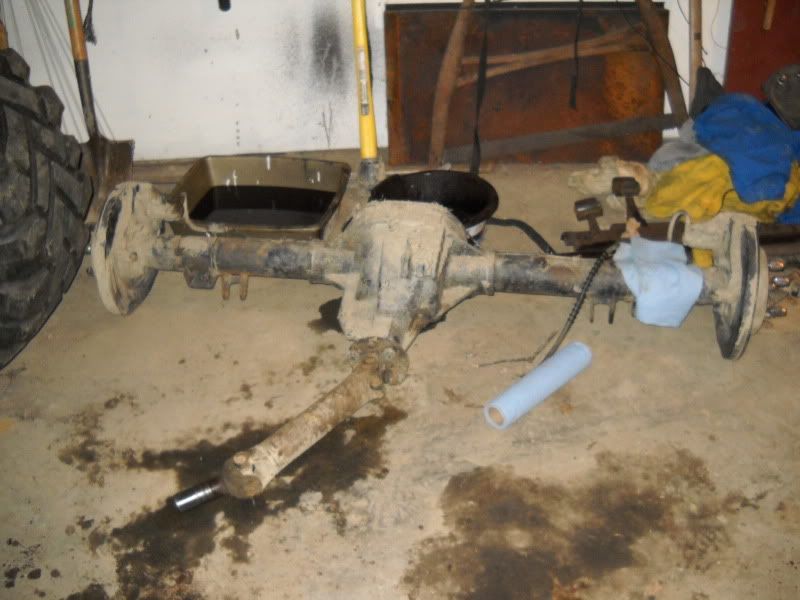

This is what I started with....$250 bucks

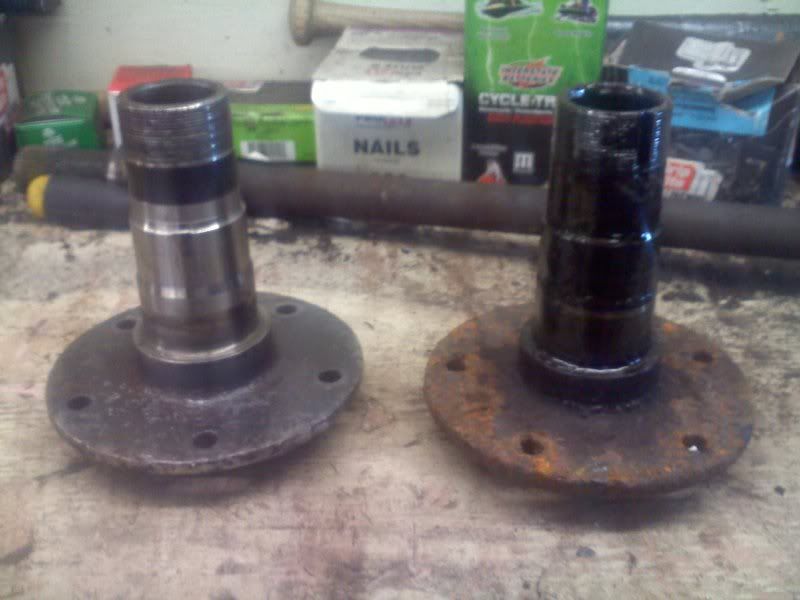

A stripped down axle that looked like hell

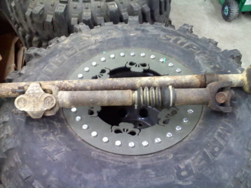

Shafts with Frozen joints

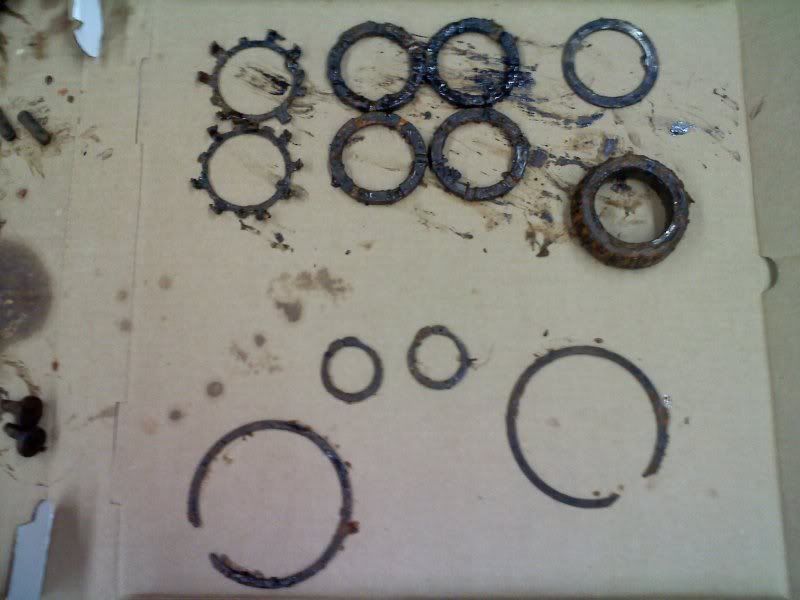

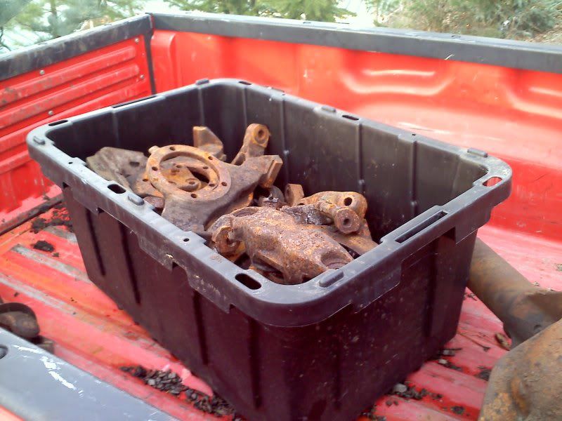

Lets see what was in the tub....

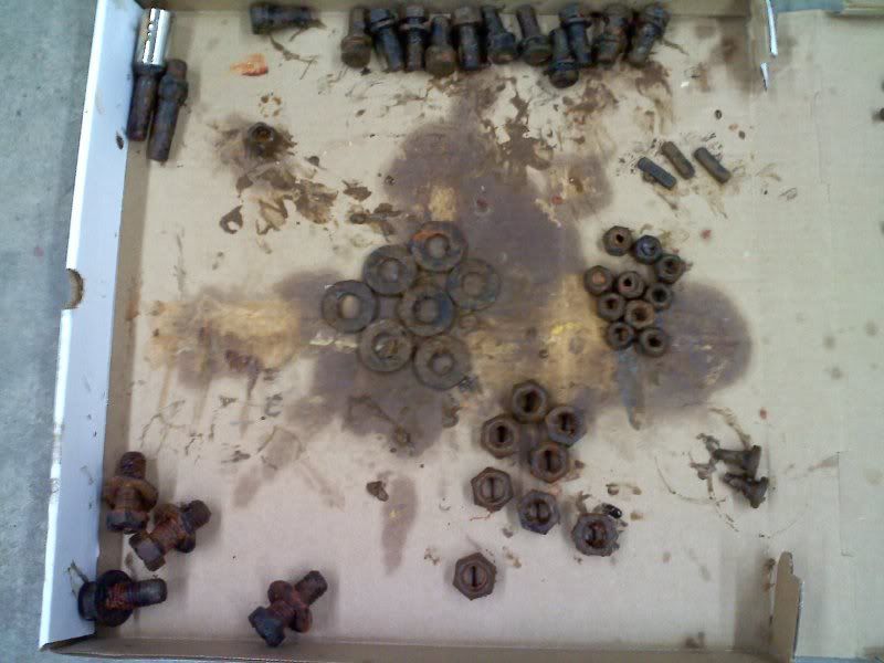

A tub of rusty parts I didn't even sort through... hey I got a free tub!

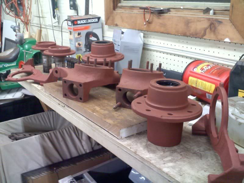

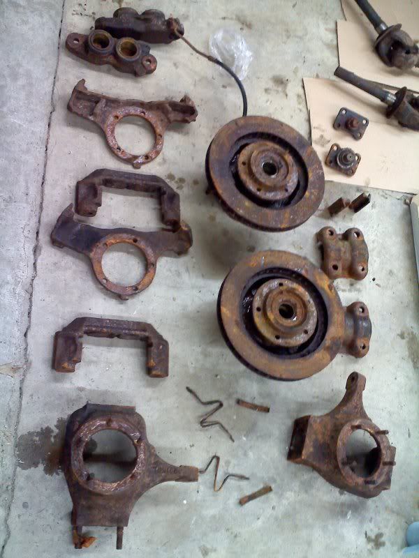

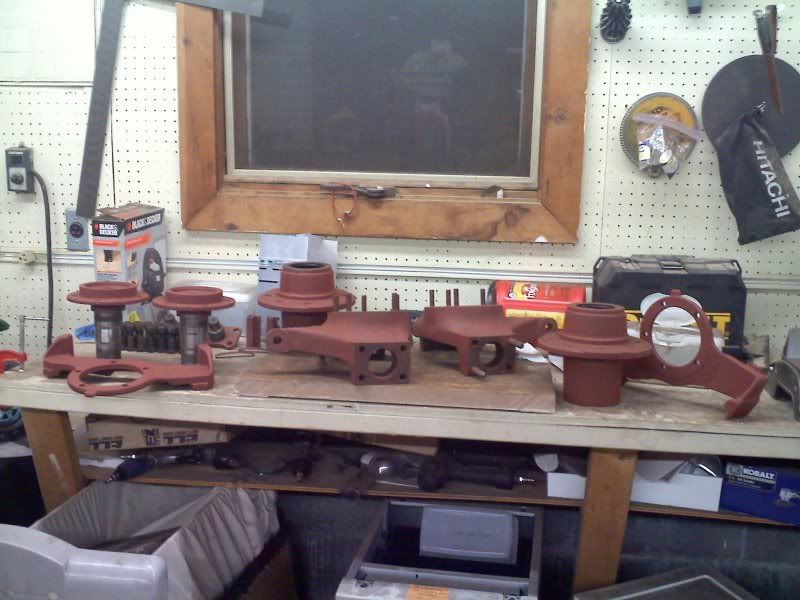

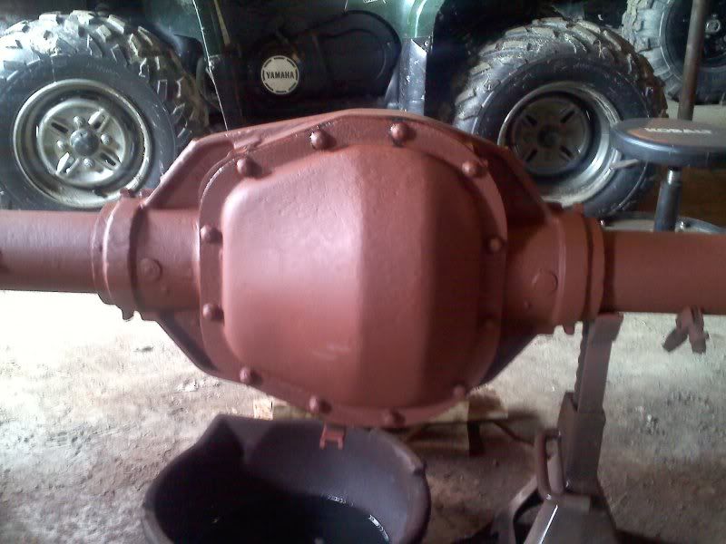

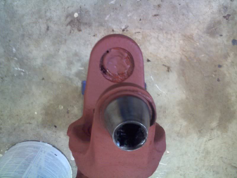

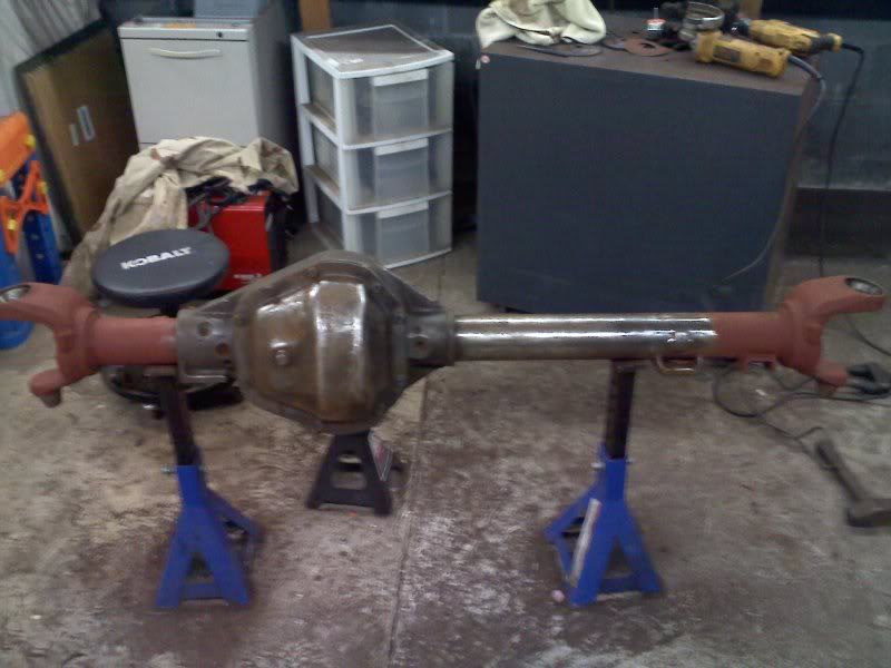

Wired and primed

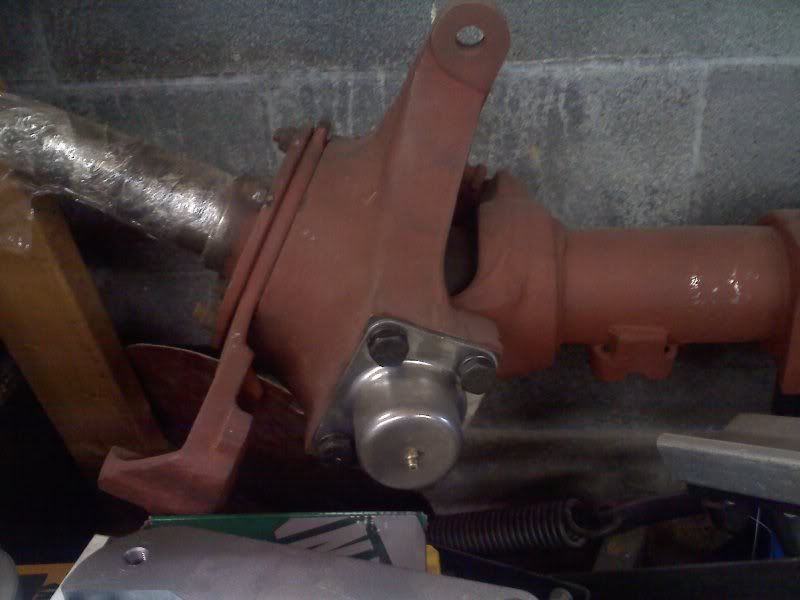

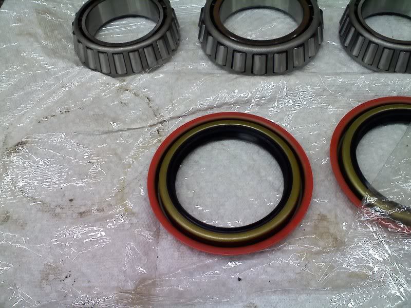

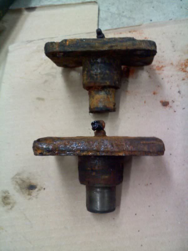

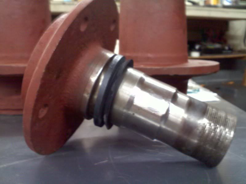

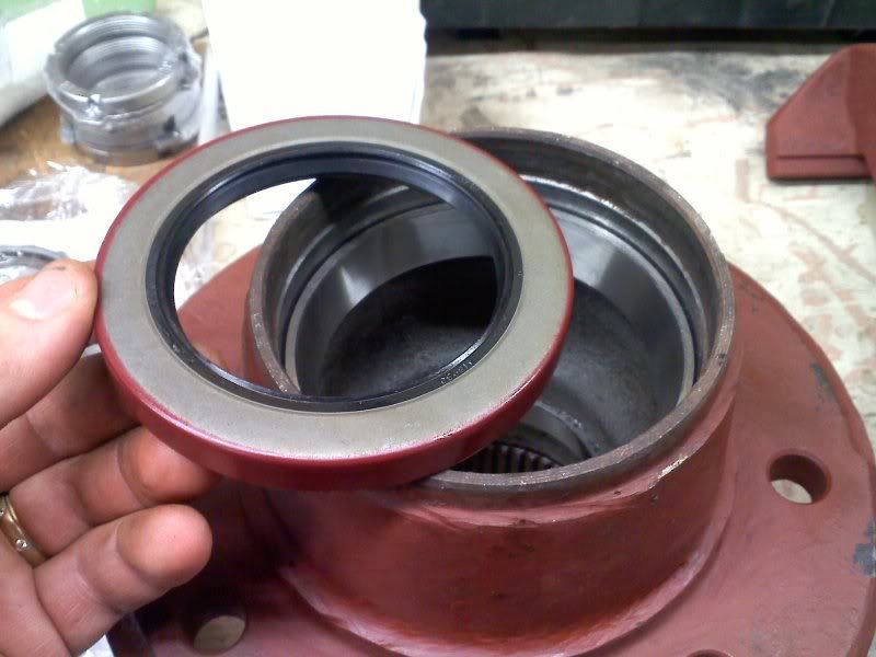

Rebuild King Pins
Random new bearings and all new races
front all rebuilt

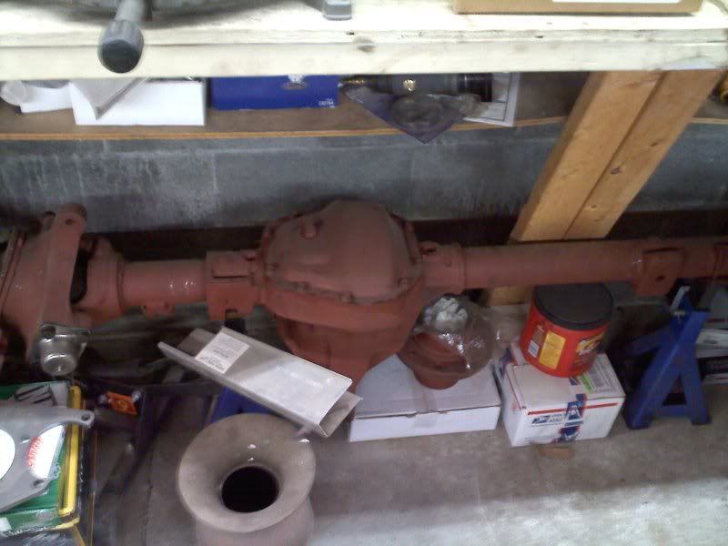

Parts keep showing up

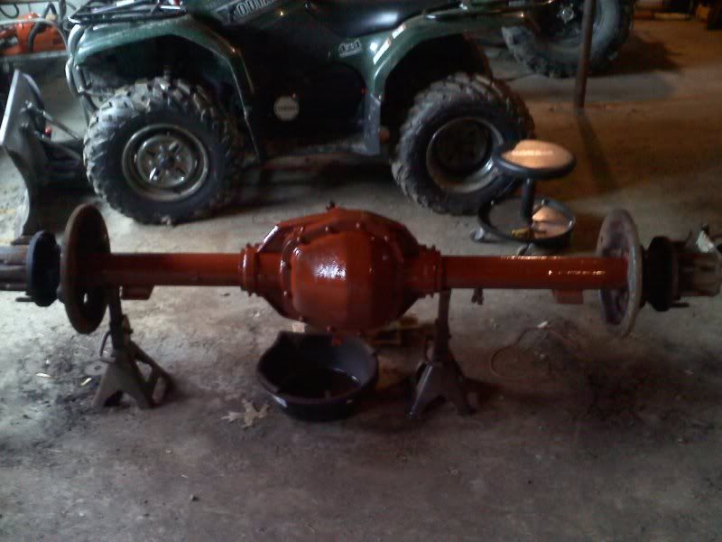

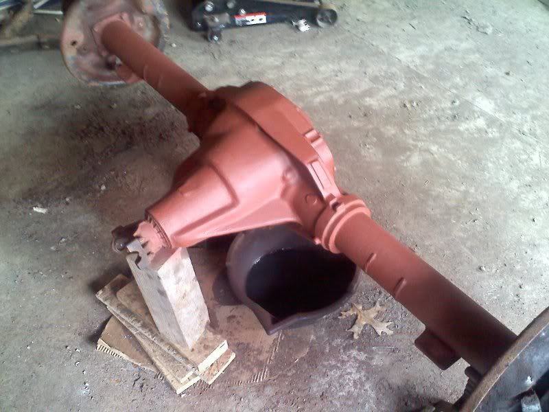

The F350 '93 Sterling 10.25
wired wheeled and primed

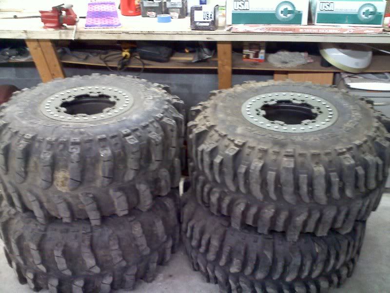

oooooo. 39.5 x 16 x16.5 beadlocked boggers

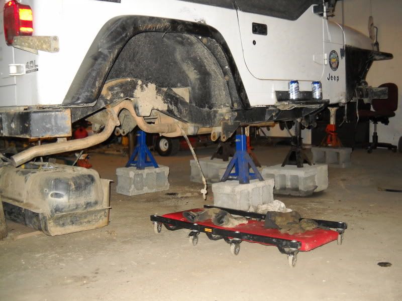

Tearing the YJ apart...
for sale...
exhaust will be in the way of the sterling stretched

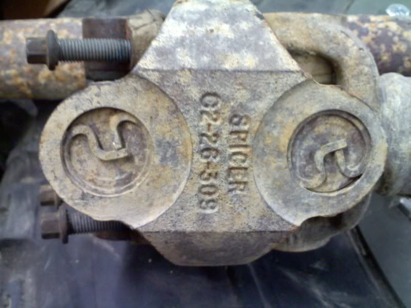

JB Super Short
Freebies that need to be cut and re-sleeved

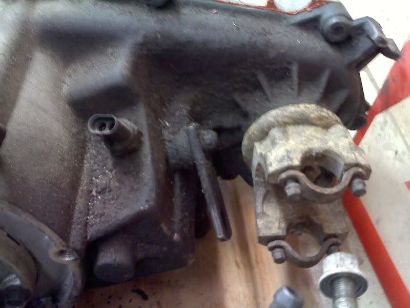

had to cut my skid off and broke 3 nutserts

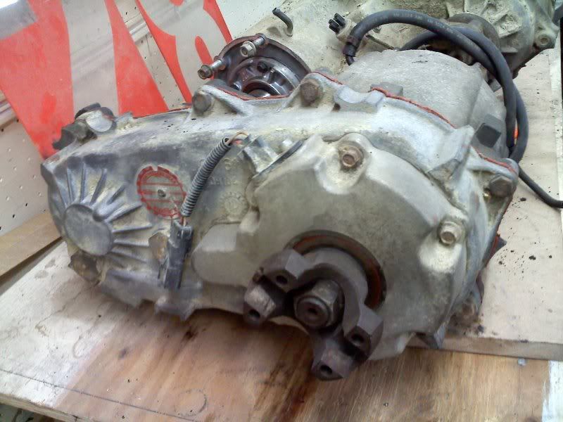

transfer case linkage will no be stock. the NP231 I got with the JB SYE, the shift arm is....upside down

You are an ambitious man Poke, wished I had that sort of "garage time!"
BTW the strength of those cinder blocks is with the cells up and down, just place a wood cap on to for your jackstands.
interesting. I was concerned wood would make it easy to slide around

I don't want to rain on your parade but you have a very unsafe, or accident waiting to happen in your garage. By placing your jack stands on the side of the cement block. The side of the cement blocks can take very little weight.
Turn the blocks so the holes are on top, then place a board over the hole and your jack stands on the board.
Right now you have about a inch of unsupported cement holding up your Yj. Be careful.
