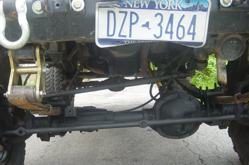

so you are saying those are cast steel not forged. and that is why people won't/don't weld them- because they would need to be preheated to weld and then heated to de-stress after welding.
In that case I would probably tack up the pieces and have someone at the local metal fab shop weld them hot and final because they can heat them properly. Last thing I would want is for someone to get hurt because my brittle steering knuckle shattered on a pothole...

Look on the JB4X4 web site it clearly says, "The stock YJ drag link will be too short to reconnect to the JB-RSB after installation. A new drag link can be assembled from OEM parts which is detailed in the instructions."
The solution is a longer drag link not a drop pitman arm. I used a drag link from a XJ cut it in the middle to the correct length in the JB instructions, butt welded it and then sleeved it and welded the ends of the sleeve, never had an issue and also run 1 ton TRE's.
I have the JCR draglink not a stock one. I wonder if the length can be adjusted out enough. Has anyone a good measurement on what a soa drag length should be?

If the issue was the length of the drag link your steering would only be limited in 1 direction. That was already stated earlier in the thread. Did you replace the pitman arm with the drop pitman when you installed the new steering links? If so, swap back to the stock arm (which was also previous suggested).

K ill buy stock pitman arm and try that. My jeep came lifted with no stock pitman.

Im not sure if this will help but my a old drag ling for this setup is 33 3/4 center to center of the tie rod end.

Not sure if this is helpful since I'm SUA? But in running the same 1ton set up... I am using the stock pitman and my turning radius is darn near the same as stock. Maybe lost 1/8 inch to the knuckle stops but hardly notice it in turning.

Originally Posted by fishadventure View Post
I know that bracket from JB is supposed to be the slick ticket but I have a question. Really two questions.......
Don't know, for the price it wasn't worth the hassle to me.
Plus I didn't wanna booty fab a knuckle and have it end up like this trying to get off a trail .....
Assuming you have the skill to do it, go for it and post up your results.
I understand that, but the JCR one is stock length correct? If you don't have the directions for the JB bracket, I'd give them a call. I would think if you explain the situation they'd be more than happy to give you the measurement you need.
The JCR draglink is just a piece of tubing threaded at each end right? If so I don't see why it couldn't be lengthened the same way I did mine. I mean it's your stuff so do what you will with is, but that's what I'd do.

I had to extend mine to get full steering
From the site:
The Drag Link:
That's a farmer fab. Those city boys didn't know what baling wire was or what it was used to bale.
I was referring to the pre-farmer fab fix that got him off the trail, the original way his PO had done the knuckle.
