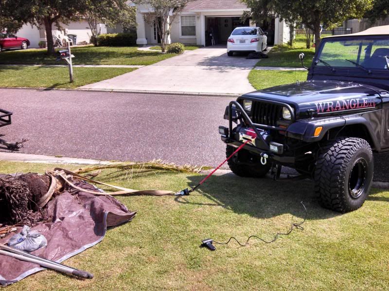

picked up some recovery today

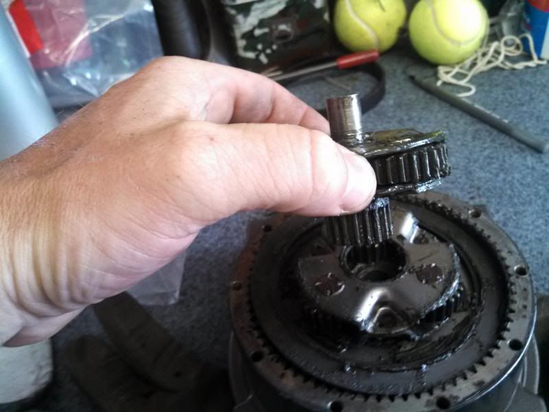

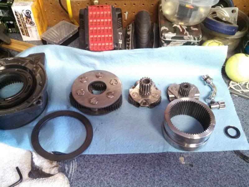

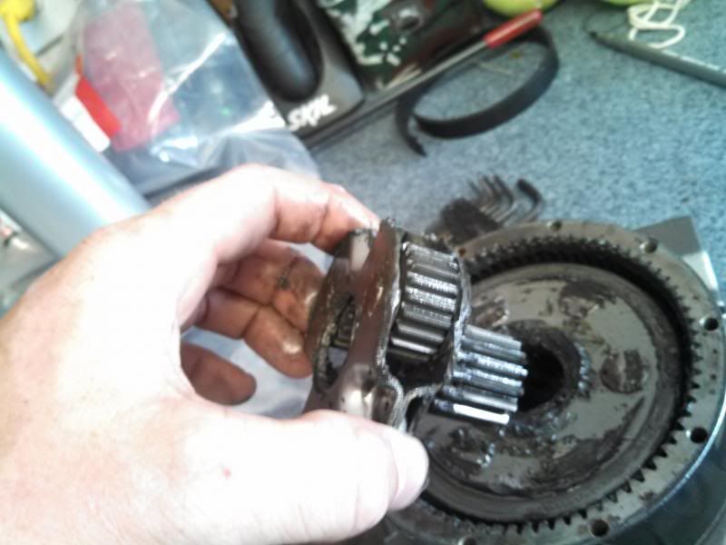

I started to service the winch I bought on CL. I got all of the planetary gears removed, cleaned with purple power and a few cans of brake cleaner. No rust! Then regreased and re assmbled. I have to wait on a gasket though, it didnt make it through. The Warn customer service said I had a 90% chance of being able to reuse it... well I guess im the 10%. Here are some pics.
Cracking it open
1st set of gears
Thrust bushing
2nd set of gears
I didnt take a picture of the 3rd set of gears, but they were behind the second set. Here is the sliding ring gear. Notice the grooved side faces toward the winch drum. It must go back in that way.

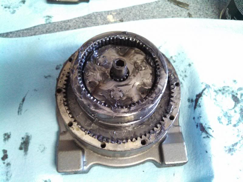

All cleaned up!
Greased and re-assembled (minus the other side of the housing)

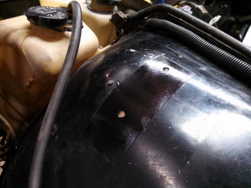

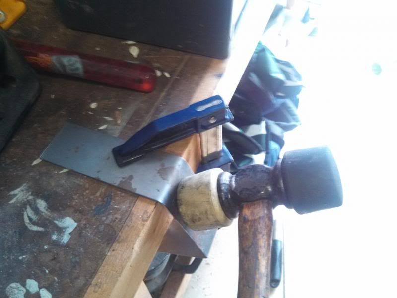

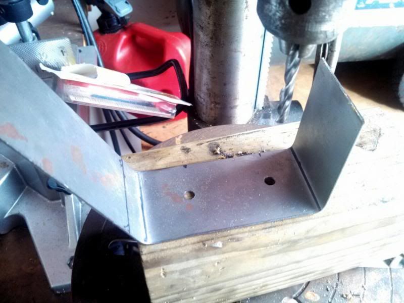

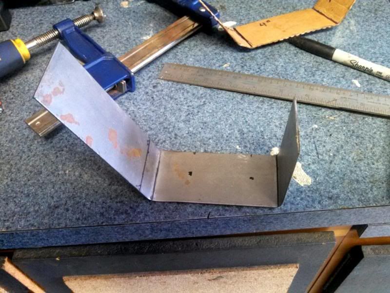

In preparation for the winch mount coming on Wednesday, I made the decision to relocate the soleniod box.
Once I decided on the location I used a pizza box from last night for the mount template.
I know you like my home made break
Ready for some holes
Drill press makes life alot easier
Welded it up. Go ahead flame away for the booger welds, but I dont think many people can do much better with what im working with and no auto darkening helmet (see next pic). Nothing a grinder wont fix though.
and yes those sticks are probably over 10yrs old

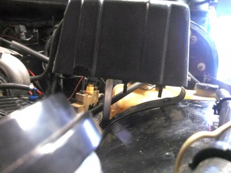

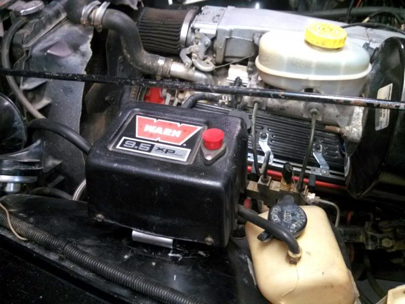

Test fitting it... Like a glove!

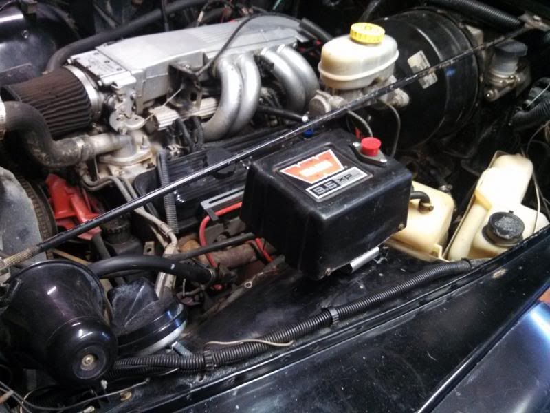

More pics from test fit. Im happy with the results.
...and more
After the test fit I taped off the contact area and put a couple of coats of primer down then put down a couple layers of Plastidip. Hopefully this should be effective corrosion control on the mated surfaces.
Layed a couple of coats of primer and Sprayed a few coats of the left over wheel paint I had from painting the winch. It looks silver because of the lighting, but its really gunmetal. Going to let it cure over night and mount it up tomorrow. I will need to measure all my 2AWG wire leangths to wire it up. Ill wait until I know what im working with when the mount comes in.... man im getting antsy.

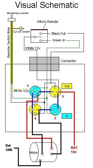

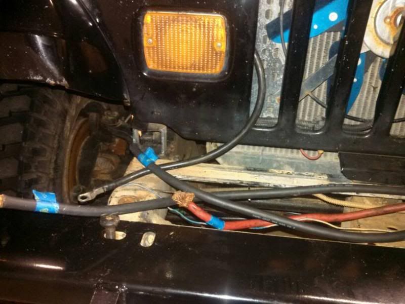

Update for the evening.

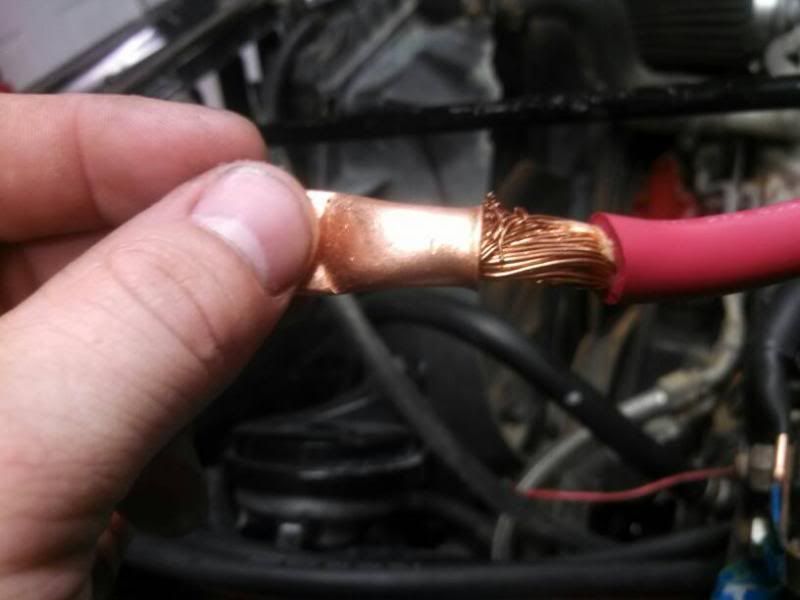

1) I guess all wire gauge is not created equal. I bought some black 2 gauge wire from Orielie's and lugs for 2 gauge wire. They only had 12 feet and I needed another 7 more. So I went to Napa and bought 7 feet of red 2 gauge wire for my power lead to solenoid box. It was over $4/ft at Napa (spit your drink out now). Well you get what you pay for. The lugs fit perfectly over the Orielie's 2ga, but not happening on the Napa wire. They are both marked 2ga but I'm going to need 0ga lugs for the Napa wire.
2) In the wiring diagram it says the wire that comes out of the female pigtail on the controller box is supposed to go to the motor ground (the bottom post on the winch motor) . I will have a 2 gauge ground wire going to that post already but I really don't feel that the controller ground must go to that post. I feel like it can go to any chassis ground. A ground is a ground no matter where you ground it right? Does anyone know if it's absolutely necessary that I run it to the winch motor ground? I would rather not cut splice and extend that wire when I have plenty of places to ground it on the fender. What do you guys think?
3) Post F1 is the only post that gets a positive signal correct? From the wiring diagrams I have found online has it as the only red wire running to the winch. I color coded my wires that way, but I'm just curious.
4) going to wait for the winch mount tomorrow to cut and lug the ends. Also waiting to determine if I'm going to rout them through the grill slats or under them.
YJ 350TPI NV4500 HPD60 14BFF ARB Chromo's
March 2017 YJOTM
87TPIYJ is offline
post #29 of 211 Old 06-13-2013, 10:39 AM Thread Starter
87TPIYJ
87TPIYJ's Avatar
1987 YJ Wrangler
Location: Jacksonville
Posts: 1,563
Here are some schematics i was looking at.
I know this is a 3 wire set up but do you see what I mean by only 1 red wire going to the winch? Is that the only + wire??
[/URL]
This is the correct schematic for my winch
[/URL]
Now I know this is not the same winch but it gives you a better visual picture... Does that Black wire comin from the controller HAVE to go to motor ground or can it go to any ground?????
[/URL]

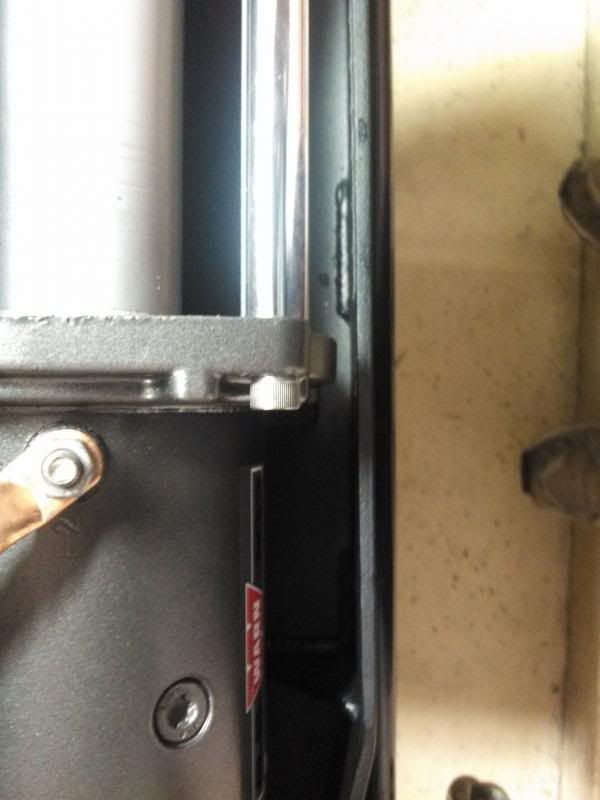

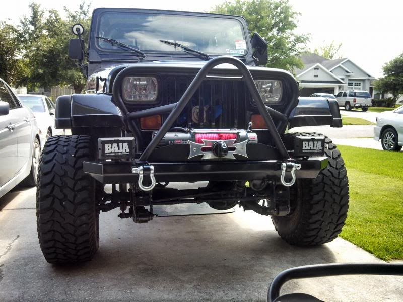

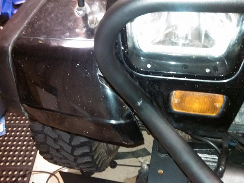

Well I might as well call this winch/bumper install "Murphys law install."
The first issue I ran into was warriors winch mounting holes I noticed the minute I bolted up the fairlead.
I mounted the winch in hopes there may be enough room. There wasnt even enough to put the nut on the back. So to correct that problem I re drilled all 4 holes 3/4" closer to the grill.

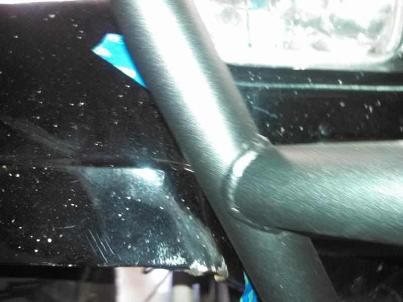

Issue #2 when I went to install the stinger the hood loop hit my fenders b/c my 2" body lift.
So I busted out the jig saw and angle grinder.
#3 Because I ordered the stronger thimble on my rope. My hook would not fit on it. So I splurged and got the Factor 55 prolink loaded.
#4 Due to the amazingly contradicting information on the web about spooling a synthetic line i just spooled my winch using hand tension. So of course on the first pull the outer wraps where digging into the lower wraps.
#5 Today I wrapped it neat using the ebrake as tension to pull my jeep in. It wrapped nice, but I noticed some fibers on the bottom of my fairlead. I dont like that. I wasnt paying attention when it first started wrapping, but towards then end it was absolutly pulling down on the bottom of the fairlead causing it to rub and making it a PITA to get the protective sleeve to spool in with the line. I feel like the fairlead should be mounted lower (would require drilling new holes again, and grinding out the opening more on the mount! )
