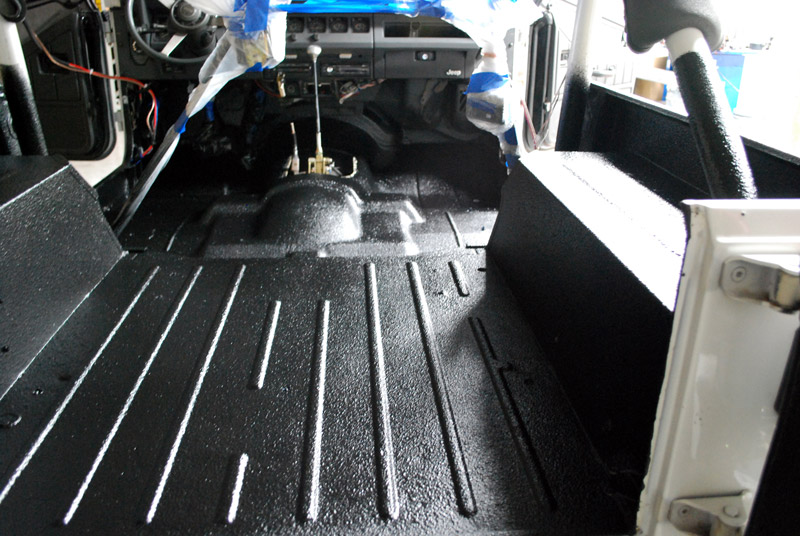

Hey Magnetman here are a couple of pics of mine done in white. They were taken with my cell phone so they could be better

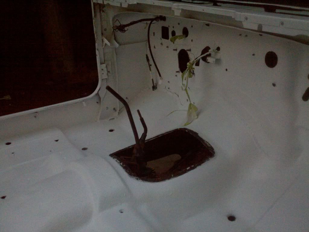

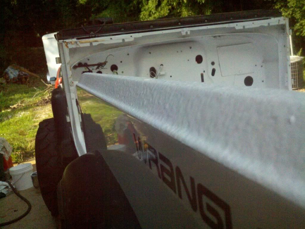

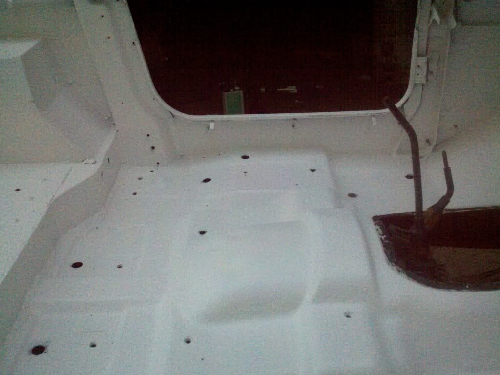

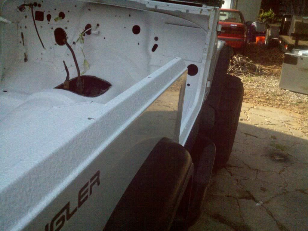

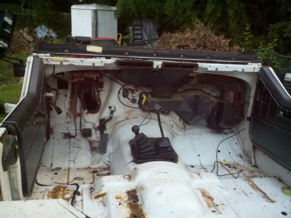

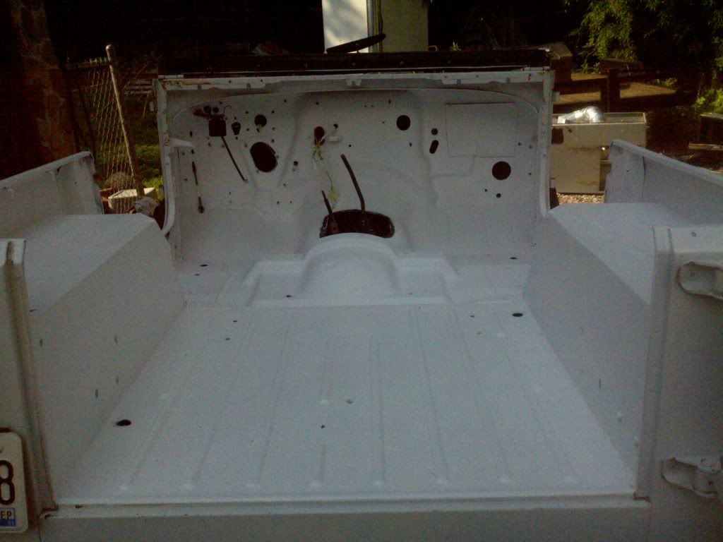

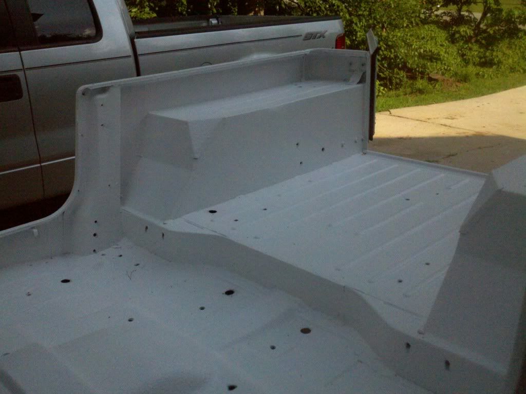

after and before. rolled on.
IMG_1000000306.JPG   IMG_1000000307.JPG   IMG_1000000308.JPG   IMG_1000000302.jpg   IMG_1000000301.jpg
