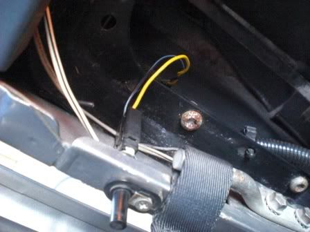

I do not have an owners manual with my 93 YJ. Can anyone tell me if there is a cut off switch for the interior lights when you leave the doors off?

should be able to pull the wires off the back of the door switches

x2. Pull the connectors from the plunger-type switches in the doorjambs.

pull the black & yellow wire from the switches in the door, and they won't turn on when the doors are off.
