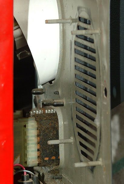

I'm a giant noob... How are the bolts not showing on the front of the dash?? Very stupid question I'm guessing if they are mounting bolts that come standard in your rig, my 92 does not have them. Going to have to do some drilling

All 3 of my YJs had factory mounting bolts for the speakers that were attached to the rear of the dash. Maybe the PO of your jeep broke them off? If they aren't there you're going to have to do some drilling.

doesn't look like they were ever there. Oh well, I don't mind a few bolt heads showing. thanks for the response!

Here's what the back of my dash looks like.

yep, mines the exact same other than the "studs" for the speakers. I just drilled holes in the dash, works just fine! Not quite as pretty, I'll admit, but Oh well!
