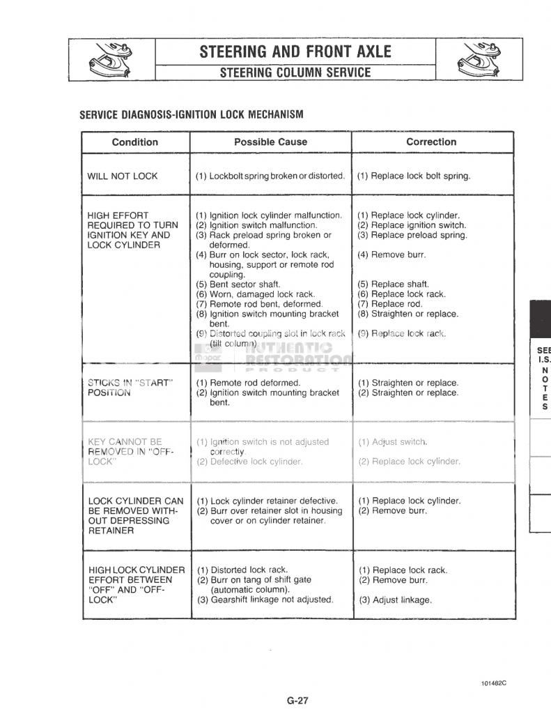

post #15 of 22 Old 11-14-2012, 10:47 AM
Rproject
1987 YJ Wrangler
Location: Sandwich, IL
Posts: 2,759
Originally Posted by ROTTEN View Post
Also yes to the key question.
OK, if your key turns freely back to accessory and forward to run, but has bind to the start position, the cylinder is not your problem. The issue is in the column.
Here's the page from the factory shop manual describing potential problems and solutions CLOSE to your issue.
