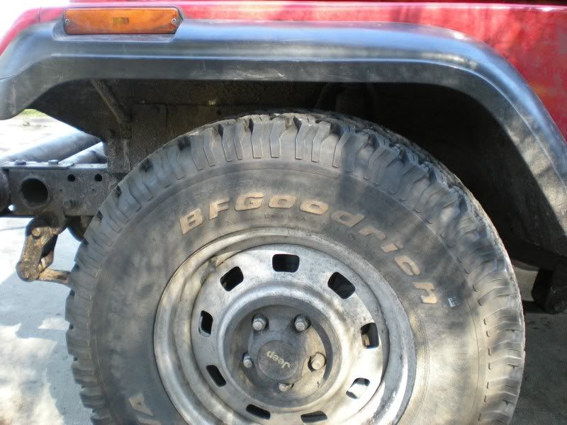

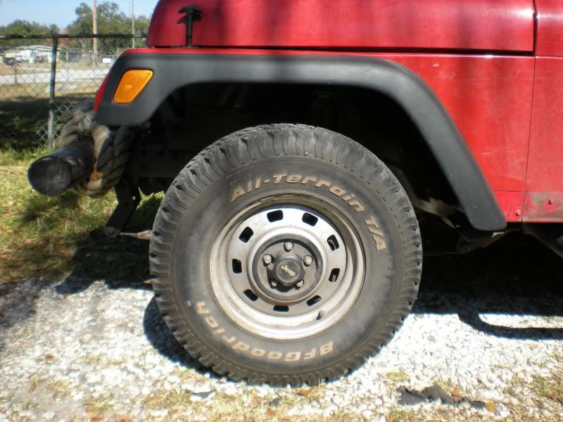

Originally Posted by YJake View Post
I didn't really "make it" but I did do the TJ Flare mod.
Before.
After
Can check my other mods on the build page linked in my Sig.
what does this mod involve?

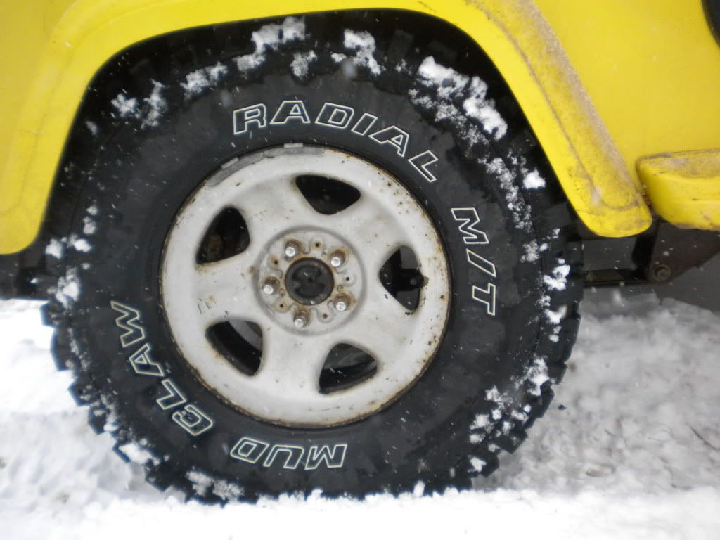

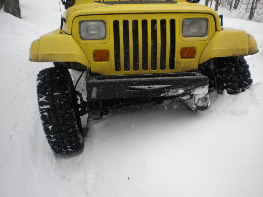

I made a new front bumper for my heep last week... 5/16 angle the width of the frame rails, plates in center are half moon shaped. Angle was cut so that plates could slide through and have weld on both sides. I beveled the plate and made 3 passes on every seam with my 110 wire welder. First test was a high lift under the plates. I lifted the jeep off of the ground 3 inches without any change in the bumpers shape. Bumper is welded to frame with a couple gussets on the bottom.
I like it more and more every day!
CONTACT!!!!!!!!!!!!!!!!!!! Time to do a little cutting...
