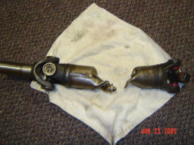

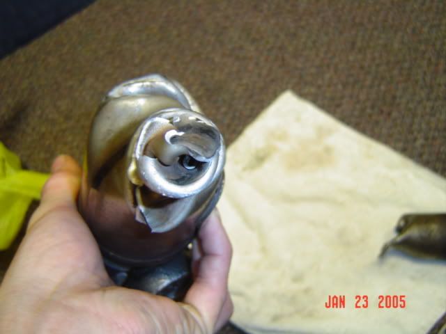

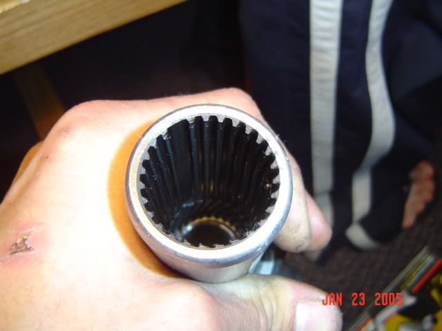

Check the slip yoke. I twisted one once. Did a burnout on the street with my new bfg at's, and they had a lot more traction than my old trail ta's. Started getting a roaring in my drivetrain with lots of vibes. Checked it out and one of my u-joints was blown. I put in a new u-joint and a while later saw a wet patch of pavement which seemed like an open invitation for a lot of gas off the line at a stoplight. Well the tires didnt spin, and the driveshaft poped...err i mean twisted up like an ice cream cone. Further inspection revealed that i twisted the yoke with the first burnout, and then when the jeep squated down on the second burnout it compressed the driveshaft and colapsed it. Word of advice, that stupid set of 31" bfg's at's had too mcuh traction on the street.

BudmanV6 that's who. if he wants to ruin his tires and blow driveshafts, who are we to judge. my only question is was it fun? if so eff it it's not your bank account and huge infected looking cut on the back of your hand.
